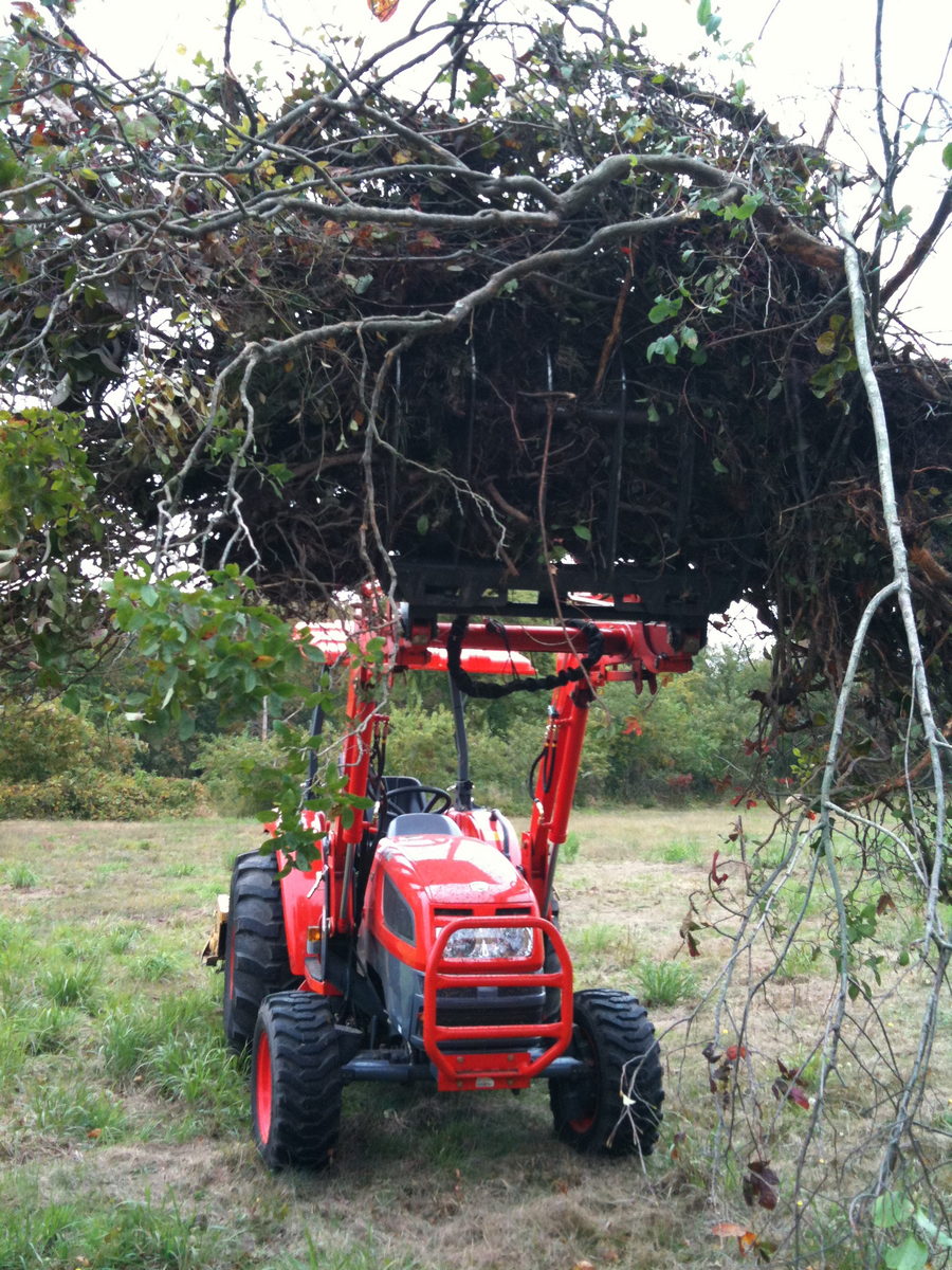

I got a new 48 incher, they were asking $895 for. I like the narrow size as I can reach between stuff to grab stuff. Remember it has no sides, so on a grapple width isn't as important.. I can, and have, picked up a 15 foot log with mine.
Look around there are plenty less expensive ones out there! I found mine on Craigs list here in South Carolina.

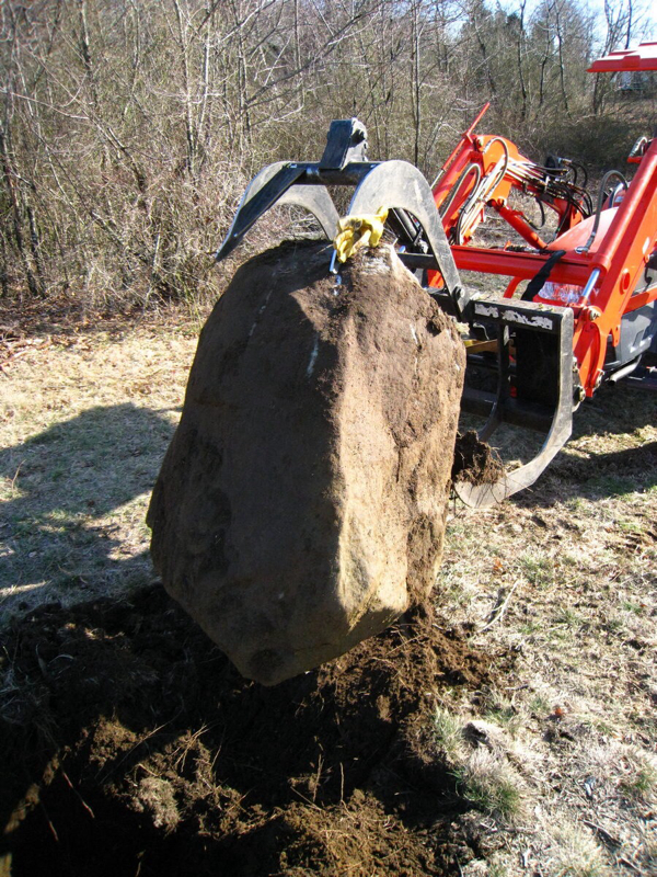

How about these examples to show that a grapple can manage big
single rocks and tree trunks. As far as standing 4" tree trunks, just knock'em over, stick the grapple
underneath and pop'em out. Which of these tasks can be done with a 4n1???
If you reread what I wrote, you will see that I said "2-jaw grapple bkt". Yours is one jaw, which allows
you to lift at capacity from the center. Here is a 2-jaw bkt add-on.
GP

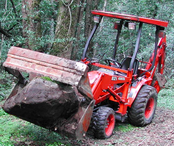

In clearing small trees with a 4n1, I open the bkt next to the sapling and lower it while turning the
wheel. This pushes the sapling over and then you close the clamshell on the trunk. Lift, curl, push,
and/or pull and it is out. No need to dig it up.
