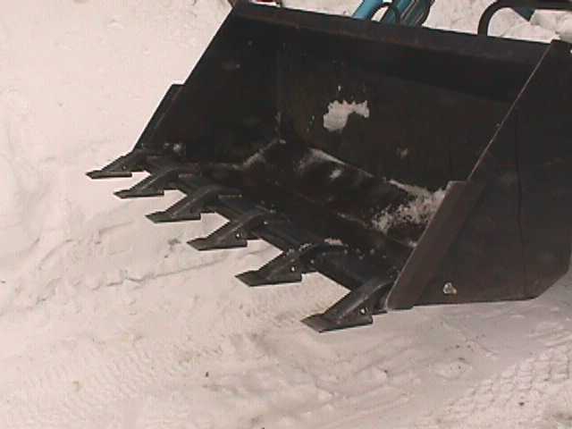

I said I'd make the tooth bar when I found a loose couple of hours:
Well, yesterday gave me a couple hrs.
Good estimate as two hrs did it!
Overall pic of bar installed.

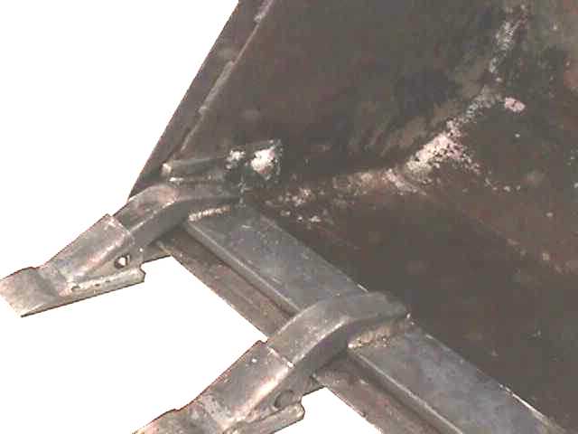

Close up.
If I did it again, I'd order the 1s7-8-23 adapters as they would accomodate 3/8 X 3" bar. (.93" 'grip')
Rather than using a 1/2" bar. (used 1.06" 'grip').
Reason being that the 1/2 is so 'stiff' that installing over the slightly 'warped' bucket edge (with nicks etc) became difficult and required a fair bit of shaping with a 10 lb sledge so that it would 'comply'.
With 3/8 bar I believe I could have simply tapped it into place.
I tried it to chew into frozen snow banks along my drive and WOW does it do a number. Really 'digs in' while without I could barely get a bucketfull of frozen compacted snow/ice.
Cant wait to dig in real earth.
