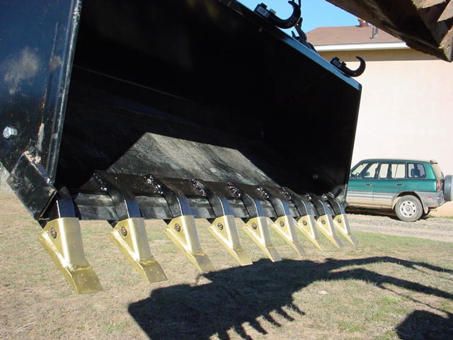

Yes I agree - The 3/8" x 2-1/2" COLD rolled is what I used on my 9 tooth "Gold Teeth" bar. You would not believe the difference in the quality and hardness of cold rolled steel vs the hot rolled stuff. Also about 2wice the cost though.
Glad to hear that the teeth dig into the Icebergs - All I got now is MUD - snow is finally starting to melt. Here in the Sandia Mountains of New Mexico.
