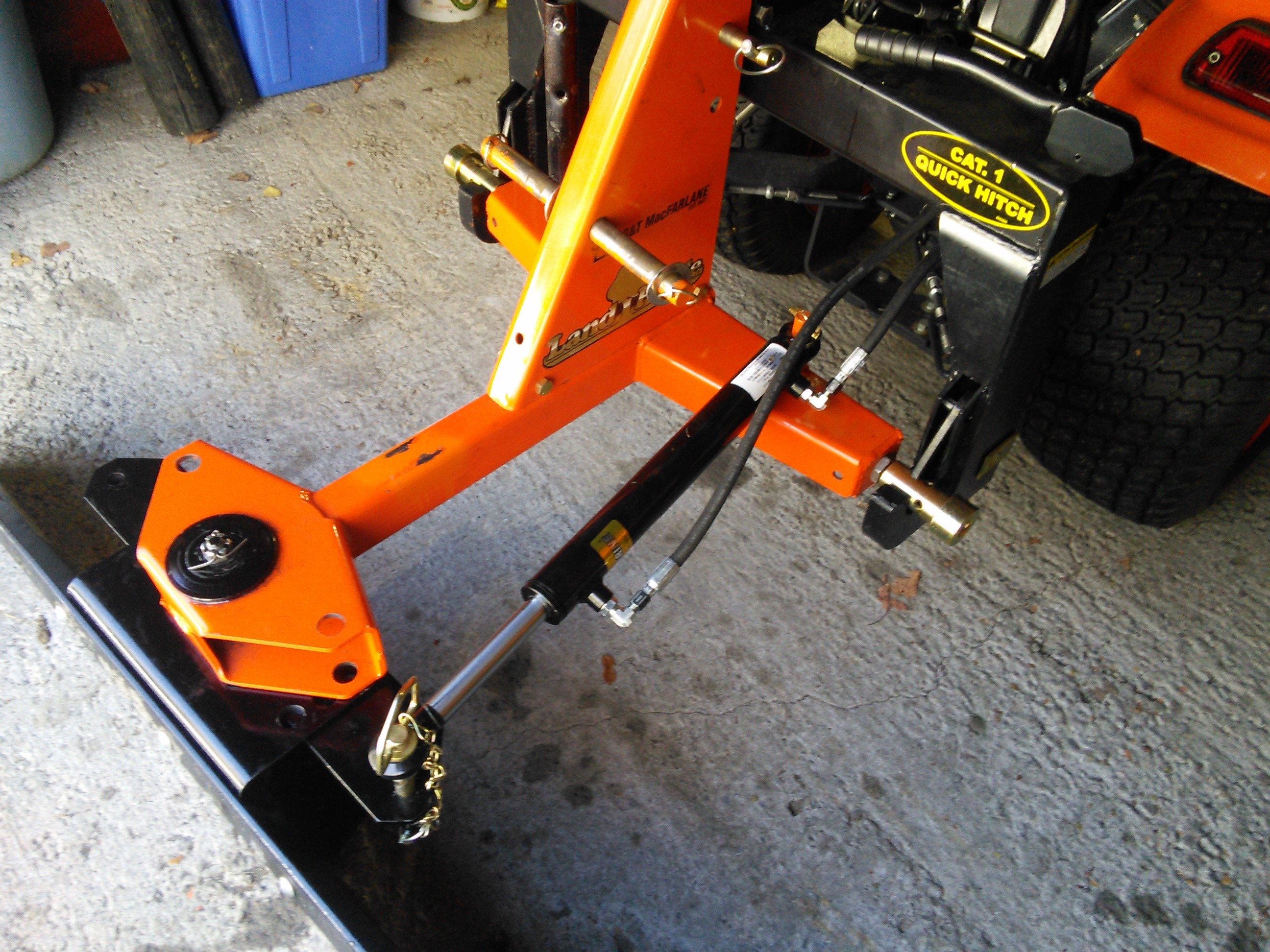

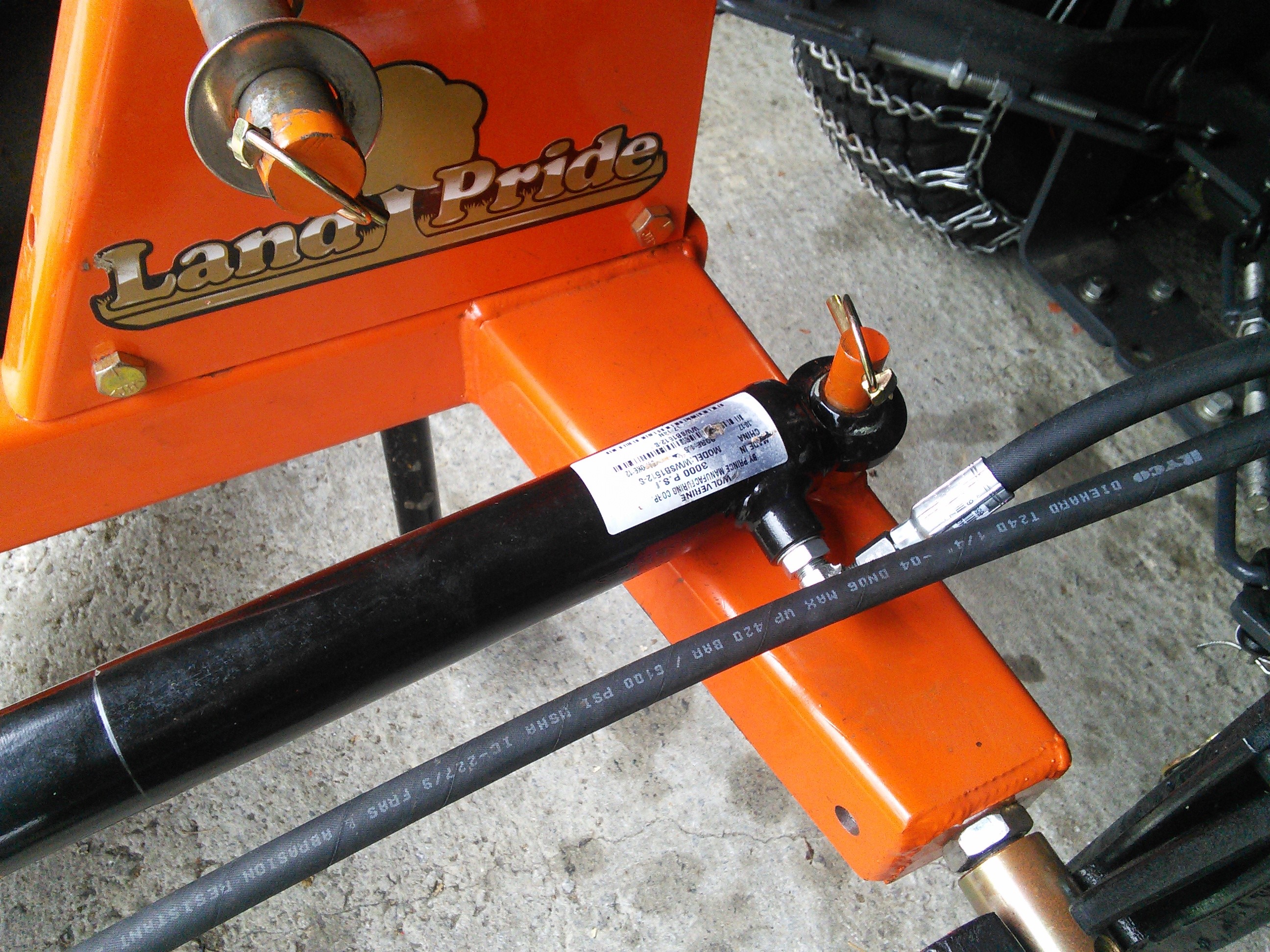

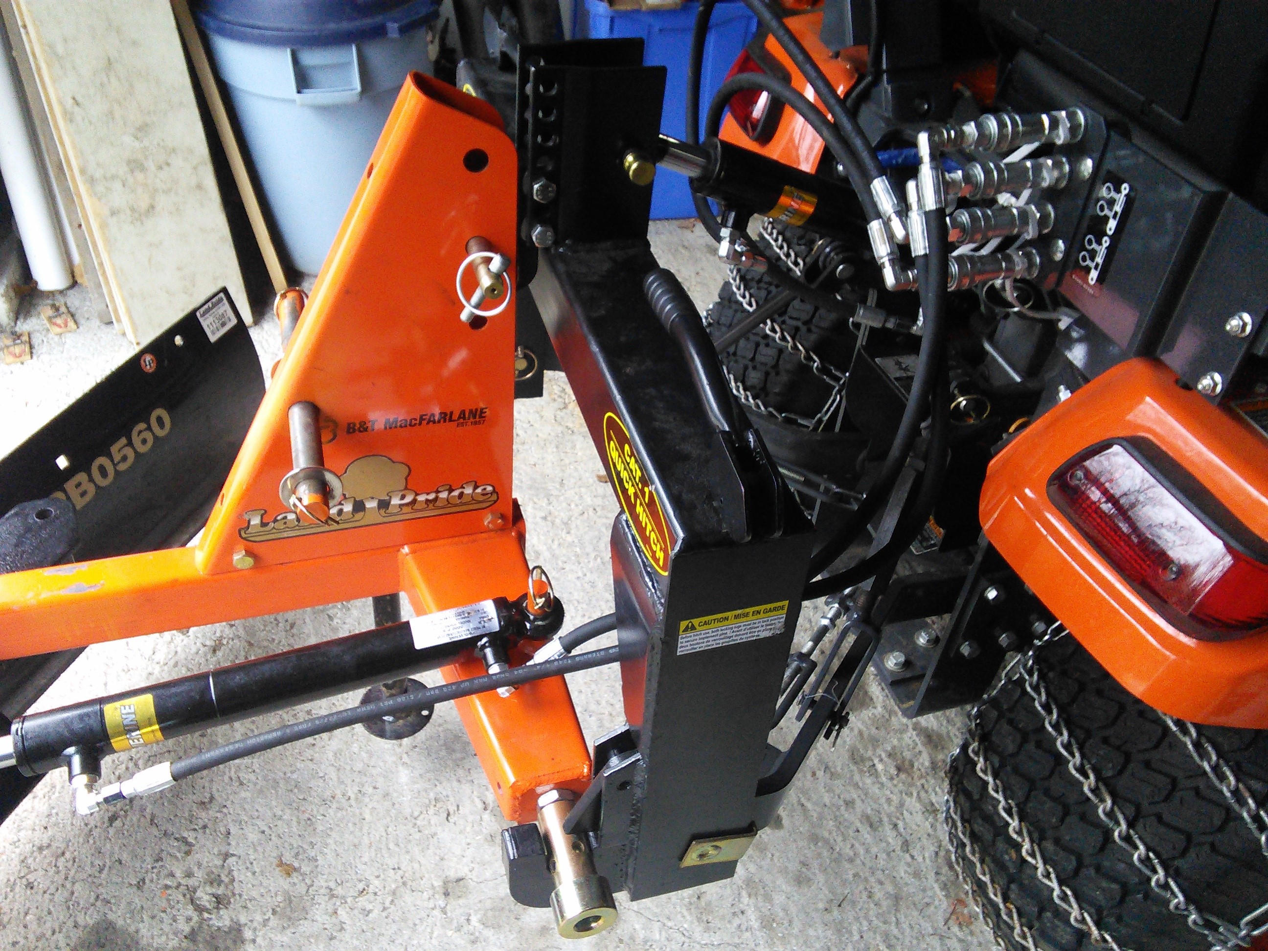

I own a BX2380 with an RB0560 rear blade. I recently added hydraulic capability to the rear blade. I already had a set of rear remotes. One used for hydraulic top link and the other is used for the hydraulic capability on the rear blade now.
The hydraulic cylinder is a Wolverine 1.5 inch x 12 in. Swivel end (Surplus Center carries them). 3/4 inch holes in the swivel ends.
Too change direction of plowing you remove the large linch pin, rotate blade by hand and reattach on other side.
The 3/4 inch holes in the 4x9 plate line up with the center line of the plow rotating hub.

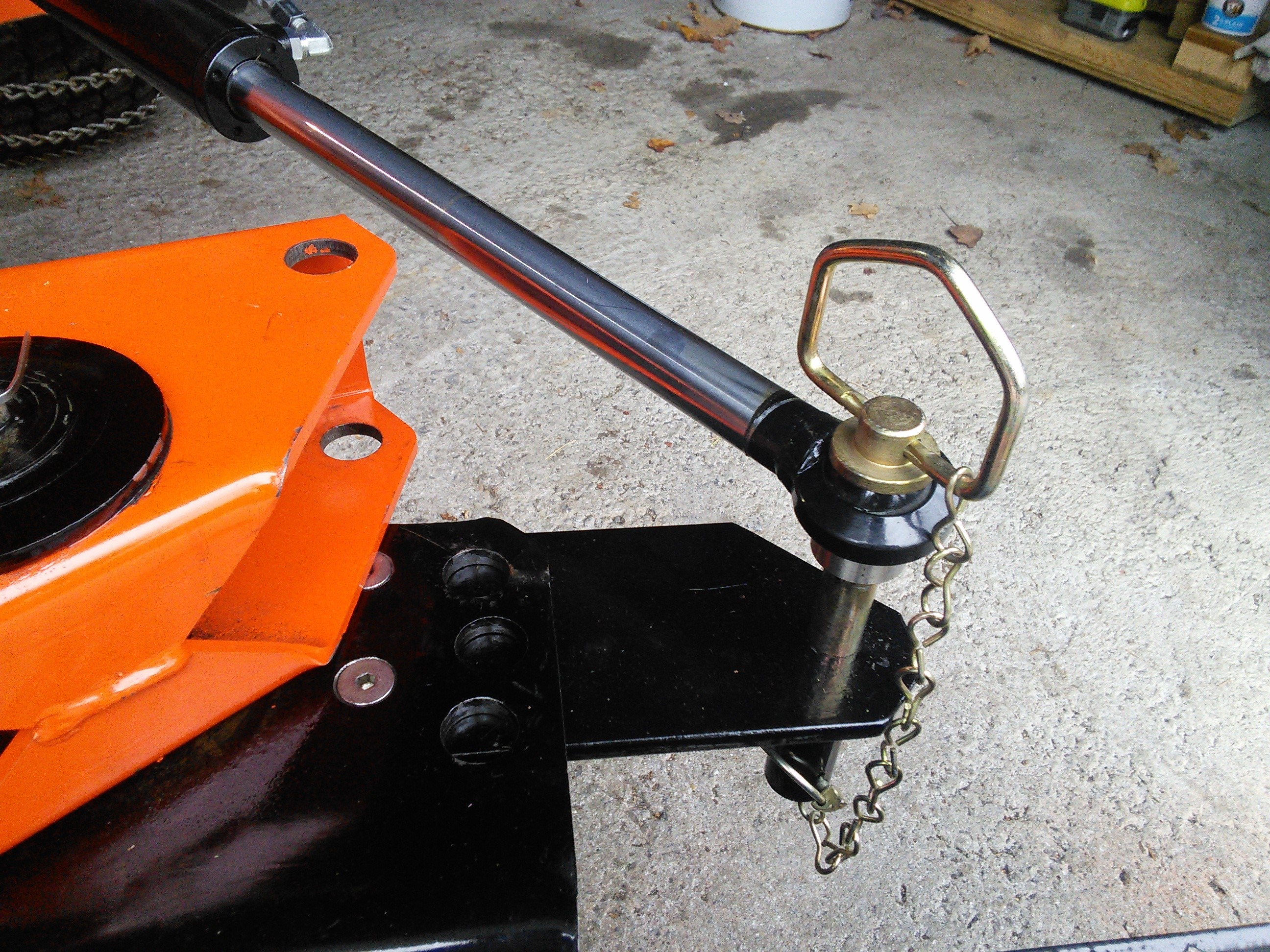

1 Welded 3/4 inch rod with 1/4 inch hole at top for linch pin at tractor end of plow frame for one end of the cylinder.
2. Added two plates 4x9.5 x 3/8 to plow end of frame. Plates have two holes to attach to the plow frame, Plow frame has two holes drilled (countersunk) on each side to line up with plate holes. Plates had a 3/4 inch driller hole with a 1 inch OD x 3/4 inch ID x 3 inch tube welded to line up with 3/4 inch hole. 1/4 inch hole in tube at bottom for 1/4 inch linch pin.
3 Attached other end of cylindar to hole in plate with large 3/4 inch linch pin. Also has collet to hold cylinder end a couple of inch from plate.
My routing of the hydraulic lines has to be changed. They get squished when I raise the 3 pt hitch.

One more picture to show the whole setup.

Cost
1 Pair of rear remotes from Kubota installed $850 Can Should be alot less in in US dollars and in the USA
2 2 plates 4x9.5, 1 3/4 x 3 inch rod, 2 hollow rod 1OD x 3/4ID x 3 inch long $20 from Metal Supermarket
3 Misc Nuts bolts and linch pins $20
4 Hydraulic lines two $50
5 Hydraulic cylindar $285 Can Available from Surplus Centre for $120 US plus shipping and taxes

That will make your blade much handier to use.
I do have one question, on the rear cylinder pin how is that secured,
is there a double yoke that is not visible or a welded pin?
There can be considerable force applied to it.
/ Budget angling for B2672 #8
The end of the cylinder that is closest to the tractor goes into a 3/4 inch pin that has been welded to the frame of the plow support. What I forgot to mention is that the 3/4 inch pin is made from a 1.25 inch rod about 3 inches long. I turned it down on a lathe so 2.75 inches is 3/4 inches in diameter and the bottom is still 1.25 inches in diameter. The 1.25 inch diameter section is the end welded to the plow support. As you say I was concerned about forces on the pin so I made the welded end a little stronger.
