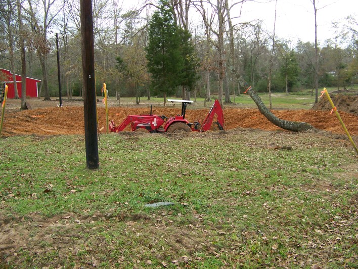

Pic of Bota below water level. Nope not stuck and actually havn't been stuck yet. So far most work not in mud. Bota setting in hole for 2nd day of digging with toothbar. Battery died on picture showing hole. Will try again. Rain forcast for tomorrow, may be test trailer work day.

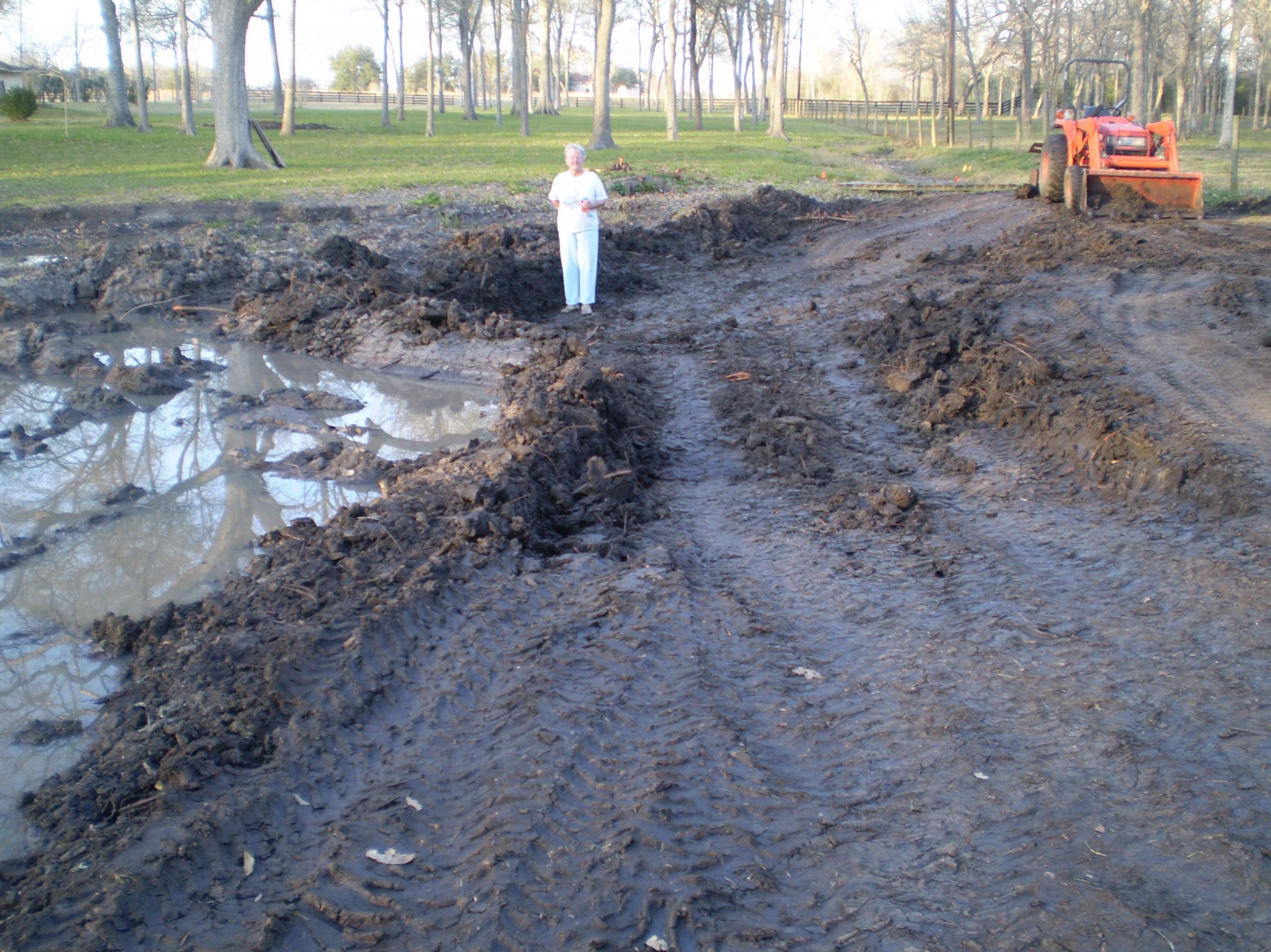

This picture shows results of two days of toothbar digging on East side of pond. At this rate I only have 3 or 4 more days of top soil removal. Then smooth out banks, plant some quick ground cover and figure out how to get piles moved to low spots around the ranch. That's the Bar BOB Ranch Head Honcho surveying days work.

In the last picture, I see h poles coming out of the ground. what are those? some sort of a kids play area or something ?
Took me a bit to see what you were talking about. Original plan used pasture cross fence as South boundry. Pond grew and it didn't make sense to keep fence up and limit pond size. So fence down, pond bigger and poles you see are for gate that still needs to be removed.

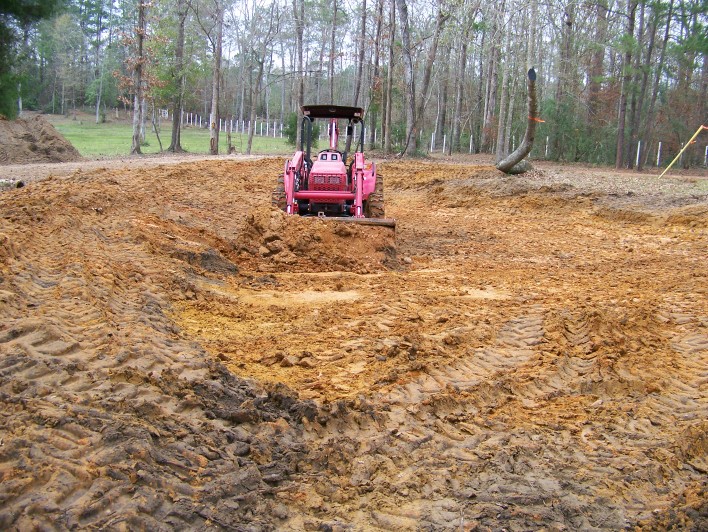

I am glad to see you are doing it yourself. I dug my 40x80 pond with my 65hp 4WD Mahindra and backhoe. http://www.tractorbynet.com/forums/projects/135413-i-finally-started-my-pond-28.html
I didn't dig my topsoil, but dozed it to the edge of the pond (my driveway), then just lifted it over the driveway. After putting in a dam keyway, I dozed clay out of the basin up on the dam to a depth of about 4 feet.
At that depth, I had to switch to the backhoe as it was a little narrow to turn hard in the basin with a 7 foot wide bucket full of clay. Done slowly, you can doze dirt or clay into the bucket, then haul it off. I did all this without a tooth bar at the start of the 2009 dry spell. After 4 feet, I just dug with the backhoe.

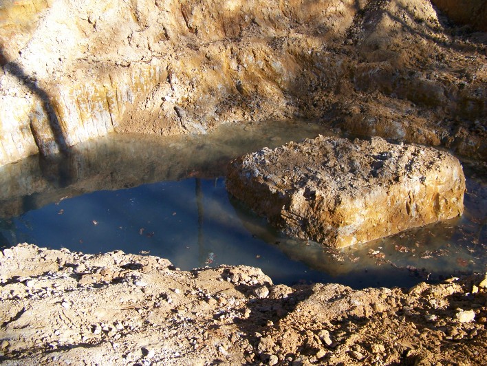

I also, dozed in standing water at a depth of 6 inches only one day. It was real muddy, but that was dozed out of the way quickly. I left a small underwater island like Meadowlarkponds mentioned. It was a fun project, but hauling the dirt, like others mentioned, was the time consumer. I had piled it up across the driveway and I am still trying to find the best place to put the clay spoils. I worked my Big RED Beast hard in this project.

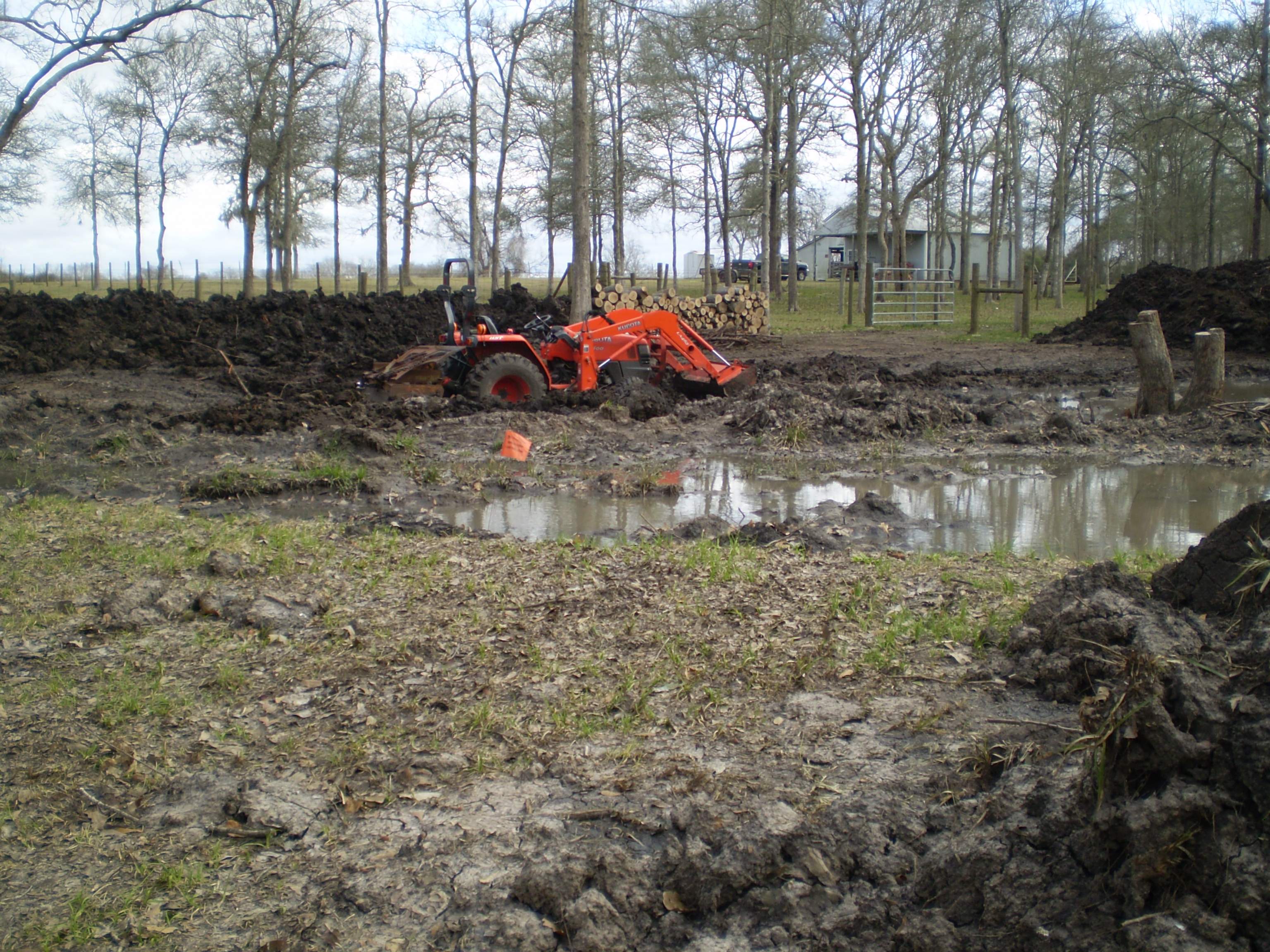

Does a toothbar really help? WOW! YES. I couldn't wait to try it out and finally figured out how to dig with so much water, I was using FEL to slice off chunks at waters edge. Problem with that was muddy spoils and in genaral a big mess. It worked BUT. New method-drop back a few feet and dig behind man made dam. What a difference, damp ground and new toothbar makes for fast work. Pictures represent about two hours work-a lot of which was spent learning how. Axe in middle is for scale. Top of handle is actually below water level behind dam. Also another question answered. Will soil hold water? Pictures answer that.
Do you need a toothbar? If you are digging or moving dirt-YES.
