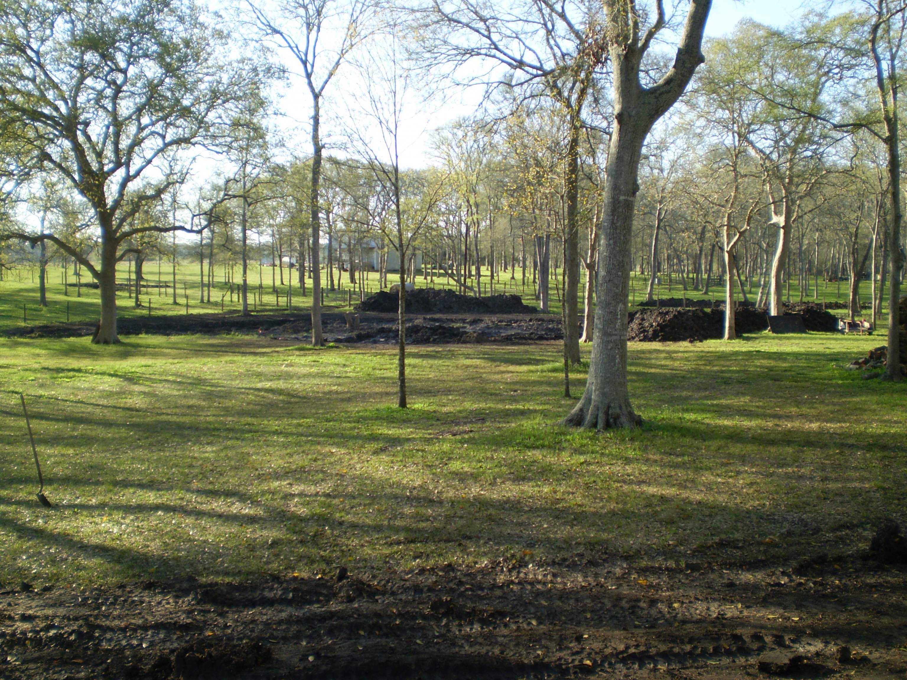

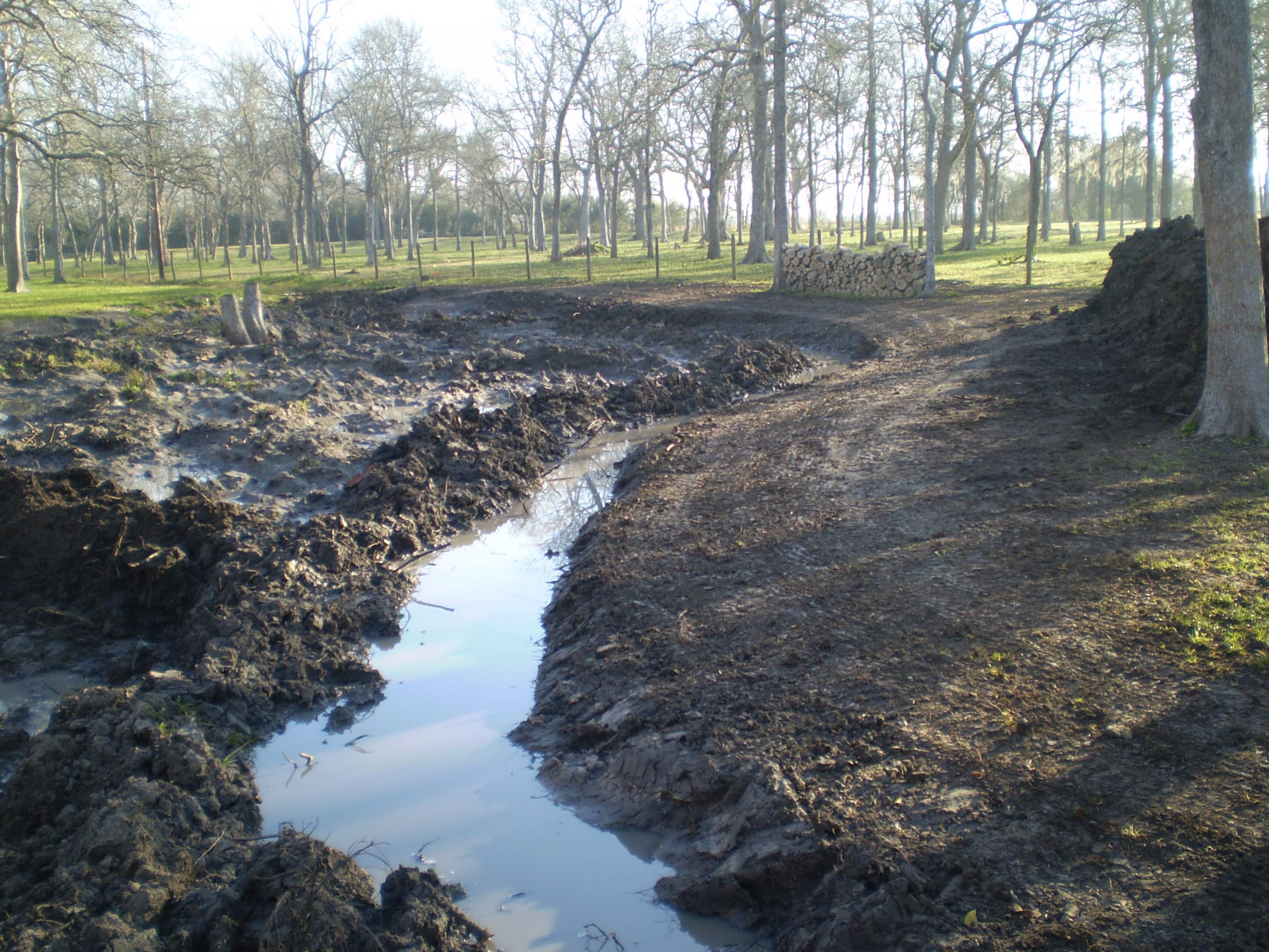

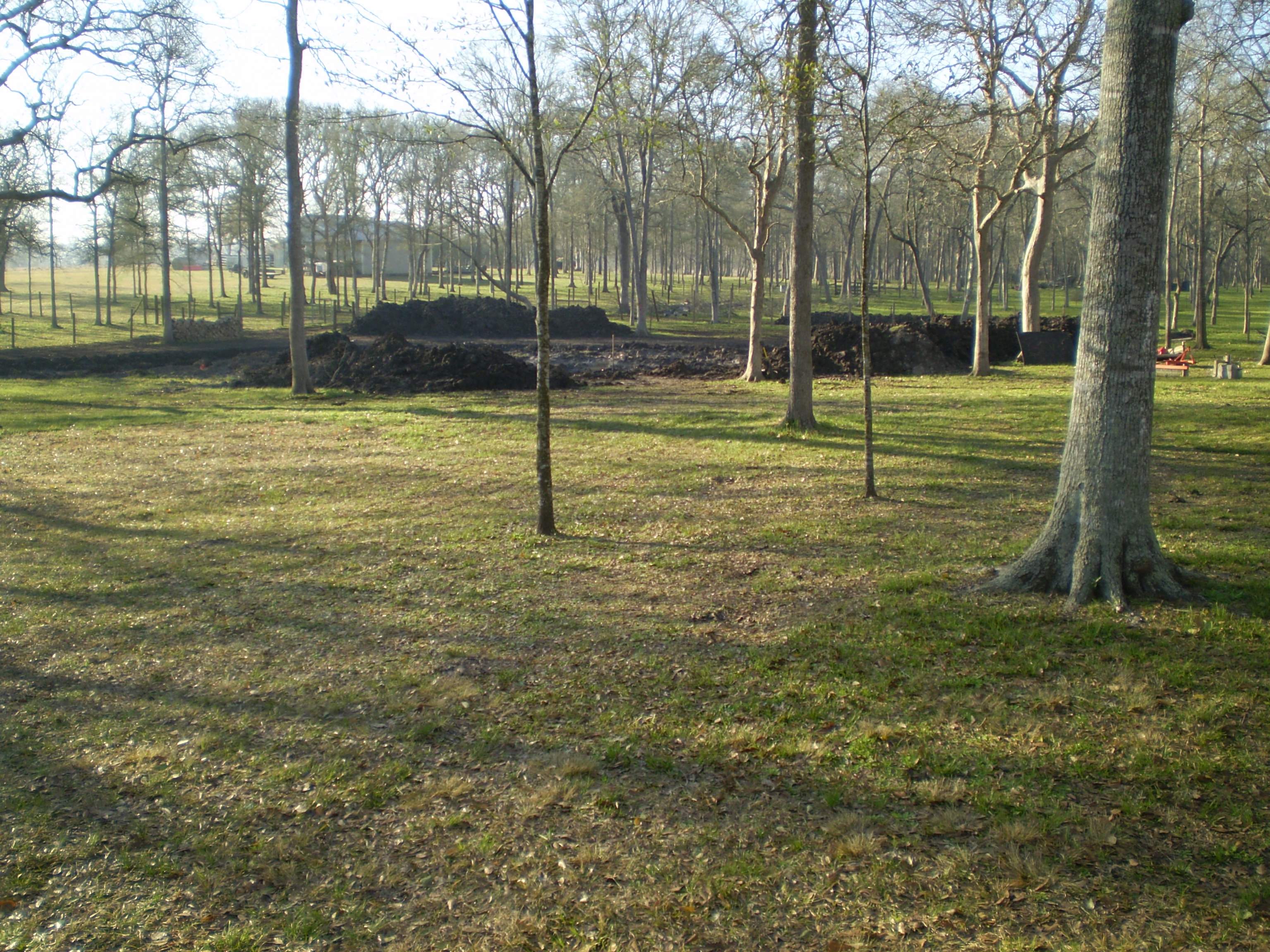

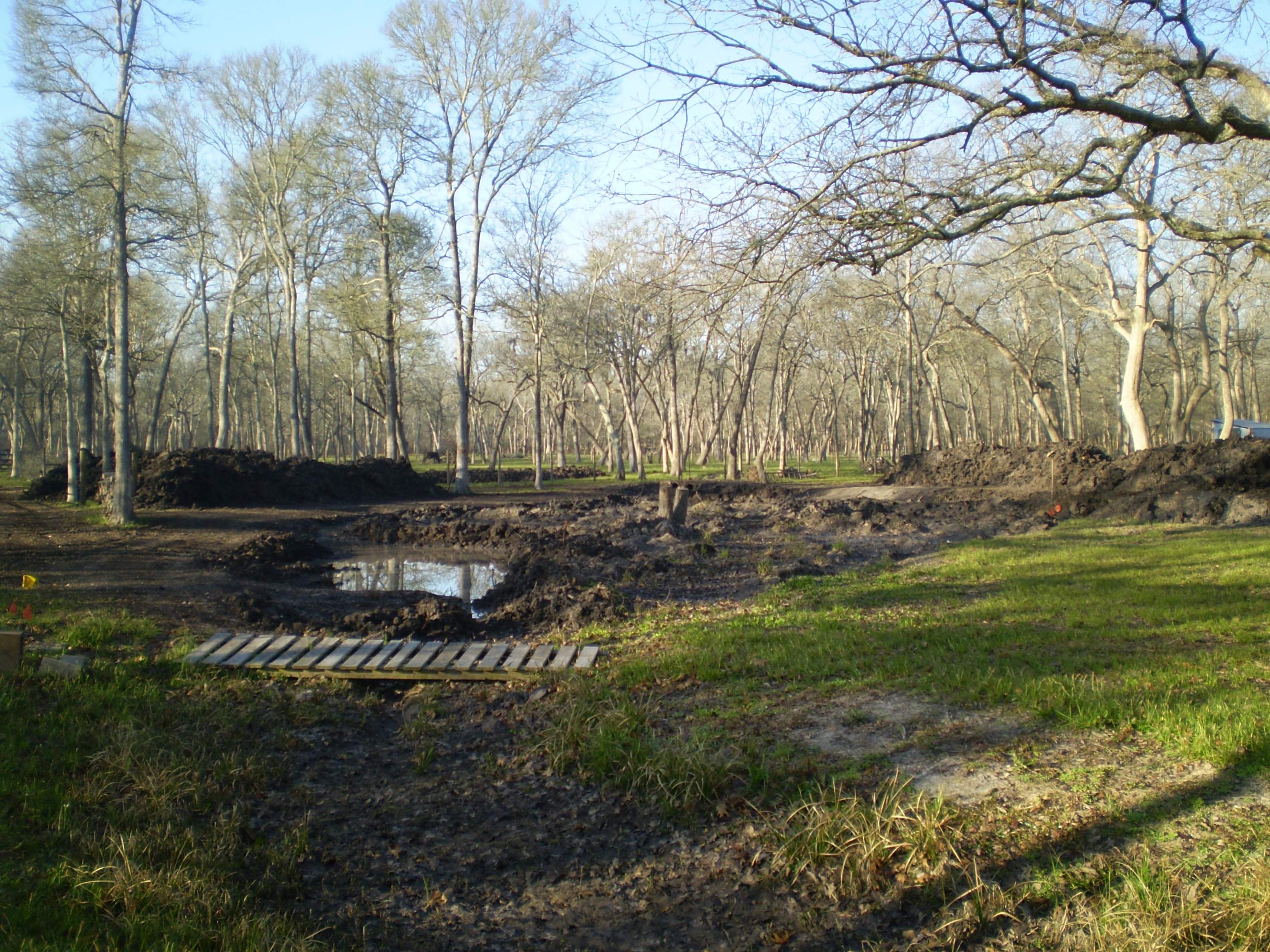

Project status: Topsoil removal done, lots of dirt ready to be moved, waiting for trailer, east side ready for grass, stream diverted to east side. Pic one shows east side of pond ready for buffalo grass planting and maybe a few landscape plants. Also can see temporay new stream bed. I diverted water flow to a narrow channel on the east side. If we don't get a lot of rain the rest of the pond should dry up so I can start working on the bottom. Pic two is just finished west side. Bit hard to see depth untill you see the drive out ramp on the far end. Pic three is whole project viewed from upstream side. Pic four is view from house. Not much to see from house but a lot of dirt. So far this is still fun.
