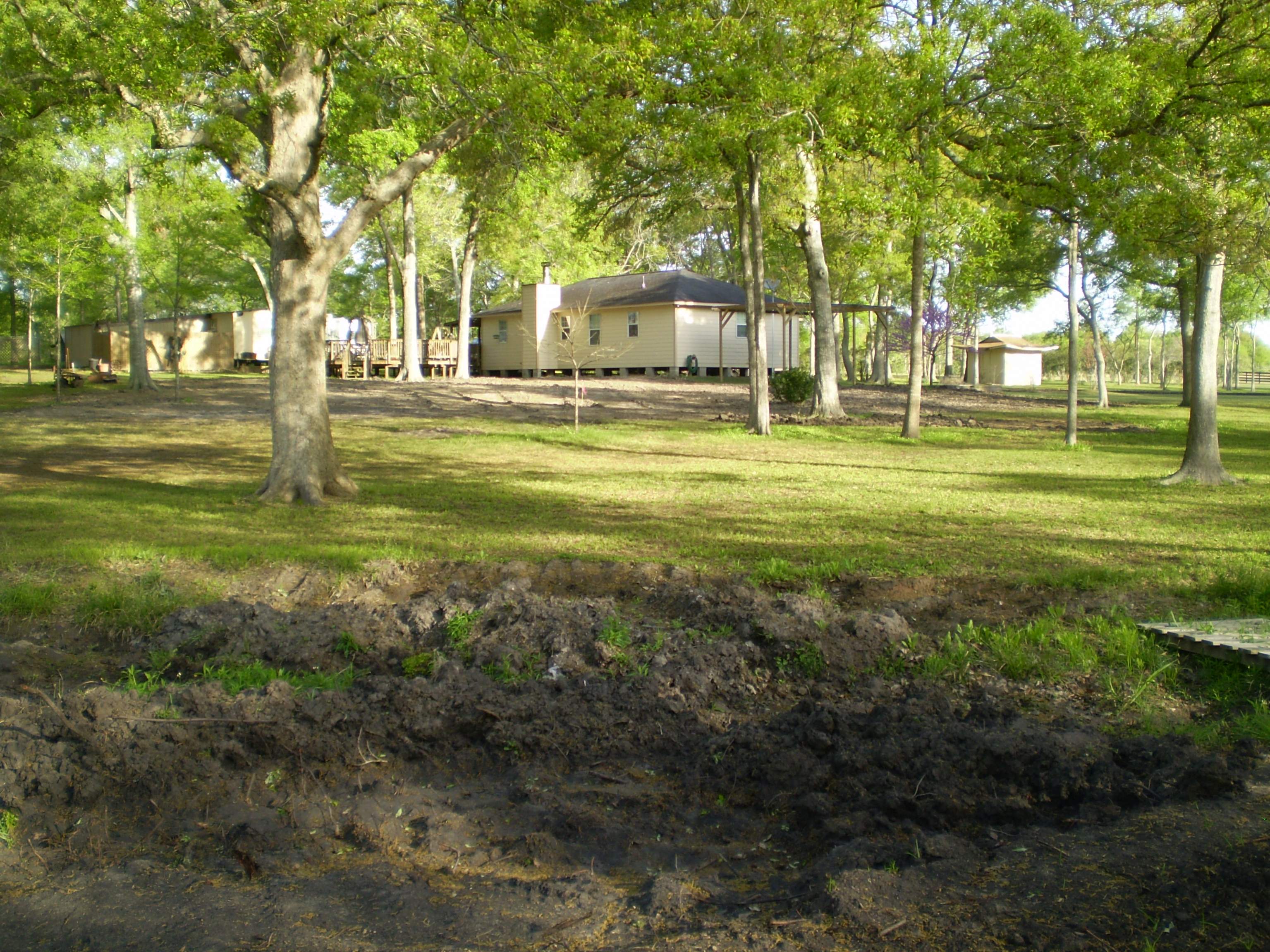

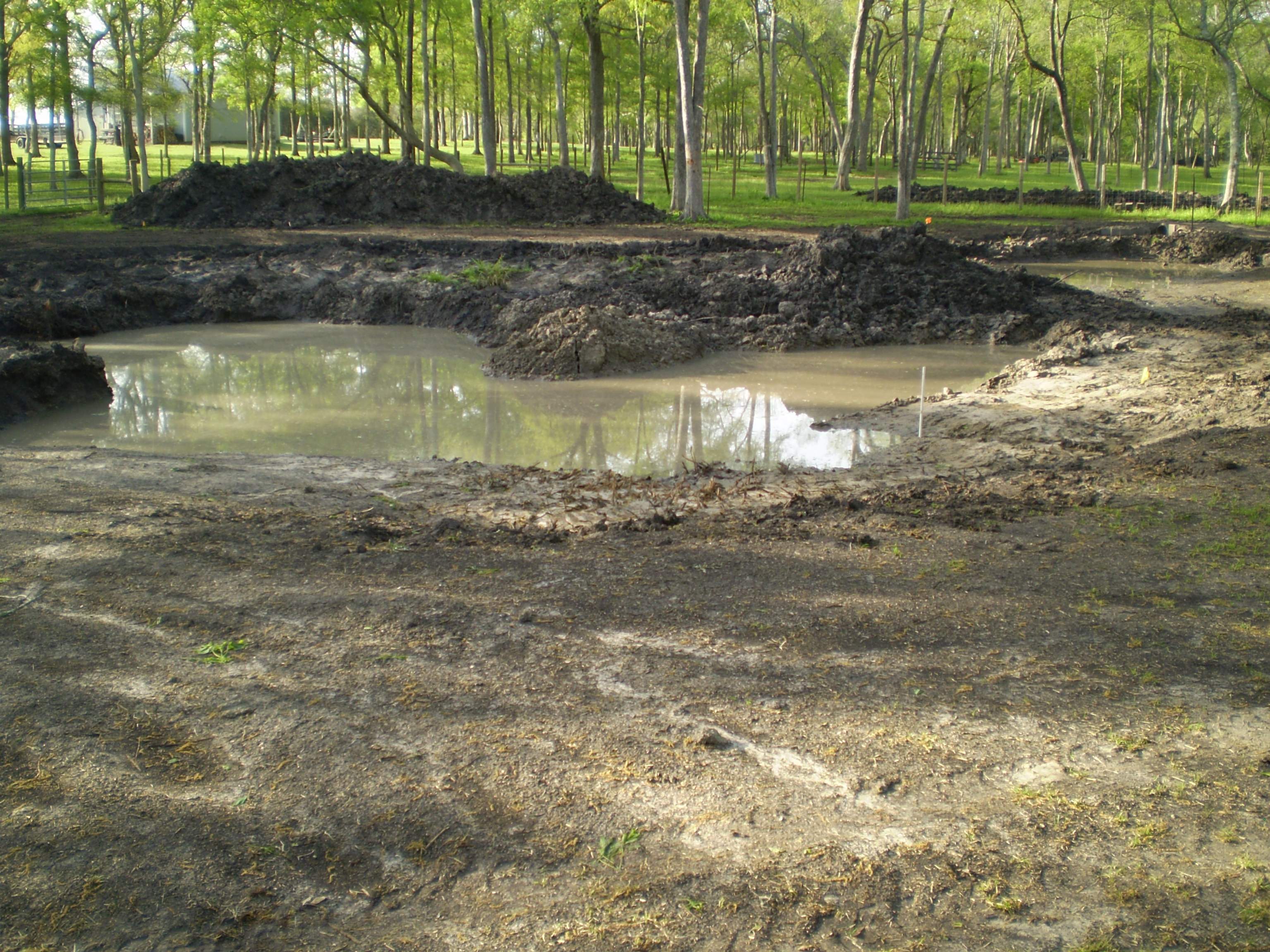

Status report before RV trip.
Will be on the road getting a different kind of seat time for about 45 days.
First picture is water after less than 1/2 inch of rain. I really wasn't expecting it to hold very long as I hit sand around three feet. That's really good news from a digging and spreading standpoint. Just means I'll need to save some of that gumbo to seal the bottom.
Next one is view of dirt spread around back yard. Wasn't really in the plans but that is what I have to look at when we get home. Just couldn't work fast enough to get it ready for grass seed.
Last one is view from edge of pond. For a tinhorn I think I have been doing pretty good at leveling. Still have a lot to learn. Now I really understand the use/need of wheels on BB.

It looks like you will have no trouble holding water in that pond.:thumbsup:

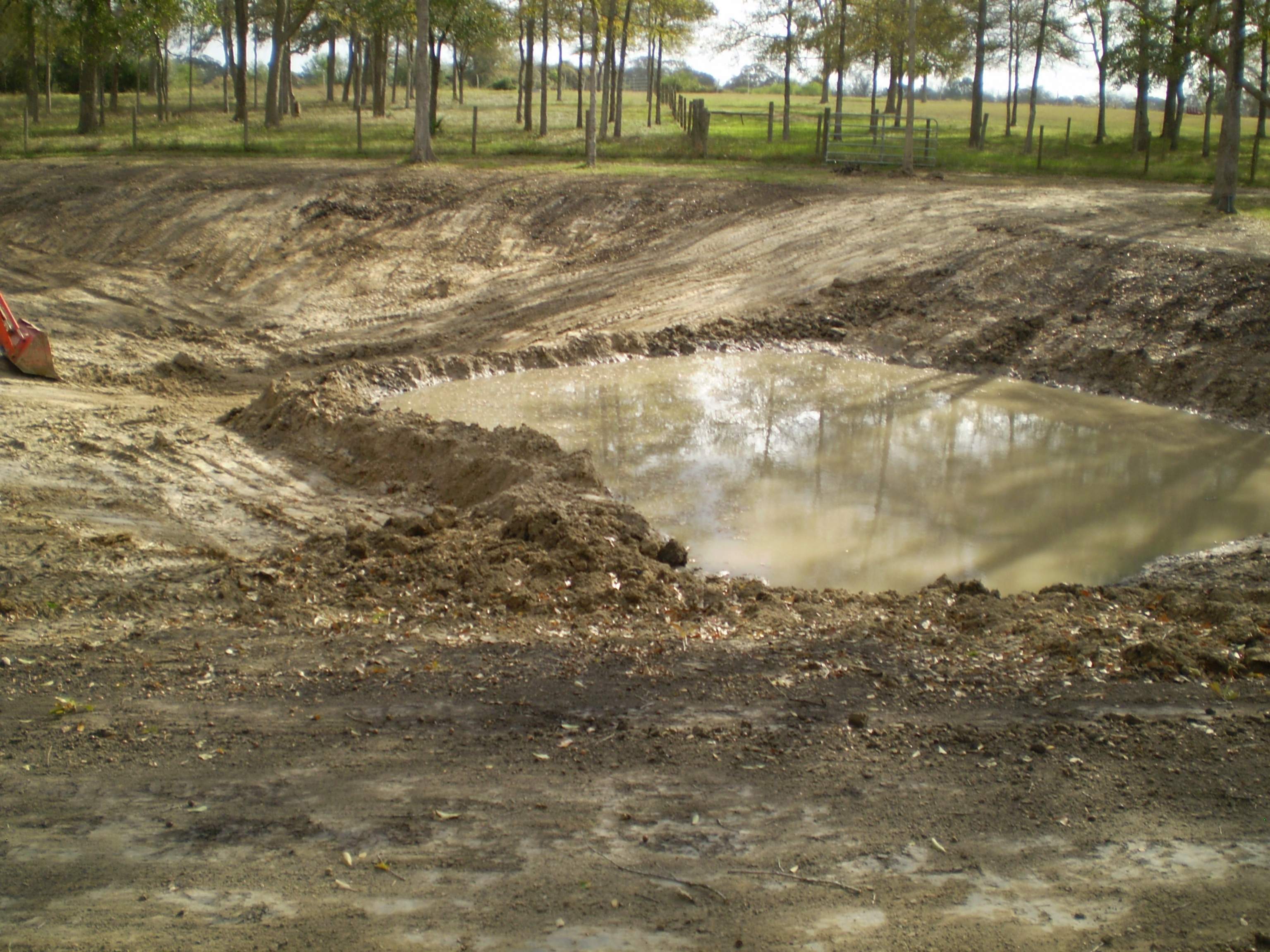

Project Update: Sorry for absence, but RIF (retirement is fun.) Have been so busy with RV travels and just enjoying life in genaral that I han't kept my TBN friends uptodate. Digging is almost done. The next rain will probably be the end of digging. Not even finished and we have FISH. Spring rains filled upstream pond and it overflowed thru my project bringing LOTS of fish. So far have identified minnows, bass, catfish frogs and crawfish. The largest I saw was a 6-8 inch bass! When my first dig filled with water I started another hole next to it, ended up with four water filled holes seperated by dams. All with fish in them. Pumped water from one hole into another and then waded thru mud to scoop up fish in buckets. After that hole dried enough for digging I just went down as far as I could then dained, pumped and siphoned water into deeper hole. Again waded thru muck to save fish. Picture is end result. Havn't measured yet but expect it is close to 1/4 acre and ten feet deep, 100% Kubota Built/dug. Still need to finish off the edges, add structure for fish, build a pier, gazebo, windmill, and plumbing for fire dept. pumper truck connection. I want to thank eveyone for help and moral support. Advise given was was almost always spot on. BIG projects are possible with small tractors. Thanks again.

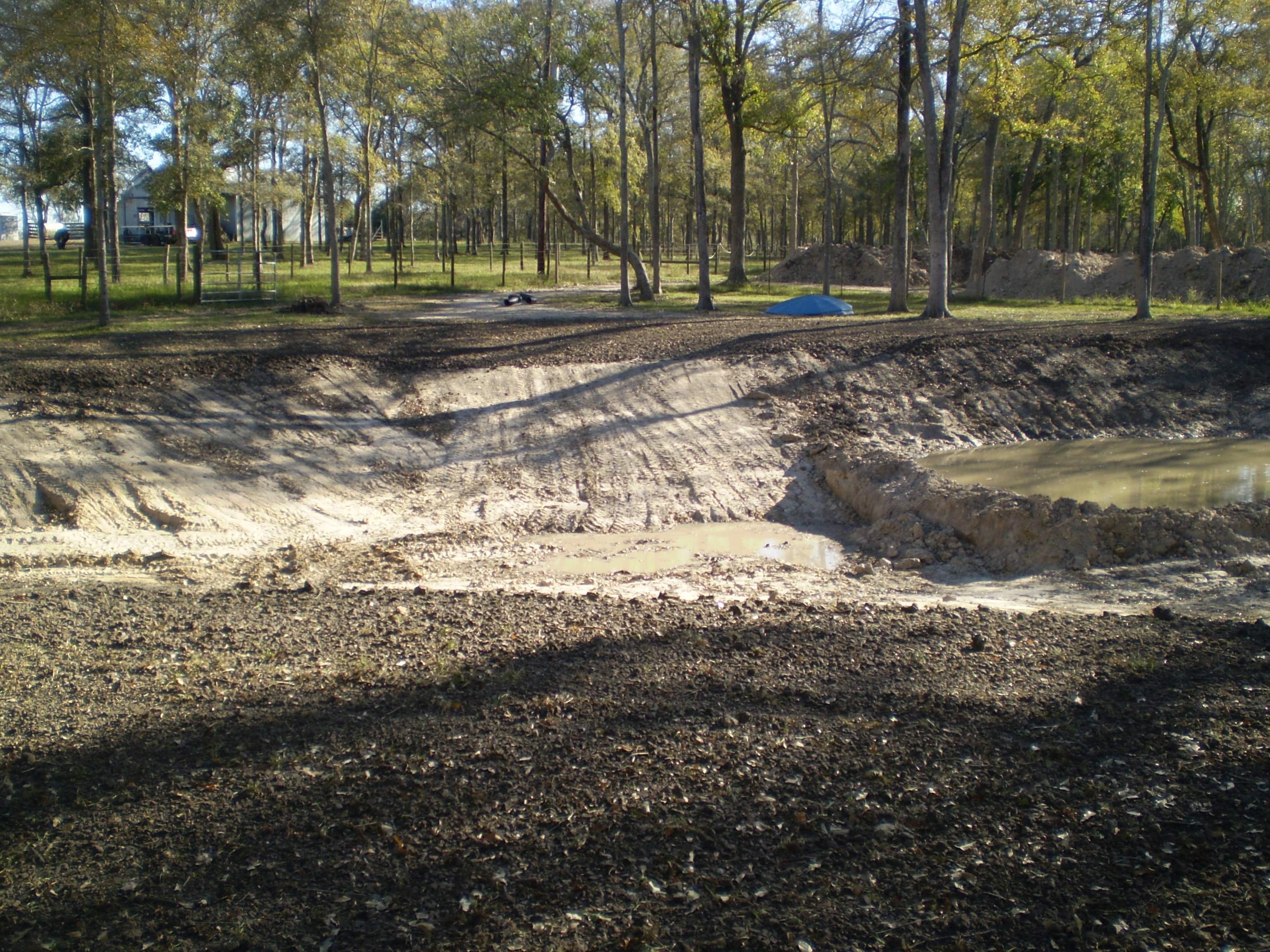

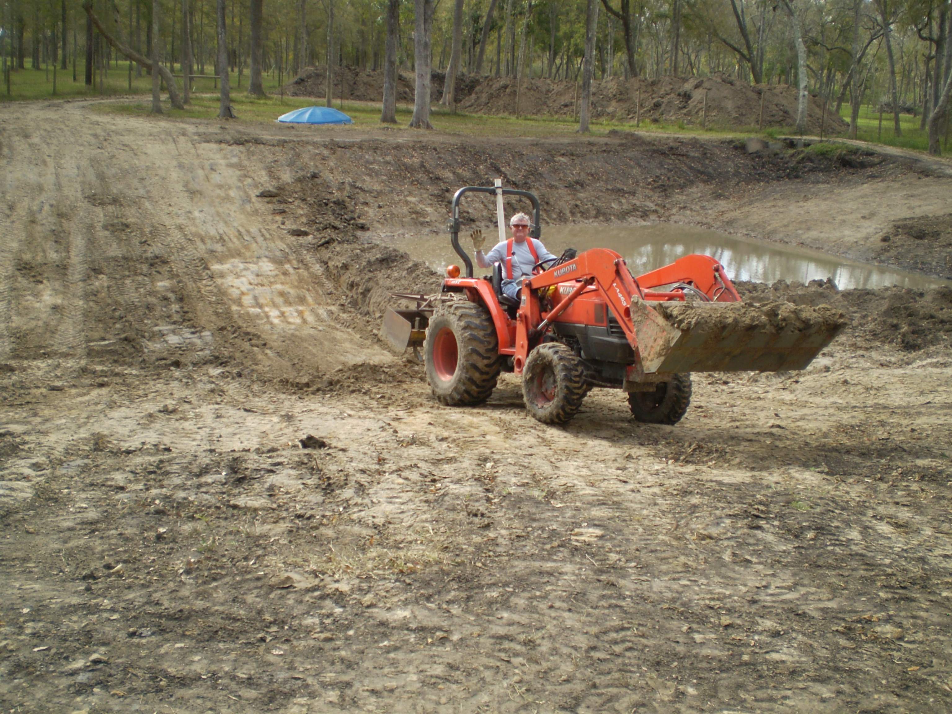

Pictures: before shore line dirt work and winter rye grass seeding and after photos. Notice the well dressed bota driver (color matched suspenders!). Bring on the rain.

Your pond is coming along good.:thumbsup: Nice bota suspenders also.
