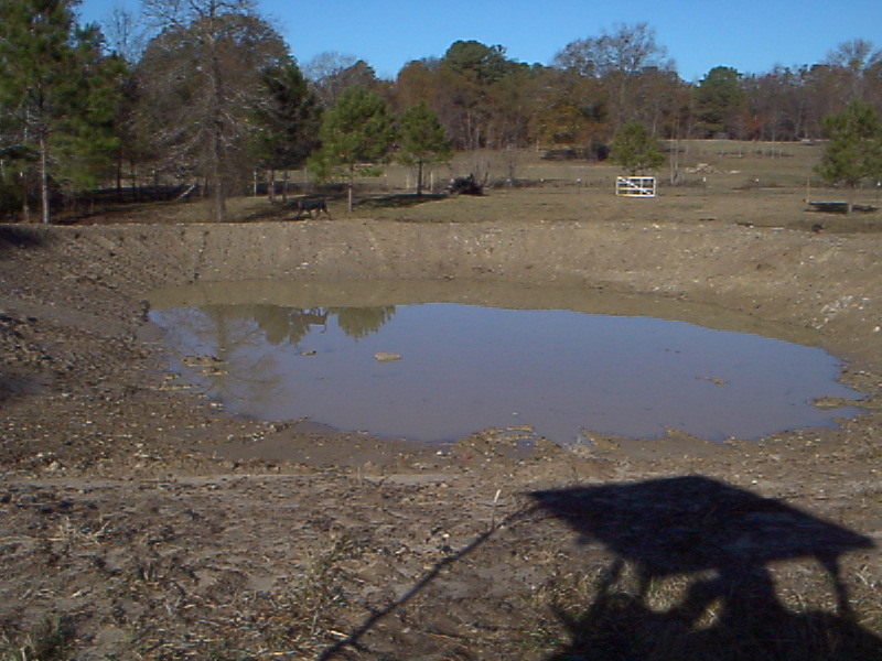

Folks that recommend that you hire someone to dig a pond likely never got an estimate to do one. My Brother in law had one done with dozer and backhoe to meet the Arkansas Ag extension requirements of minimum 6 feet deep below grade not to include the levee height and I think the dimensions were 160 x160 feet. I cost over $5000 and took about a week for the dirt contractor to build, but it passed inspection and the county ag ext. footed about half the cost. I build one about half that size which was all I wanted in 2 days with my tractor and a couple tanks of fuel. By the way, with a large tractor, you dont need a tooth bar. I dug this one with a smooth blade and had no problem with it biting in. My 45 Hp Yanmar wouldnt even dig into loose soil without a tooth bar but my LS P 7010 had no problem till I hit rock at about 5 feet deep. That was as far as I planned to go anyway but I did manage to scrabble a little deeper and remove some loose shale by using the scarifer teeth on the box blade. When I started to hit large rocks like the one in the photo that I left out in the pond, I decided that it was plenty deep. I was just going to make a koi pond to start with anyway. I still need to put in the overflow when I get home sometime after Christmas. But so far we havent had much rain to do more than just settle the dirt in on the levee.
I really enjoyed making this one and enjoyed it a lot more than paying a couple thousand for someone else. I have about $100 in fuel cost and 2 days of my time. So if I calculate it like one of the other post here, I have 20 hours @ $90 per hour + fuel = $1900. It was the most enjoyable 1900 I have spent in a while

   / Build A Pond? #140
By the way, all the dirt from the pond went into making the levee which is required on 3 sides so I didnt have to worry about dirt disposal or moving it very far for this one. My B-I-L and I spent a week of so digging out our 3 acre pond that had dried up significantly and we have several large piles of sandy clay to move which will take a while but we had need of it to fill in some low spots, so it wont go to waste. I used my Yanmar 4220 for that and it would fall thru the dried up crust a lot of time. I was scared to put my LS in it as it weighs more than twice as much as our other 2 tractors. I got the Yanny stuck once and BIL could barely pull it out with his NH 2030 with R4 tire and I sure didnt want to take a chance on sticking that 70HP.
