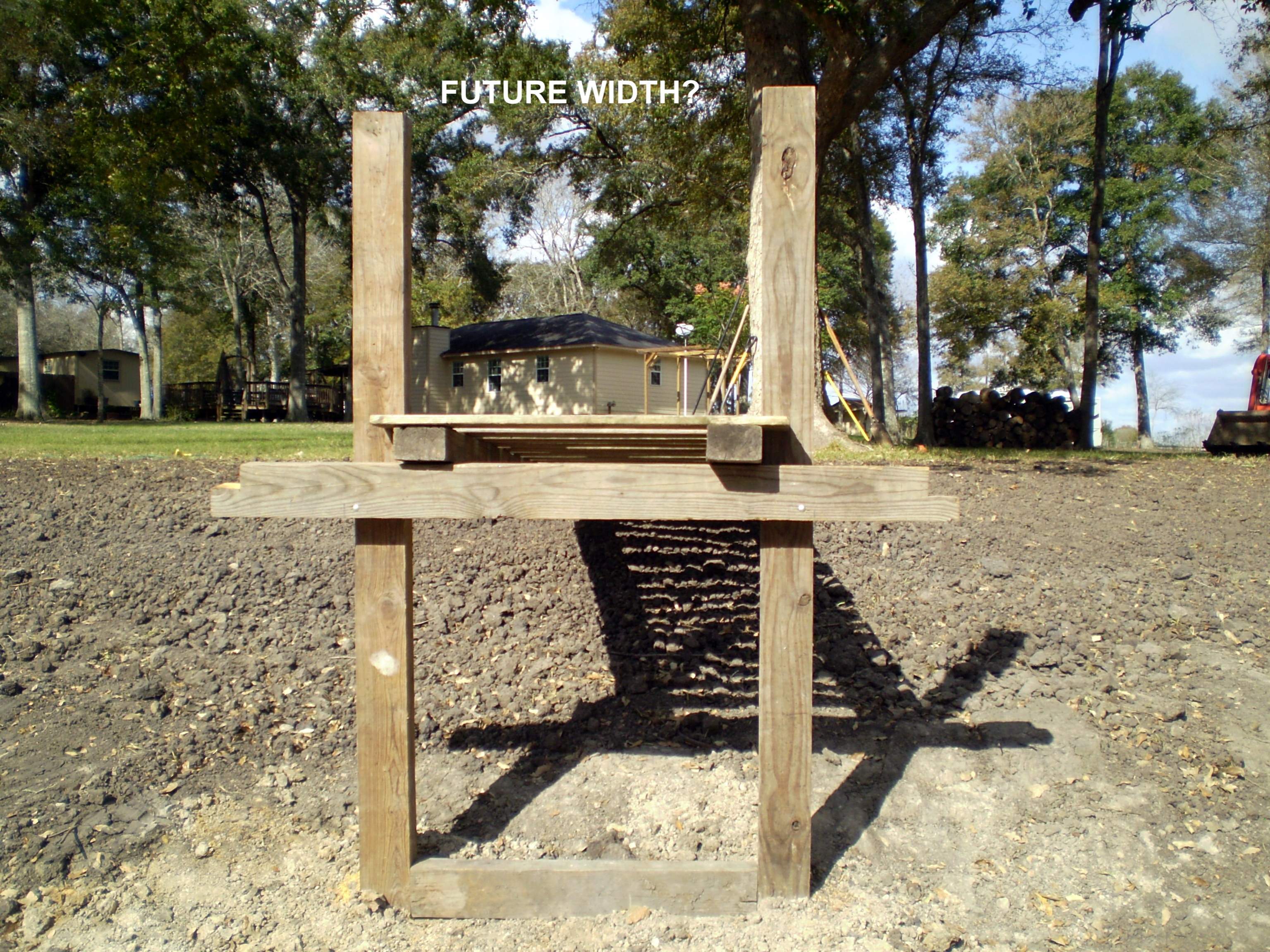

Moving right along. If they upload right. First pic is temp. dock using old walk bridge from ditch replaced by pond. Poles are perm. Hardpan was only a few inches deep at pole locations so I went down five feet and hit nothing but sand. Second pic is non engineer solution to slow poles sinking in sand. Simply mounted a cross piece on top of hardpan, hopefully the increased surface area will slow pole sinking. Third pic is perm dock support showing finished width at end of notched beam. Second phase of pole sinking solution is extra long poles. If adjustment is needed-just lay beam on top of poles and with cable winch, lift dock-move crosspiece up and shold be good for a few more years. Arn't theories grand

Fish House. One objective in this project is to use as much stuff from junk piles as possible. Decided old drain pipe might make a good fish structure. Cut into smaller sections and wired together. So far only out ot pocket expense for whole pond project has been diesel, grass seed and toothbar
