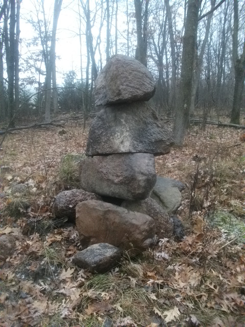

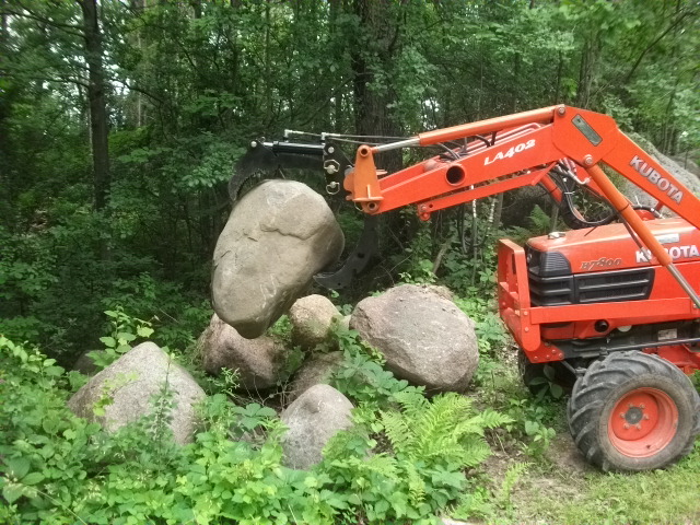

I do it with a B7800 and a small grapple I designed and built. The rock in the picture weighs 600-700 lbs. The pile is what I stacked using it.
