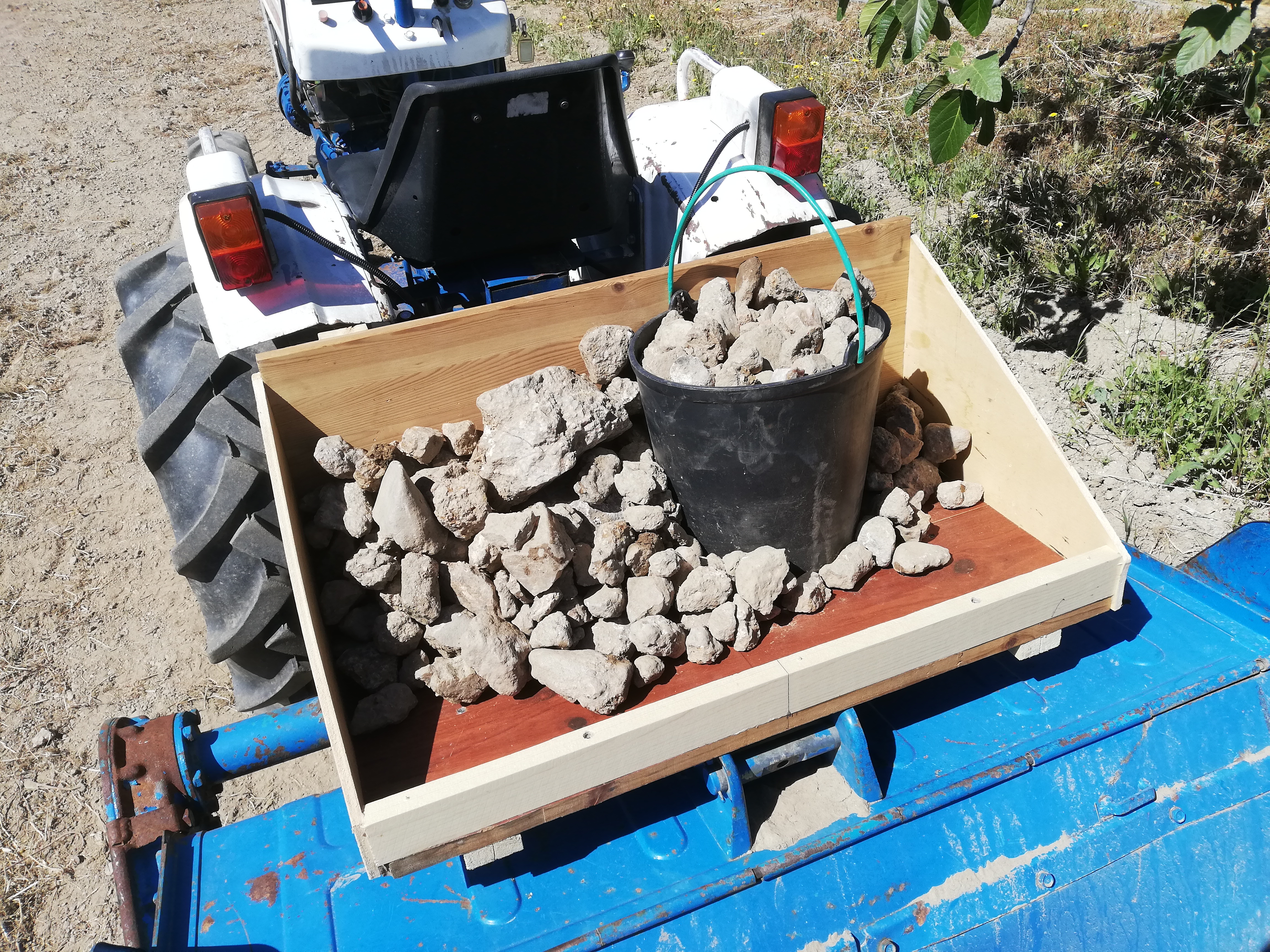

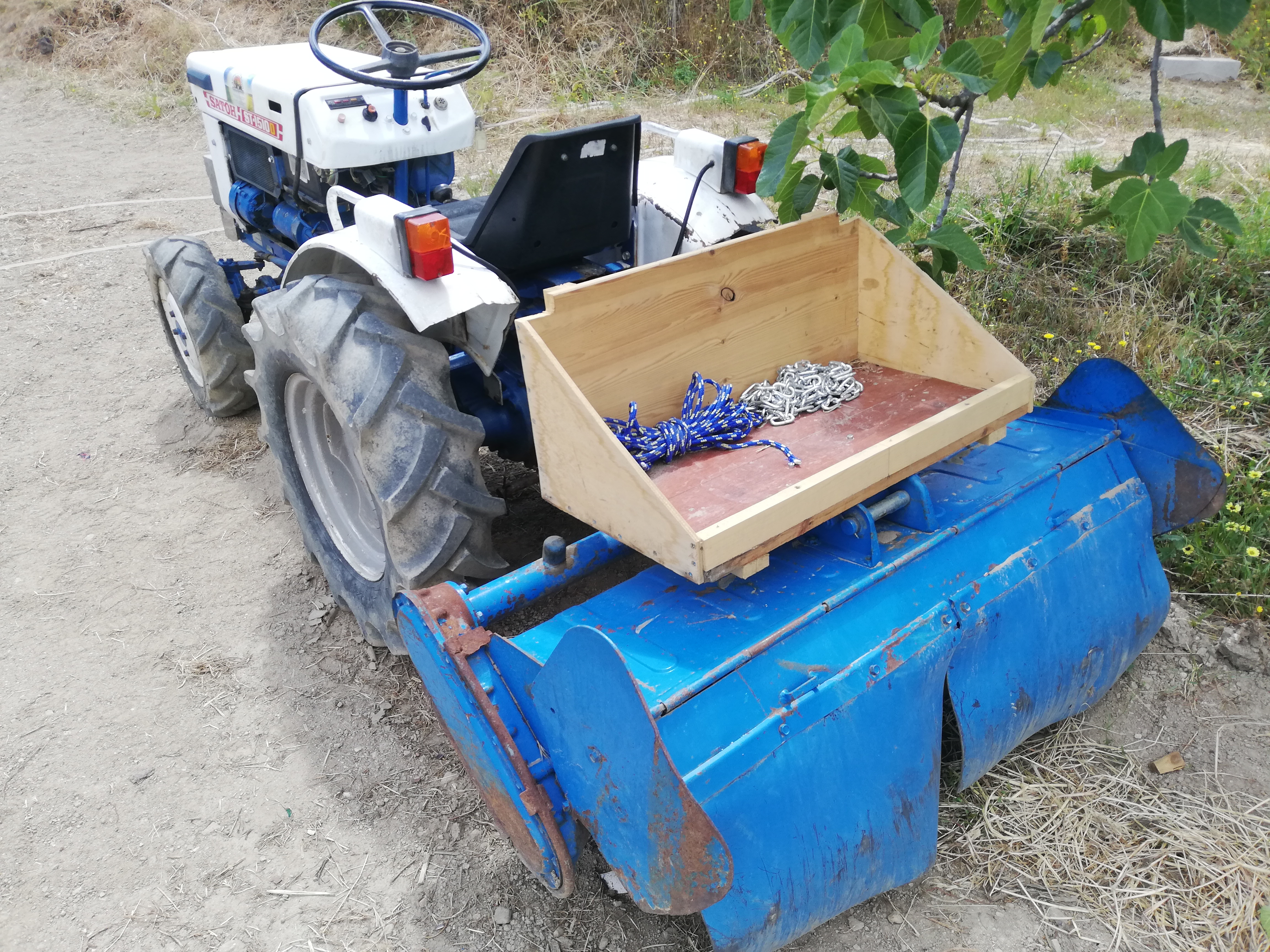

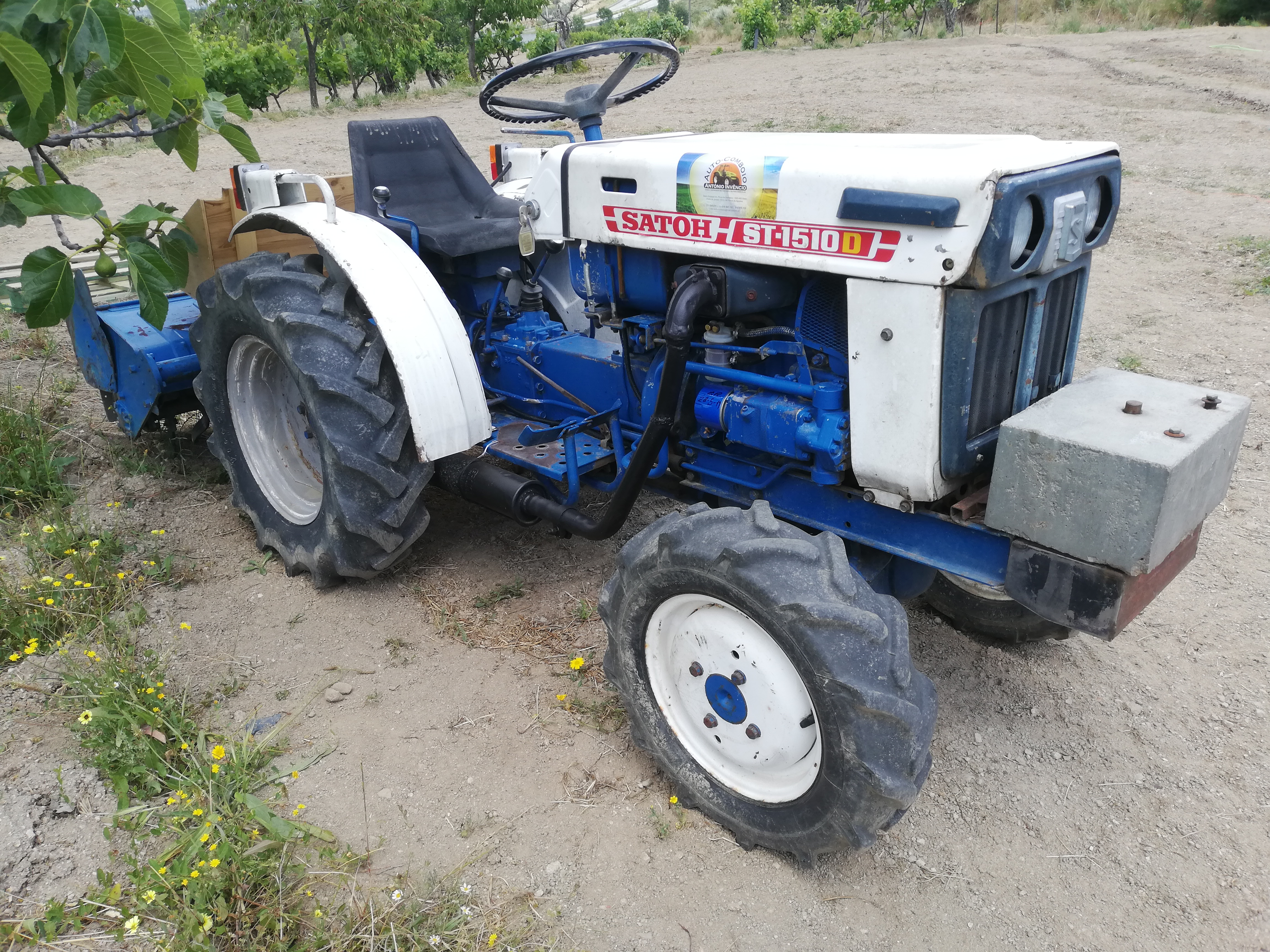

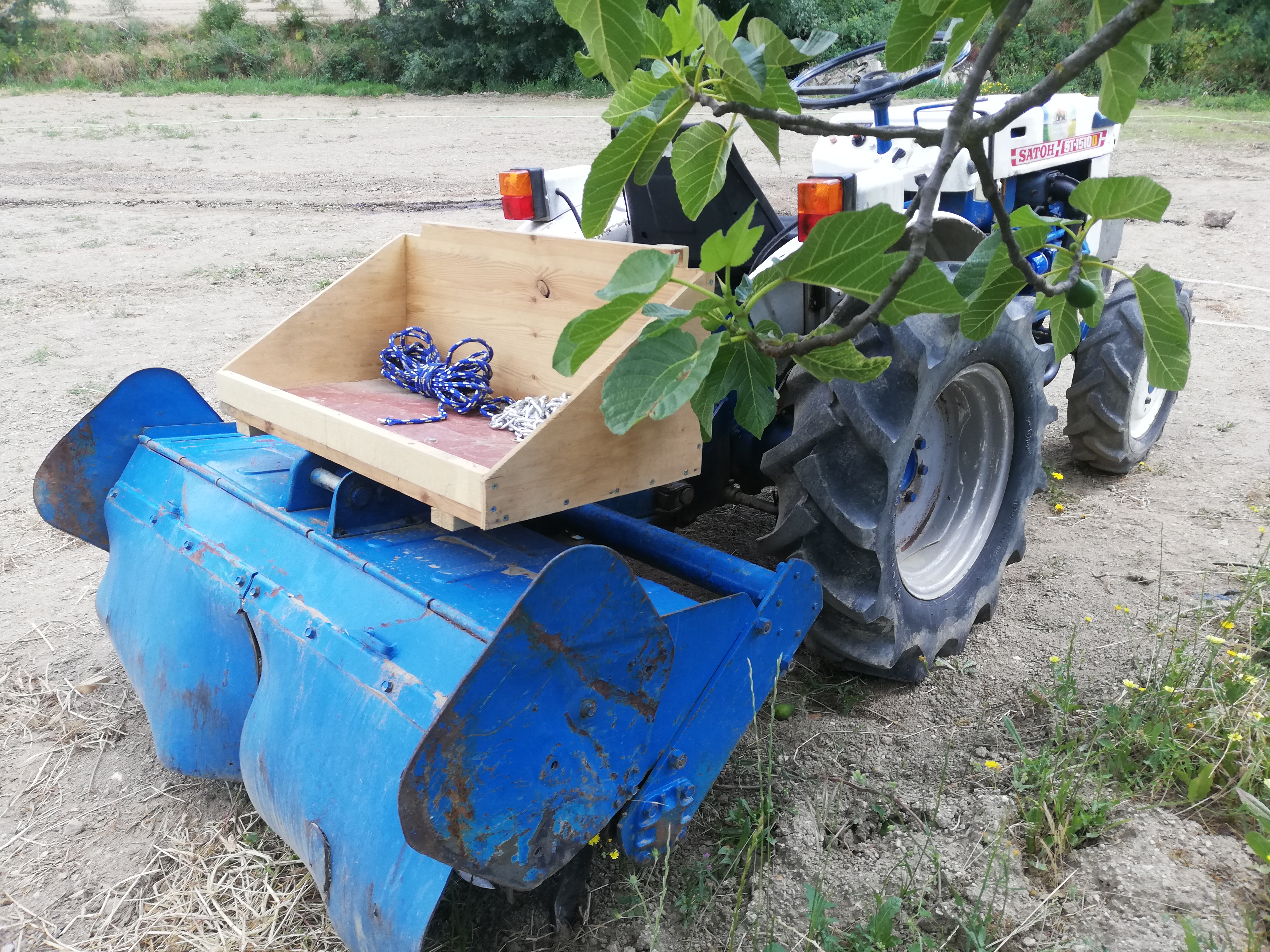

This is my very modest and simple solution to carry a few things back and forth. Built little more than a month ago.
Served it's purpose perfectly and extended the usefulness of the tractor as is.
While keeping the rototiller assembled on my "new" (to me) Satoh ST1510D.
Cost - Dirty cheap, beside some screws, glue and a few nails. All the rest is "free".
Time - About 2,5h. Took me some time to find, gather and hand cut the elements. Everything are left over from other projects.
Dimensions - Adjusted according to materials gathered.
Tools - Only power tool used, electric screw driver. Handsaw and a hammer. That's it.
Built literally on the ground and over some stones. In that location the term "off grid" is 100% absolute. ;-)
Cheers all
IMG_20190528_103409.jpgIMG_20190605_150629.jpgIMG_20190605_150658.jpgIMG_20190605_150712.jpgIMG_20190605_180416.jpg
Also served as a "ladder" to pick those cherries and a lot more. :)

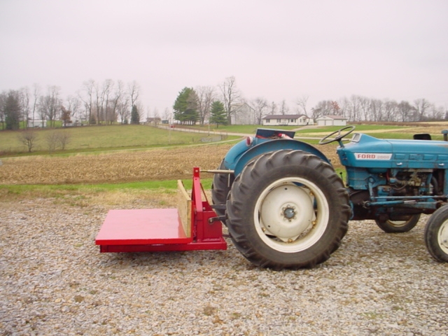

Mine is similar to crpt2008....wood box on pallet type base. I mounted a hunk of 8" PVC pipe in the corner for shovels/etc. Also mounted a pc of black tarp I keep rolled up with couple strings so if I get caught out in a rain shower, I can roll it down over the lift to keep the tools from getting soaked.

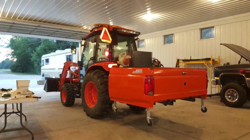

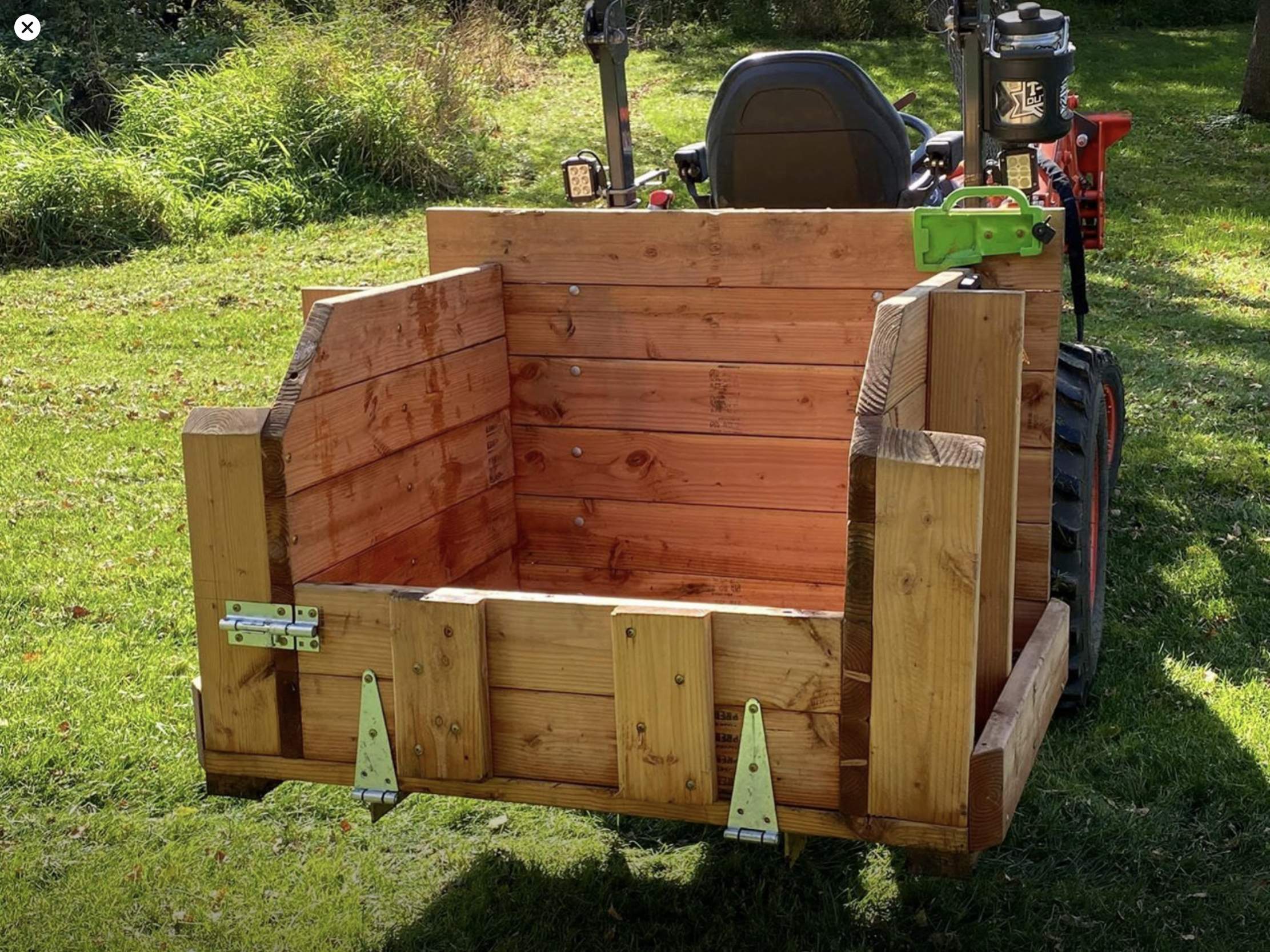

   / Build Your Own 3 Point Carry All #25
Now that one is really different from any I have seen. Very nice work jeff !!!

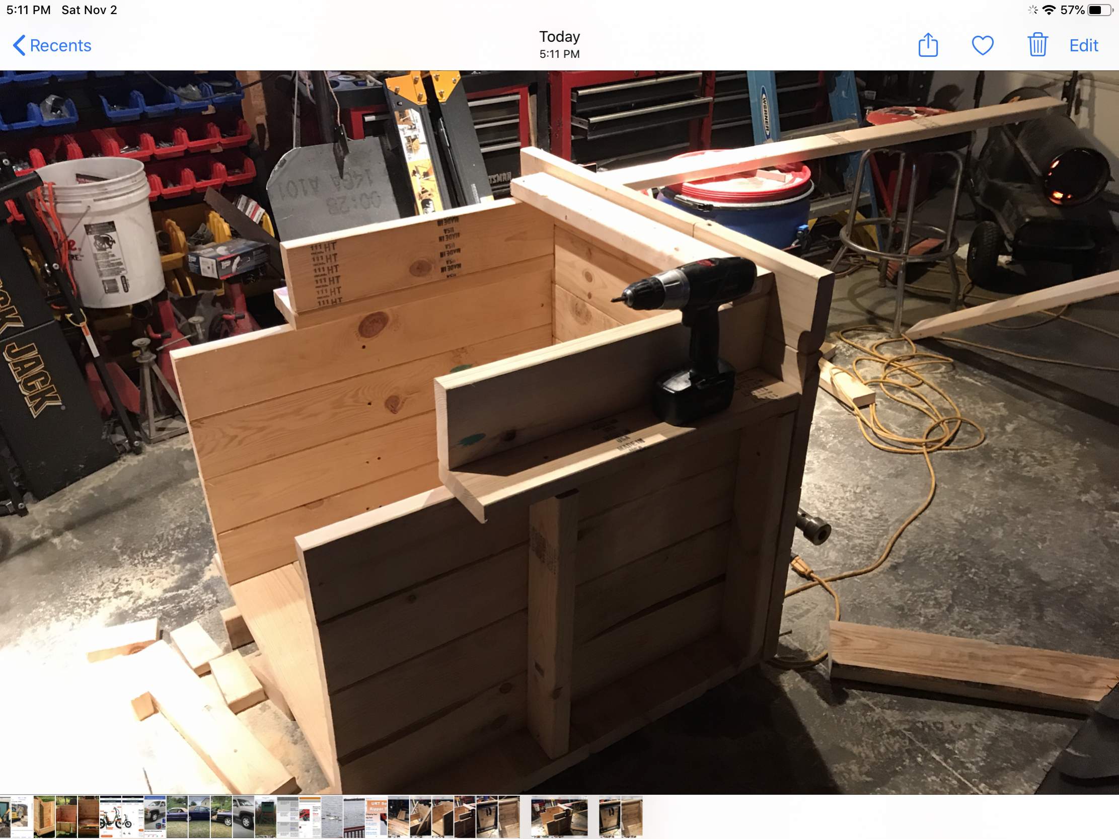

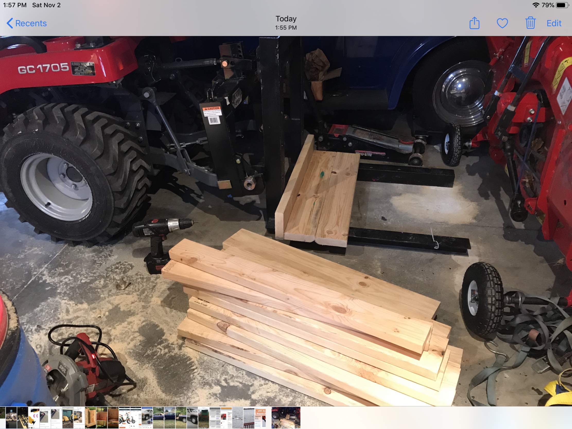

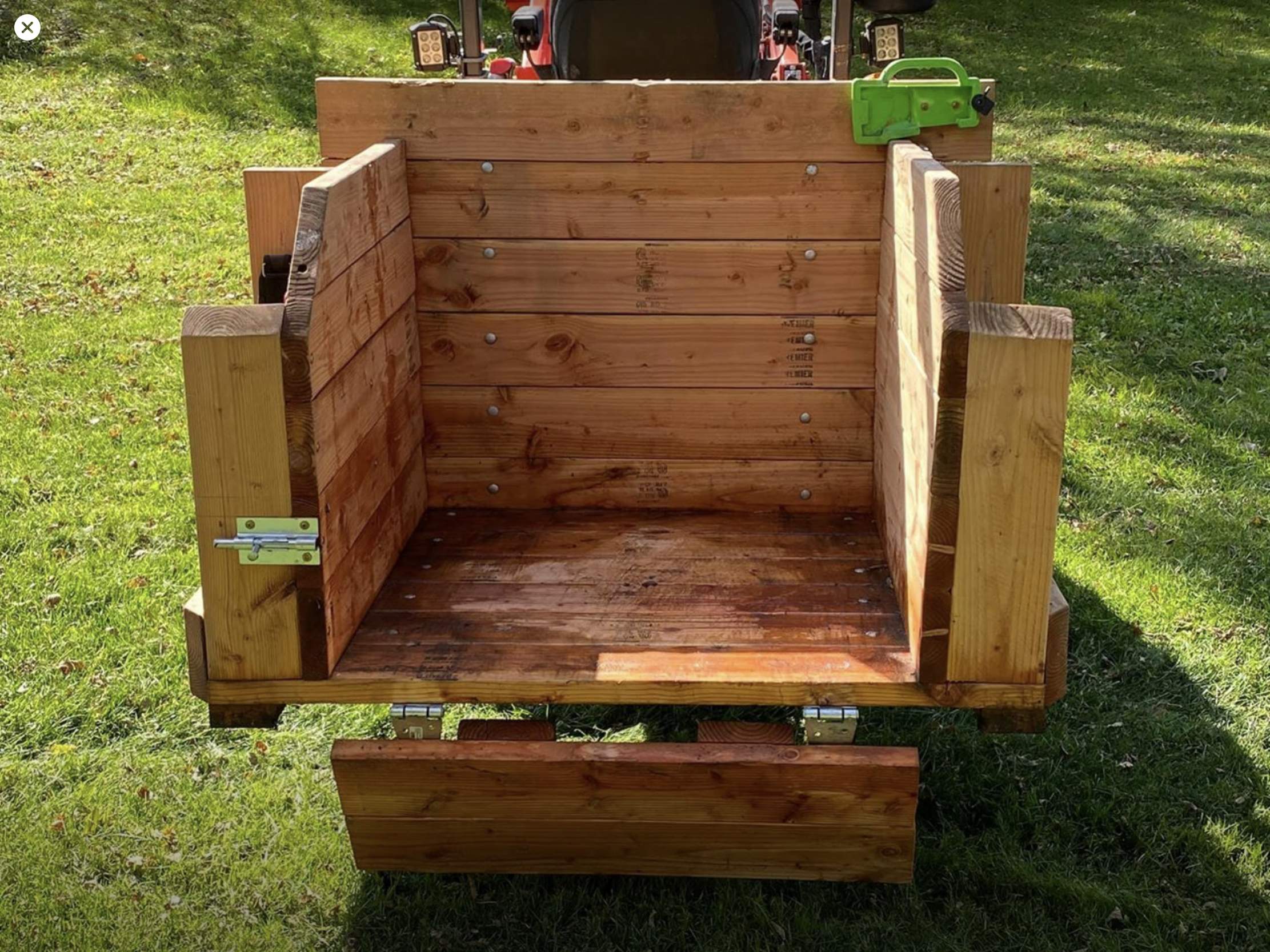

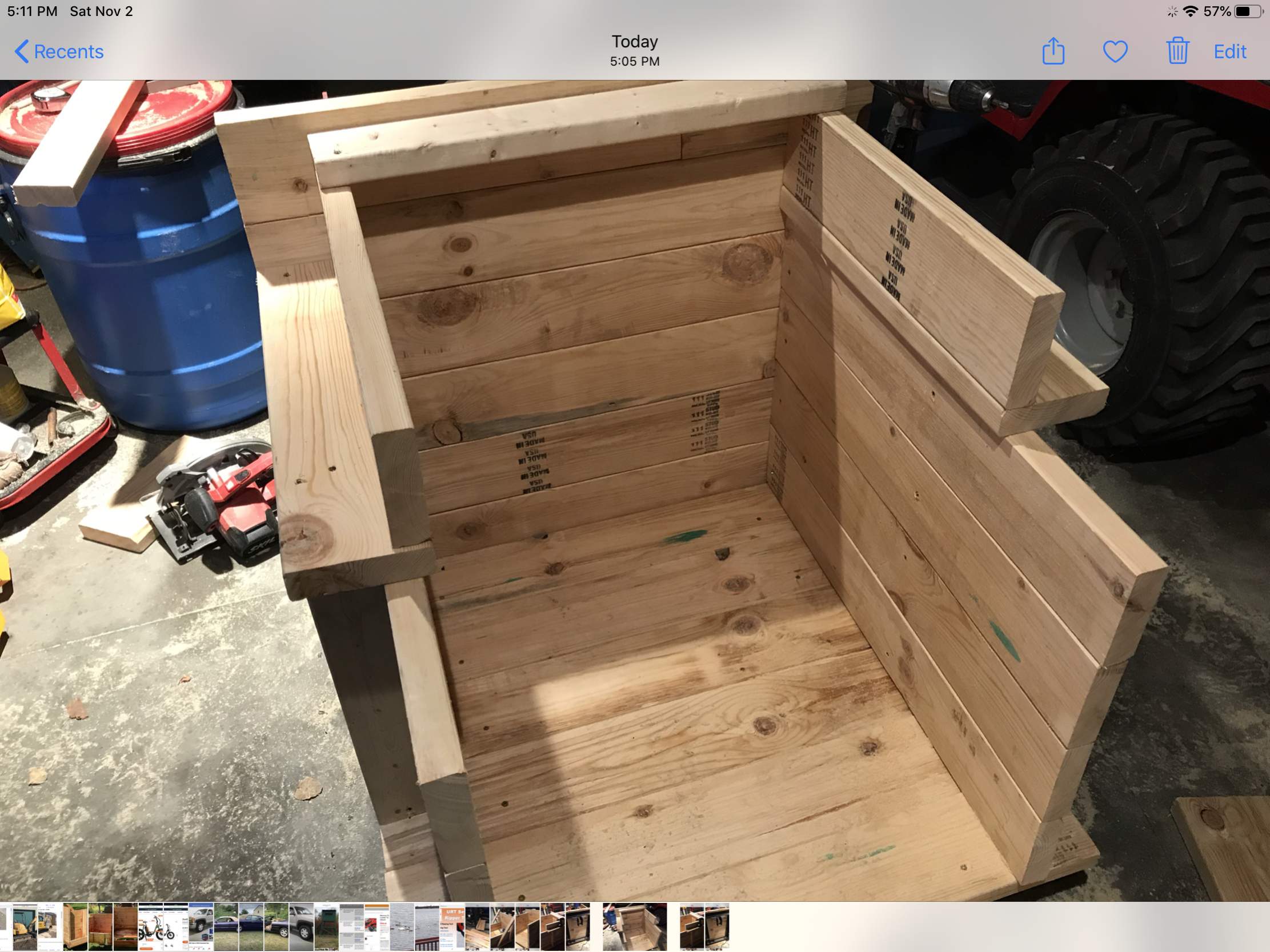

Will finish mine today but it is going to look a lot like this.
   / Build Your Own 3 Point Carry All #28
Well I ran out of screws and still need two hinges and a bolt latch and two rear posts to finish the rear tailgate, i built mine so it comes off the metal carry-all so I can still use it for other things the one I kinda copied is attached to the carry-all. I will add some pvc piping for shovel and rake holders and I will also be adding a few other items for other tools.
My total cost is 149.00 dollars plus 2 hinges a latch and a new box of screws.
Fun little afternoon build.

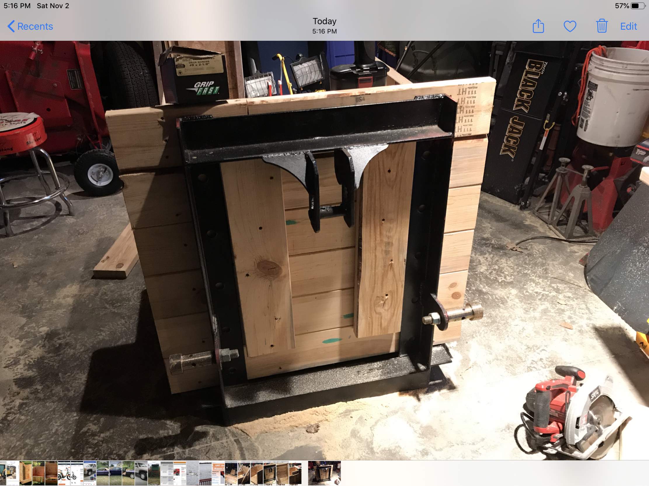

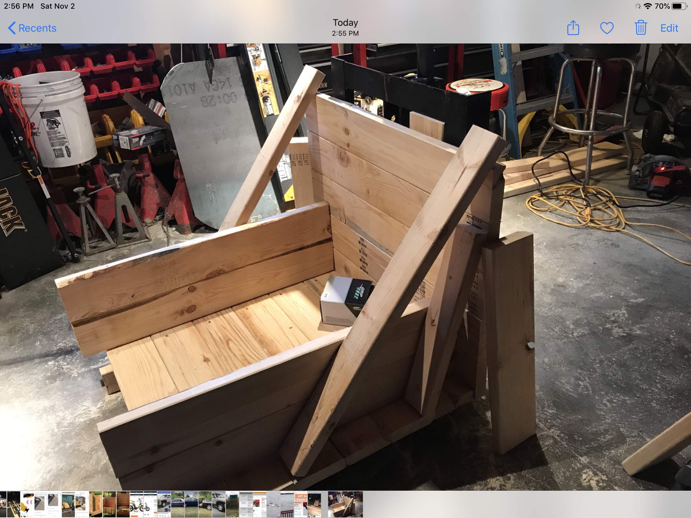

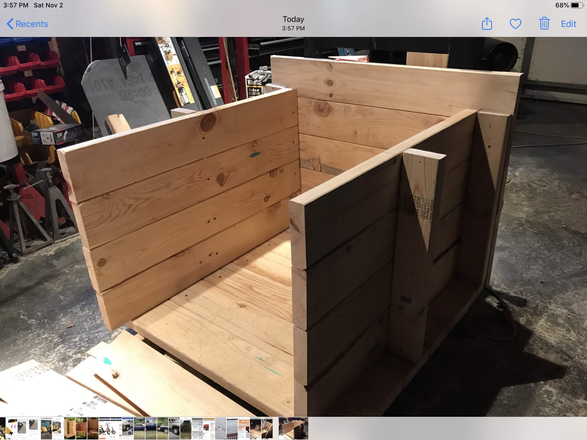

I have to admit i built this carry all about 2 yrs ago with 2x3x3/14 steel tube, locust boards i cut and stainless bolts. It sat outside unused for the whole time. 3 weeks ago i put it on for the first time and man idk if i see my self taking this off for very long. Its like a flat bed pickup with a lift gate. Absolutely wonderfull for moving around firewood and garbage cans.
I did weld on a 2in reciever this weekend. But if i was to do it all over again i would prob make it about 12in shorter. Weight that far away from the hitch dosnt do well.
It holds so much wood my little b8200 cant lift it.
