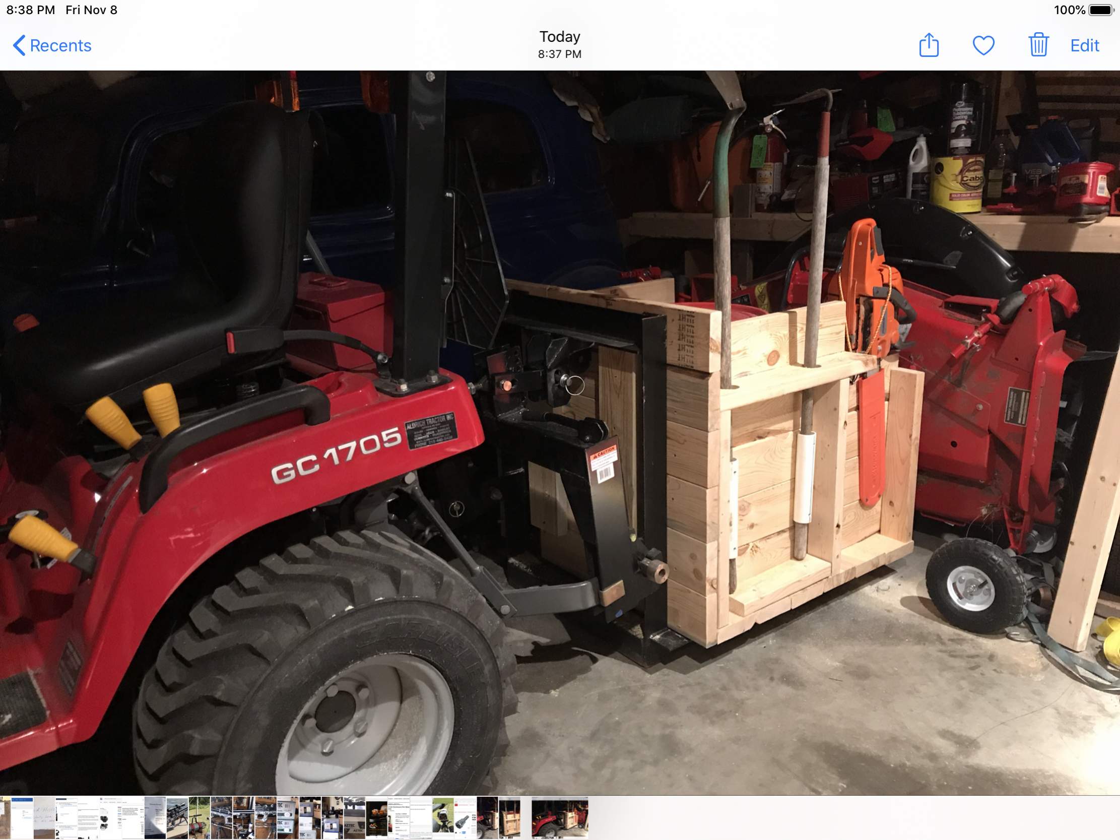

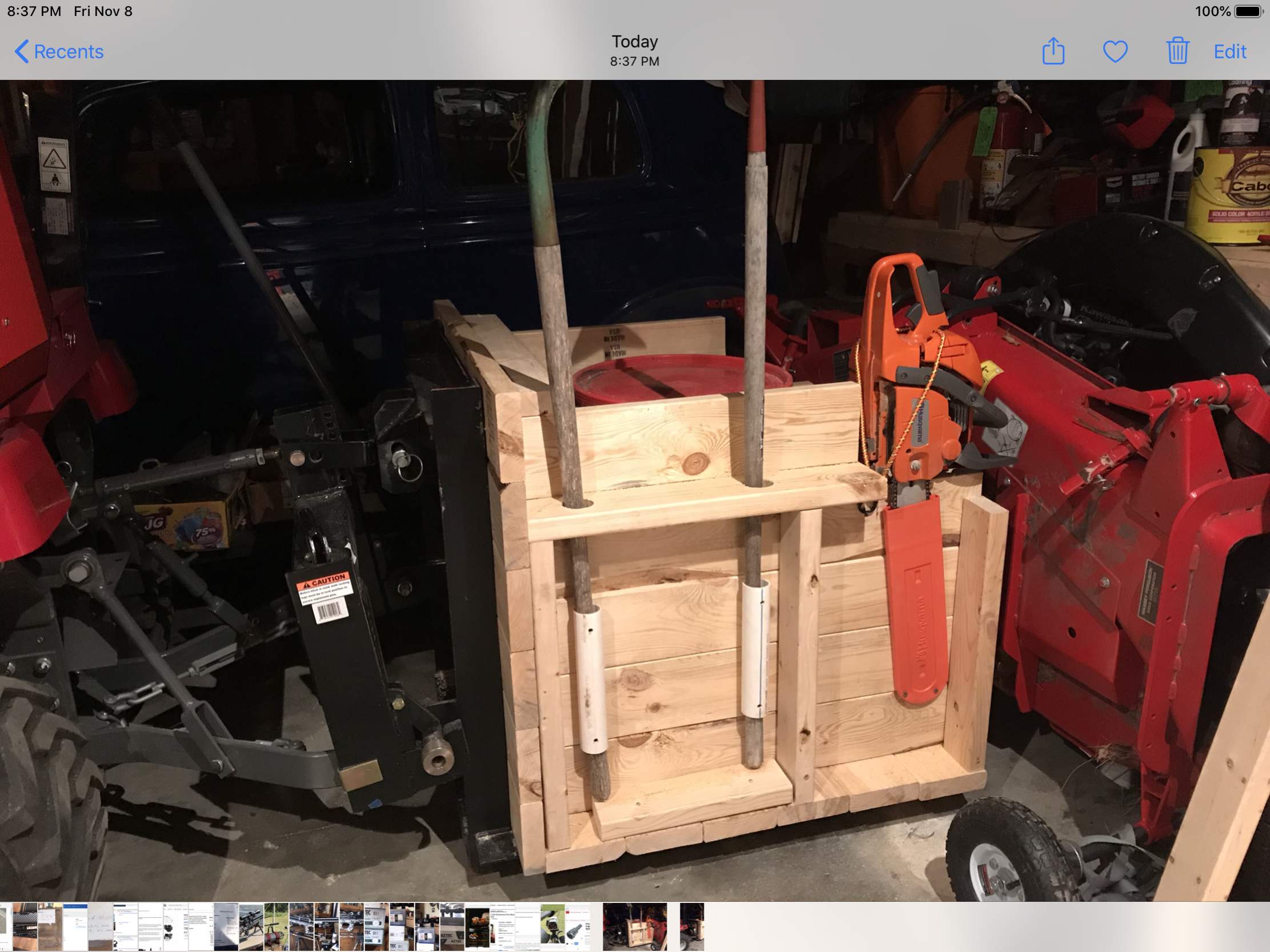

Well all is done but some paint, think I will do some sort of red to make it stand out hahaha.
   / Build Your Own 3 Point Carry All
#36
That’s looking good!
