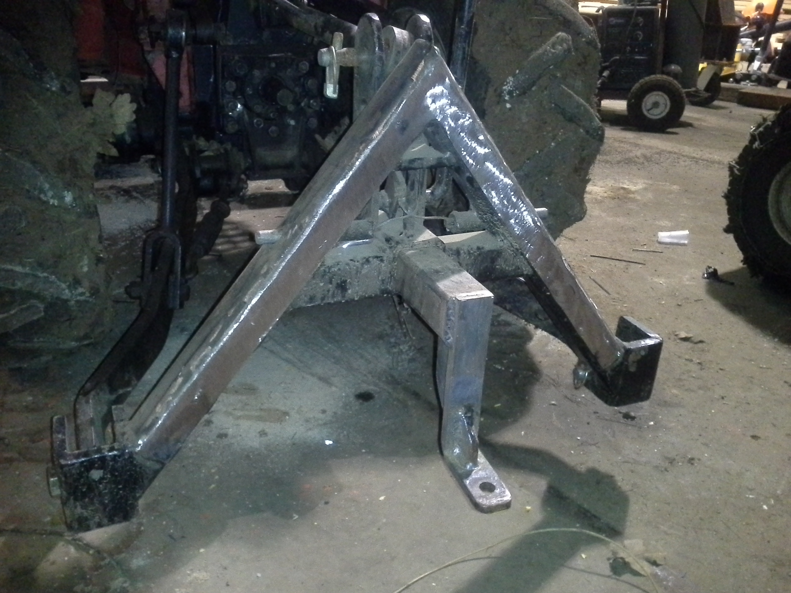

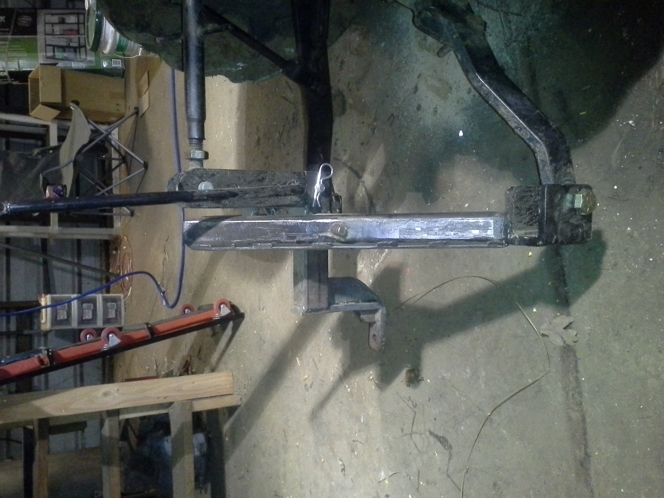

I built one patterned after a jiffy hitch using 2 inch square tubing with 1/4 wall thickness, and welded a piece of 3/16 x 2 flatbar to the face of it so it matches up with 3 inch ship channel for the implement side. the nice thing about the way the jiffy hitch is made, is it incorporates a 2 inch receiver tube in the design so you can just put a trailer hitch in the tube and go. I will post pictures of mine soon.

I built my hitch for the tractor and 4 implements for around $200. I really like the self aligning of the hitch, if you get anywhere close to lined up it will connect. also I think my hitch keeps the attachments closer to the tractor which is important on small tractors.

pictures of my home made jiffy hitch. I also included a pic of the ship channel, it has much longer sides than regular channel iron.
