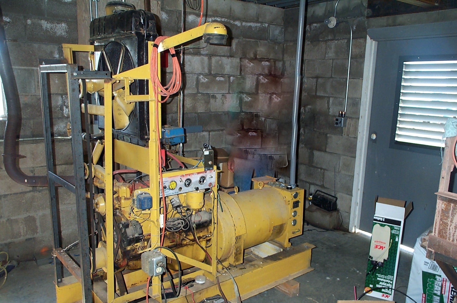

if one wants to use a one bearing generator, I suggest, you go with one that uses a flex plate, (the flex plate, is disk that attached to the flywheel) like a automatic transmission in a car
but it would be much easer for most to use a two bearing Generator, and some type of flex coupler to drive it, (that would be rated for the speed),
here is a picture of the generator I assembled, used a old flat head Chrysler industrial engine, and a single bearing generator what used a flex/drive plate, I could not find a bell housing so I have to make my own, if your generator takes a standard industrial SAE bell housing, and the flex plate or (drive plate),
it would be fairly easy, but if you try the tapered shaft business and trying to mate it up to a bell housing it is a job,
but using a two bearing generator would have been much simpler, as the method of attachment would have given many more options,
some type of a direct flex coupling, belts, timing belts, gears, drive shaft, and U joints, and so on, the precision needed is much less than with a single bearing design, and self assembly,
(the reason for the tapered shaft is so it will mate to a specific type of motor, made for generator, or a custom made unit by a manufacture, and it saves the manufacturer the cost of a second bearing, and a more compact unit, and since it direct bolted to a motor it works well, and the consumer simpler maintenance),
