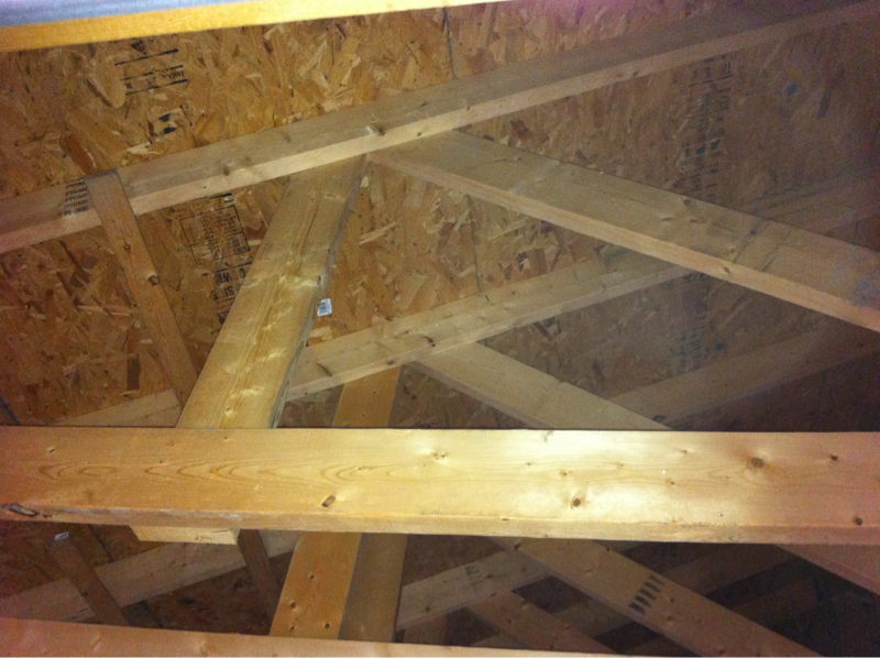

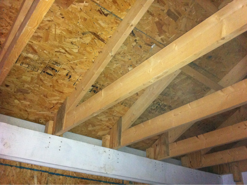

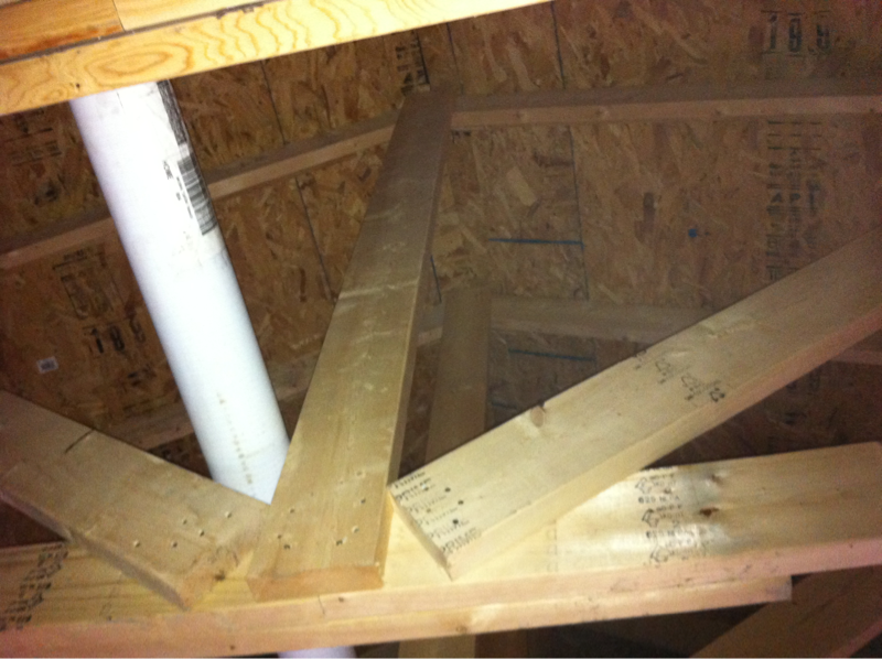

I built my own trusses last year make a jig and save yourself a lot grief.If you make a fixture you won't have any difference in the size of your trusses,if you don't you will.
I built mine from 2/6/16 ft.It took about 10 days after work at night and they are about all 1 person can handle by themselves.
I went 2 ft on center Osb for the roof and I used shingles.Last winter it had over 2 ft of snow on and no problems,it was a 6/12 pitch.Good luck and enjoy!

Bearcreek, thanks for the pics. The build looks great. :thumbsup:
