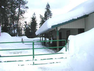

Yeiks, in all the places i would scrimp and save.....it wouldnt be in the trusses. Not sure about where you live, but here the snow load engineering is something i wouldnt want to mess with. When my trusses were delivered and installed, a few had to have an onsite repair done. They used a hydraulic press to install a rather nasty looking plate...not the simple plate like lowes has. This thing took alot of power to install.
