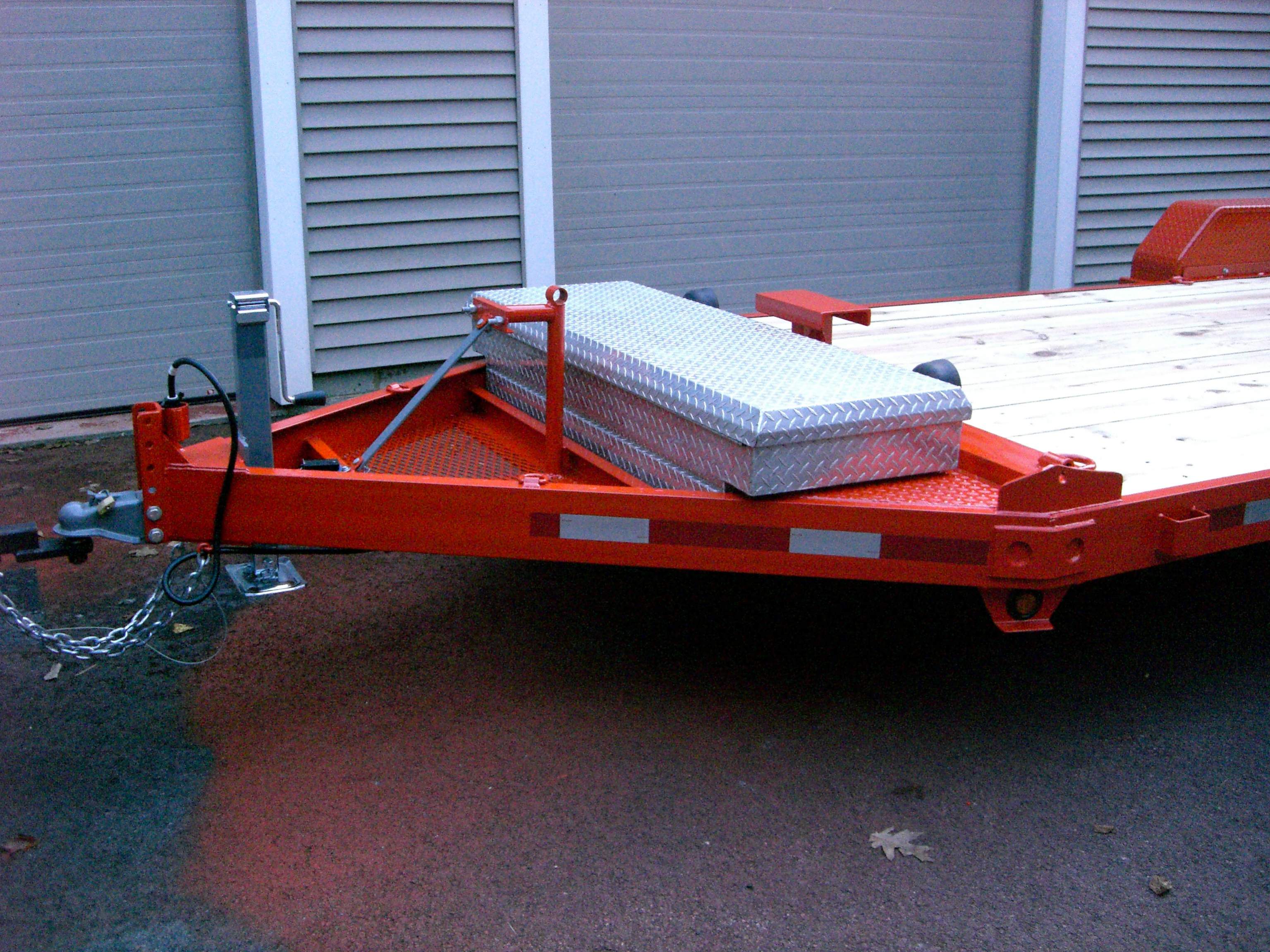

A few pictures of my trailer, I bought Dexter 7,000lb axles and all the steel, wood, LED lights and hardware for $2300, it took about a month off and on to build. My welder is a ESAB Migmaster 250 with 75/25 Argon/CO2 mix, .035 wire. It is 102" wide and 20' long, hauls like a dream! And you can't buy a trailer with 38 tie down points! CIMG1739.jpgCIMG1859.jpgDSCN0902.JPG
