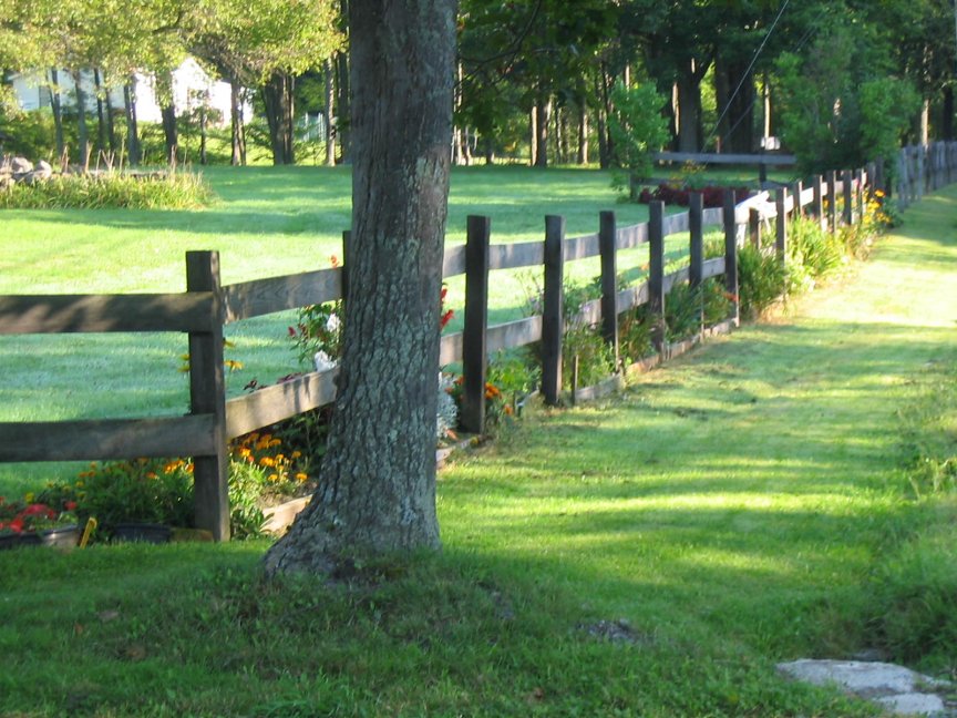

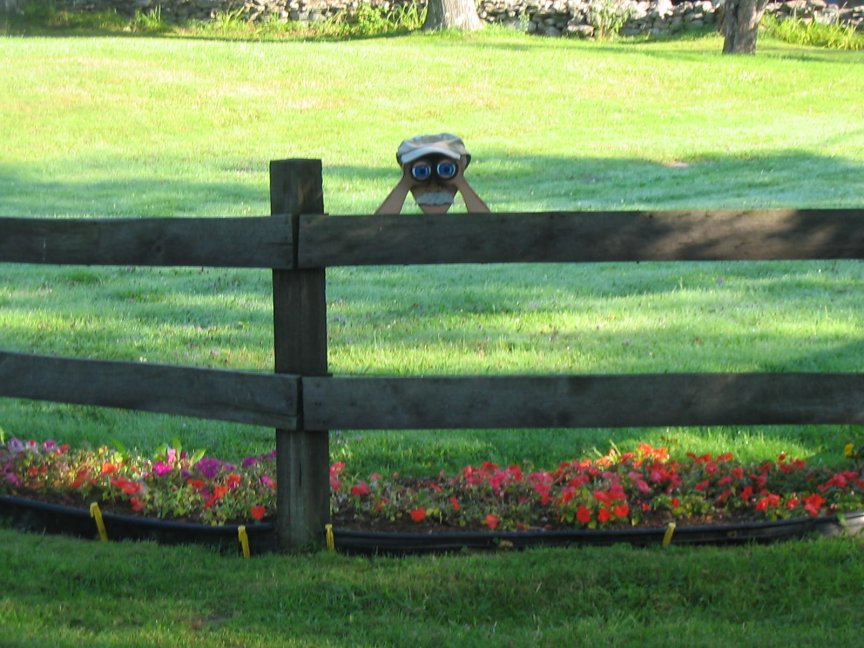

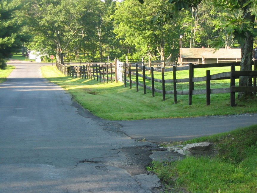

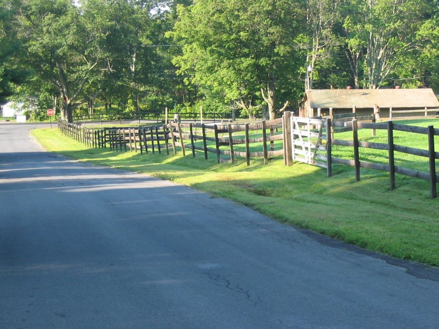

Gizmo,
Sounds like you put up a good fence. 22 years is a long time. You have pictures of your fence?
Taken this morning.
