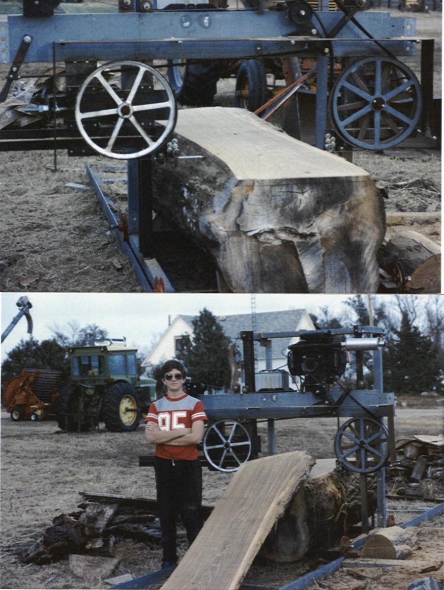

I know of several people who built their own bandmills, but was not involved in the build so most of the mistakes you will have to make yourself. Sorry!! Only one has been a personal friend, the others were from the forestry forum, which has some really good and knowledgeable people on it. It is a great forum, and has values similar to this one.
The question about having the spindles built to fit wheels, has been answered in several directions. One is the auto spindles that bolt on with a flat back, and I will add to that you might use a rear axle from a front wheel drive car which MIGHT have a piece of axle available to you to allow easier mounting for the idler wheel. Muffler clamp style of mounting. As far the powered drive wheel, that gets a little more complicated, but there is a huge diversity in how spindles and wheels are driven in the automotive field over the years, and those parts are cheap (comparatively) to what else will be available. If auto style wheels don't make the cut with you, then definitely look at trailer axles and hubs. The good thing about them is you won't have the brake drums to worry about, as the hubs can be bought without brake drums.
If you don't have acess to machine tools such as lathe and mills, it would be a really idea to find a local shop or a hobbiest that accepts donuts and beer bribes, lol. If your not a good fabricator with metal, stop now and save yourself a lot of heartaches. If you can fab up simple metal items with sucess, continue on and realize that a complicated bandmill is just a bunch of simple projects combined together.
Pulley wise, the one I would pick would not be a lightweight pulley, but a multiple belt heavy duty pulley, preferably with a taperlock or QD style of way to mount it to the shaft. Those can be found in junk yards that specialize or deal in machines rather than just automobiles. If you can't locate the right size, you might need to consider (if the carriage allows room for) using a jackshaft to give you a chance to reduce the speed without having to go with a really big pulley or a really small driven pulley. \
What you have pictured in your mind is going to make the factors that control what will and won't work, so if you have sketches or pictures of one like you want to build, please post them for us to see.
Good luck with the project, looking forward to hearing more.

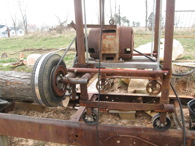

I built my donut tire mill 4 years ago,based on plans I bought from Bill Reeks. Then I built a 26'x28' barn over it-cedar 6x6 posts,poplar lumber,and oak siding. Right now,I am building a 24'x36' barn,but going with all metal siding.
I have never broken a blade,but I've ruined a few, sawing into the log stops.
I used trailer stub axles and hubs,the belt pulley is the lip off of another rim,welded to the drive wheel. Still on the first belt-single B belt.
I had the scrap metal,and an 11hp Honda.Bought a house trailer frame,and doubled it up,for the frame rails and cross members ($100)
I have had no problems with it, and just used it again today. The biggest problem I had,was trying to roll logs onto it,by myself. I built a log hauler arch trailer,and I can back right over the mill and set the log down on it.
All you have to do,to change blades,is let the air out of one tire,change it,and pump it back up.
Cook's Saw is the best place to get blades,and they sell all the wheels and parts,if you want to go with cast wheels.
I could put a 36" log on it,but 30" is about the largest I had,and I can cut 18'
If you are going to put 36"x40' logs on it,you will need a strong frame,or a concrete pad to set it on. You can't cut straight,if the frame flexes.
Mine is a no frills,hand crank up and down,push it down the track,basic mill.
Simple,cheap,cuts great,kind of slow(my speed) Best thing I ever built!

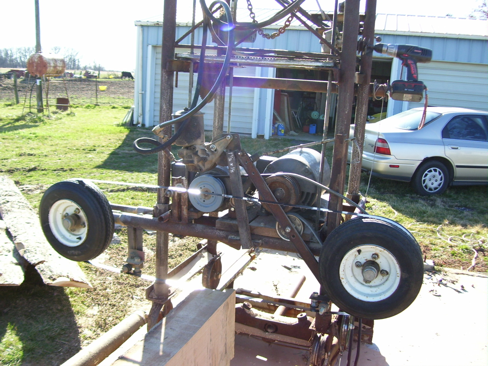

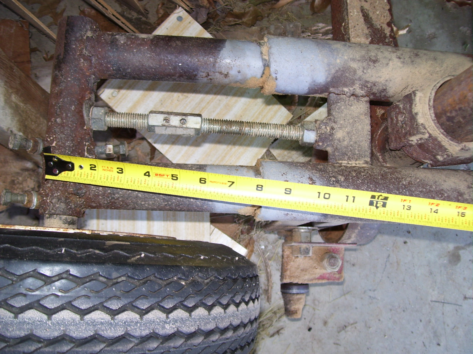

I used 8 inch trailer tires/spindles for my bandwheels and carefully welded a 9" pulley to the rim- it was an exact fit and easy to center. The 8" trailer tire has a 16 inch circumference.
The spindles are each set in a pipe with two sets of angle adjusting bolts (one each 120 degrees) clamping them in position. This gives me adjustment in all 3 planes so I can get the blade tracking correct. The blade is tensioned with tire pressure as well as with a telescoping idler wheel frame (see the pic with the tape measure).
There are two "generations" of mill pics here. The original mill had a single 5hp electric motor (actually a 7.5 hp 3 phase with a static converter). This past year my dad and I added a second electric motor and a hydraulic feed (you can see the power steering pump in one pic). The hydraulic feed was OK (hydraulic motor on the carriage controlled by a spool valve pulling a cable attached to the frame), but I prefer to hand feed with a crank (same cable set up but I crank the cable spool). The hand crank lets you "feel" how hard you are pushing the saw so you can adjust speed better than with the hydraulic feed (and in some cases you can cut faster with the hand feed).
The current set up uses two 5hp electric motors pulling in tandem joined by a belt and did well making 17" wide white oak boards.
The saw bed is the frame off a 1959 chevy 2 ton truck with a pice of angle iron on the sawdust output side and v-groove casters on the saw carriage. I can cut 28" diameter logs that are 16 feet long.
Saw guides are made from sets of standard size bearings from TSC.
My only disappointment is with blade life. I can only cut one clean white oak log (no dirt on the bark- 15 foot by 20 inch diameter) into 1 inch thick planks and then I have to send the blade off for a $6 sharpening. I am running 158" long woodmizer blades, 1.25 inch wide and 4 and 9 degree hook angle- both angles seem to work well. Blade speed is about 5000 linear feet per minute.
