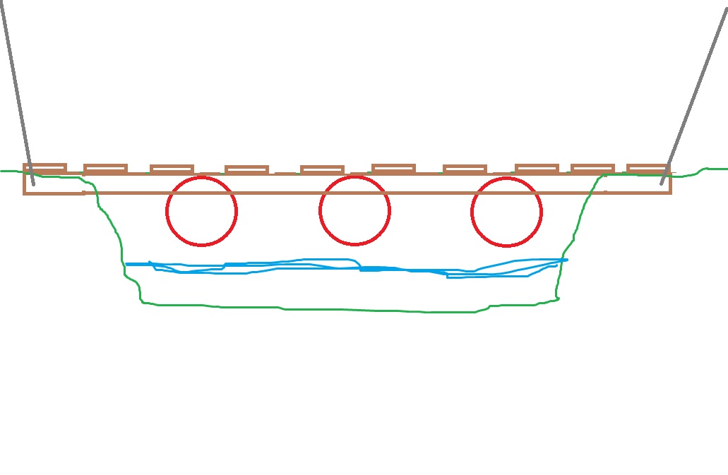

I want to build a bridge over a creek, it is about 40'-0" from edge to edge. Most of the year the creek is below the surrounding banks. But once maybe twice a year (depends on how much rain or snow melt) it does flood the surrounding areas but goes down within 2 days. I would like to make it 5' wide to drive an ATV across.
Is there any way to do this without having the bridge float away when the water floods the area?

Build a bridge that can float, a strong, pivoting anchor on one end, and just a rest for the other end. Let a large flood swing it.
this is kind of what i was thinking, not sure the barrels would allow it to float or not though, may be too heavy?
