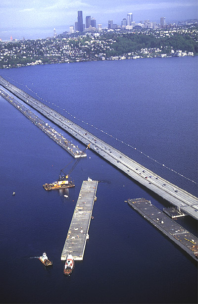

I use to build bridges for a living, this is where you start!:D
