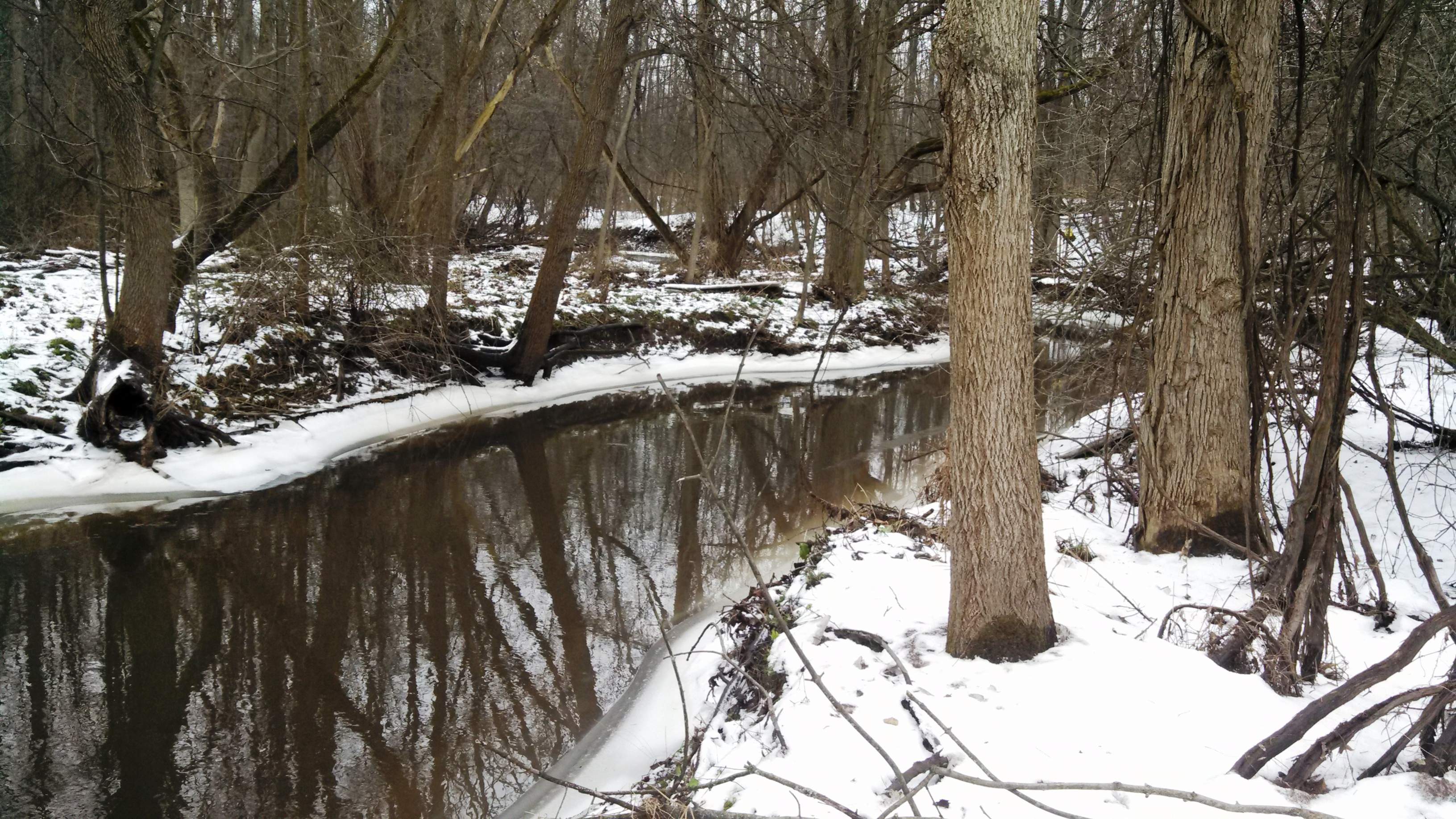

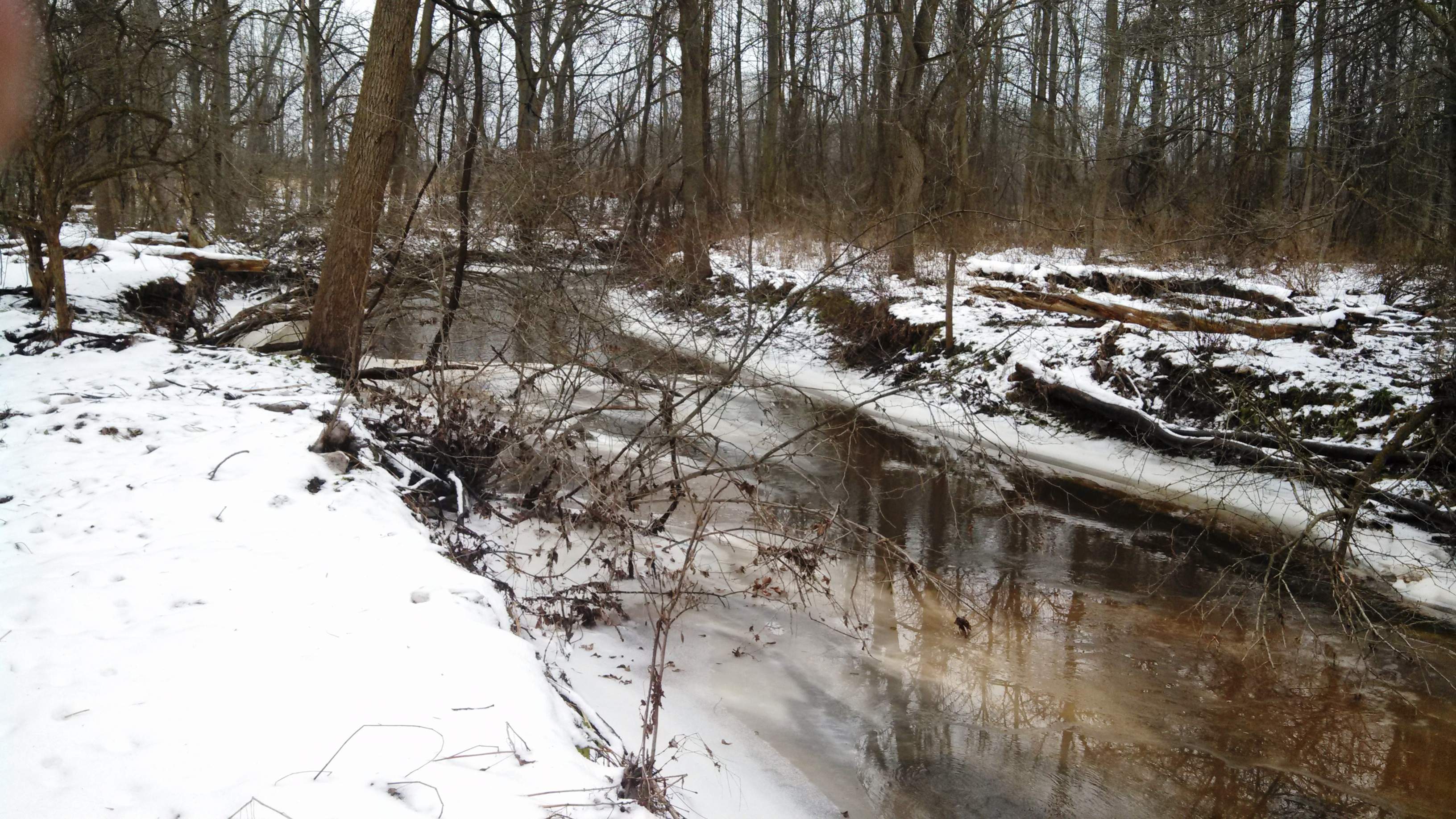

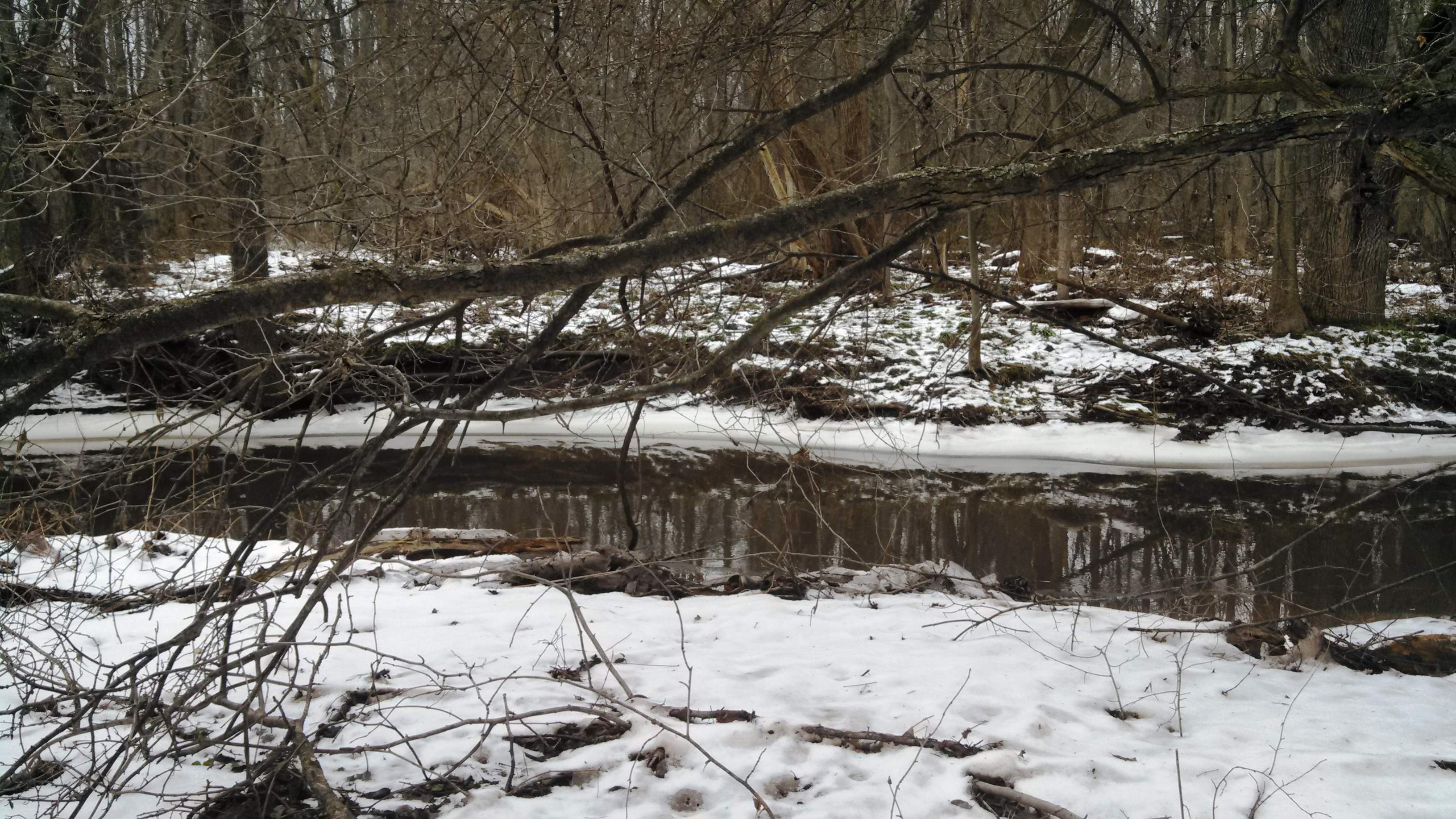

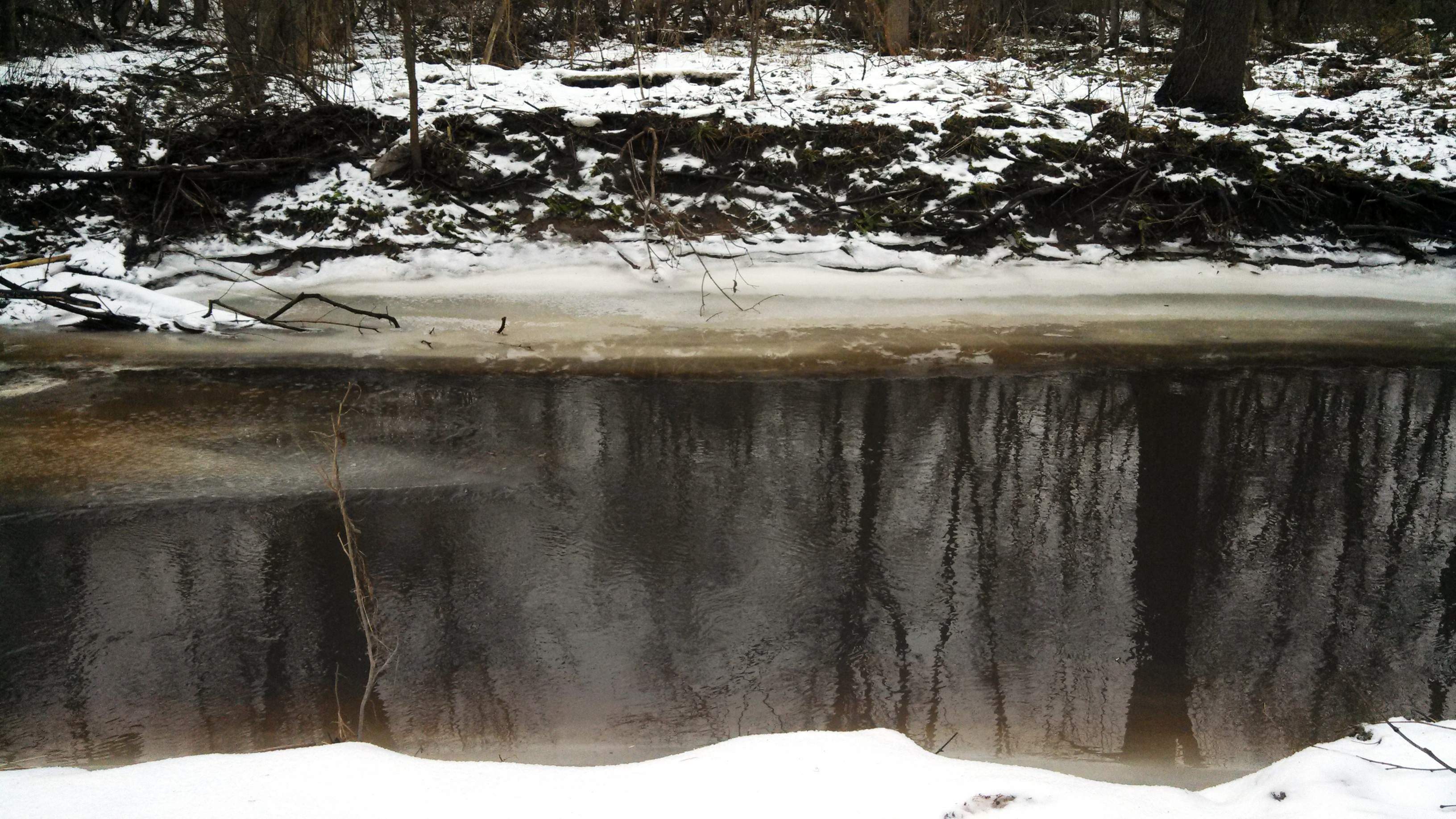

Here is some pictures of the creek, when it does flood it goes over the banks and i would guess at least 24" above the banks but this really depends on how much rain we get. First pic shows the down stream, second is up stream, third is one possible location for bridge, last is another possible location.

Answer the questions we have all asked and you will get some more and hopefully better ideas. Looks like there are plenty of trees to use to drag an assembled bridge across from one side. If dollars are a constraint then a ready made platform like a truck bed is your cheapest way to go. New materials are nice but add up real fast. Hard to visualize from your pictures what the 2' above the bank a flood will do with sills and approaches on each end. Speed of the water flow is the key element there. Can you get a contour map of the area? That will give a clue to how the flood water spreads out on each side. The bigger the spread probably the lower the water velocity. Fast moving water is very destructive and can put a lot of pressure on the sides of a bridge when compounded with the negative pressure created on the downstream side. A lot of engineering goes into building bridges.

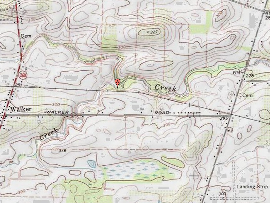

Contours:
Bruce
   / Building a bridge in a flood plain? #37
Great, now mark where you plan to put the bridge. Best place is where the contour lines are close together as that is where the water will spread out the least on each side and you do not need to elevate to clear flood water under the bridge; but that is also where the flood velocity will be the greatest. What is the spacing of the contour lines? Standard is 2' and 5' depending on where the map is from.
Ron
   / Building a bridge in a flood plain? #38
Looks like 5 foot interval on the contour lines.

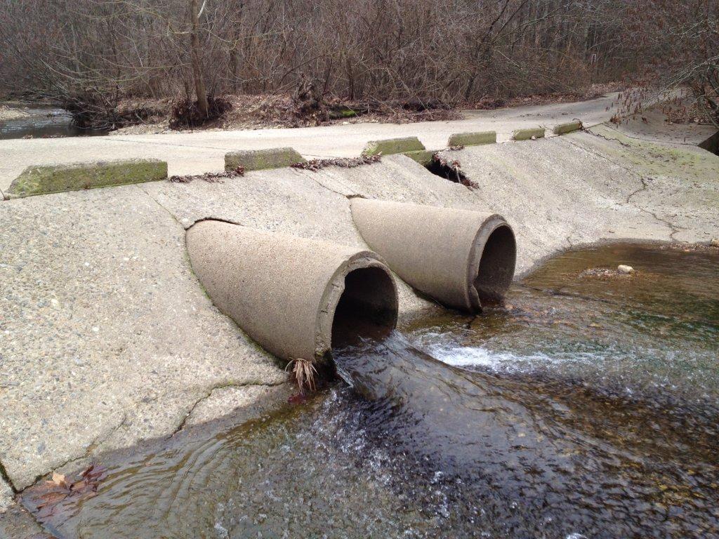

Low water bridge might be a good idea. Use as many culverts as needed for normal flow, let flood water go over the top.
