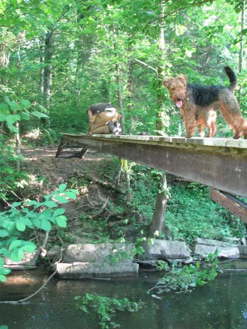

My creek is 35' bank to bank and the banks are almost 8' high. Seasonal flooding(winter) will see water over the banks in the place I built the bridge up to a foot. I used a 80' mobile home frame, and welded it in three sections so it looks like an open "U" which raised the main section of the span about 5' above the max flood stage. At each end I poured a concrete footer and bolted the frame to it, then made the approach out of gravel so it could be replaced if the water got that high and swept the gravel away.
I have not driven a wheeler on it yet because I have not reinforced it yet and I am pretty sure it would collapse. It needs two power poles sunk at each end and the sides of the bridge lagged or bolted to them. Then a cable run from a ground anchor up and over the tops of the poles across at about waist high with connecting cables running down to the bridge every 10' or so. Once this gets done I would have no problem driving a wheeler across. Some pic's:
