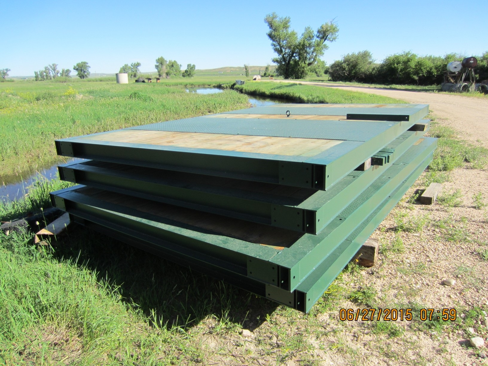

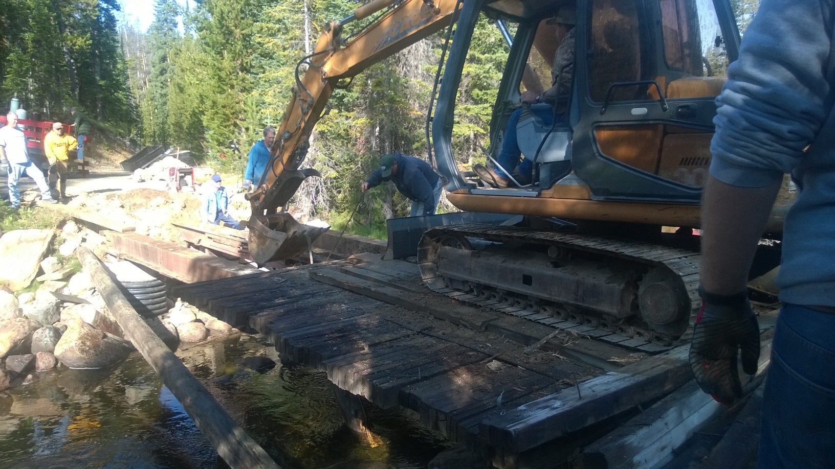

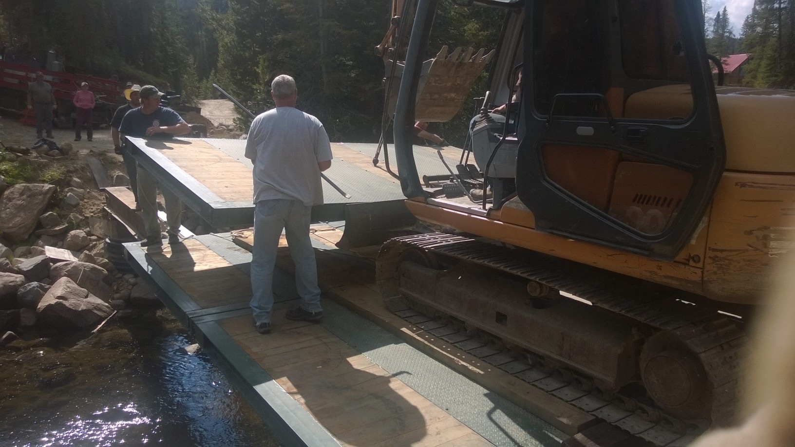

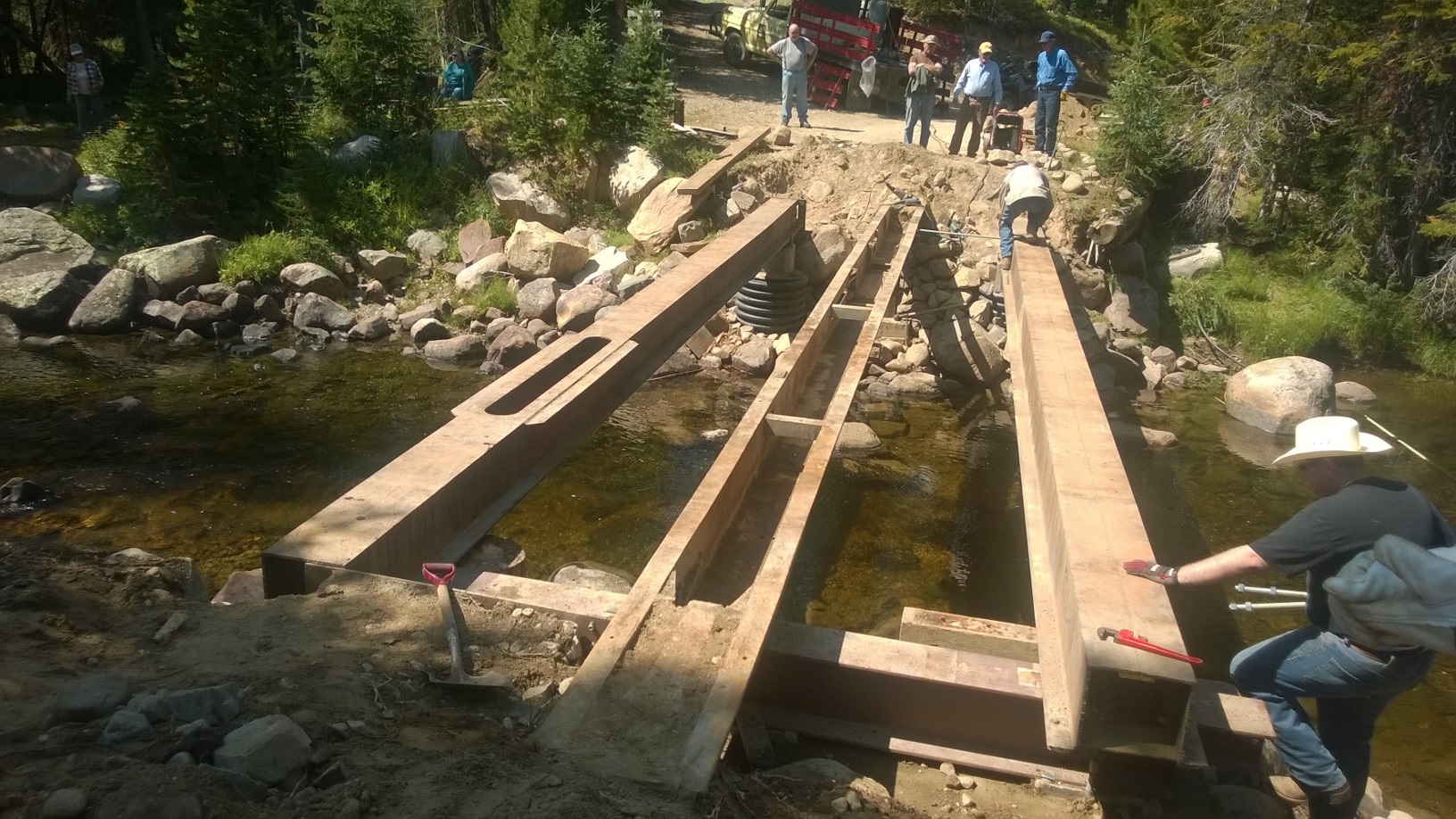

We had to redo the bridge at our cabin. There are about 20 properties that are only accessible by way of this bridge. THe beams are from a railroad car that crashed in the 1950's and repurposed. The steel has lots of nickle in it and even though we get 20 feet of snow some years, rust in never an issue. I wish we could get steel like that now...
One of the guys up there is a engineer in the oil field and knew about these rig mats used by oil field drillers. He had them made up for our purpose, width and length. These things are strong and durable. It was quite the job to remove the old creosote soaked timbers and shore up the abutments and lay the new decking. It's nice now though...
What ever you do, over build it and make sure your abutments are strong and stable.

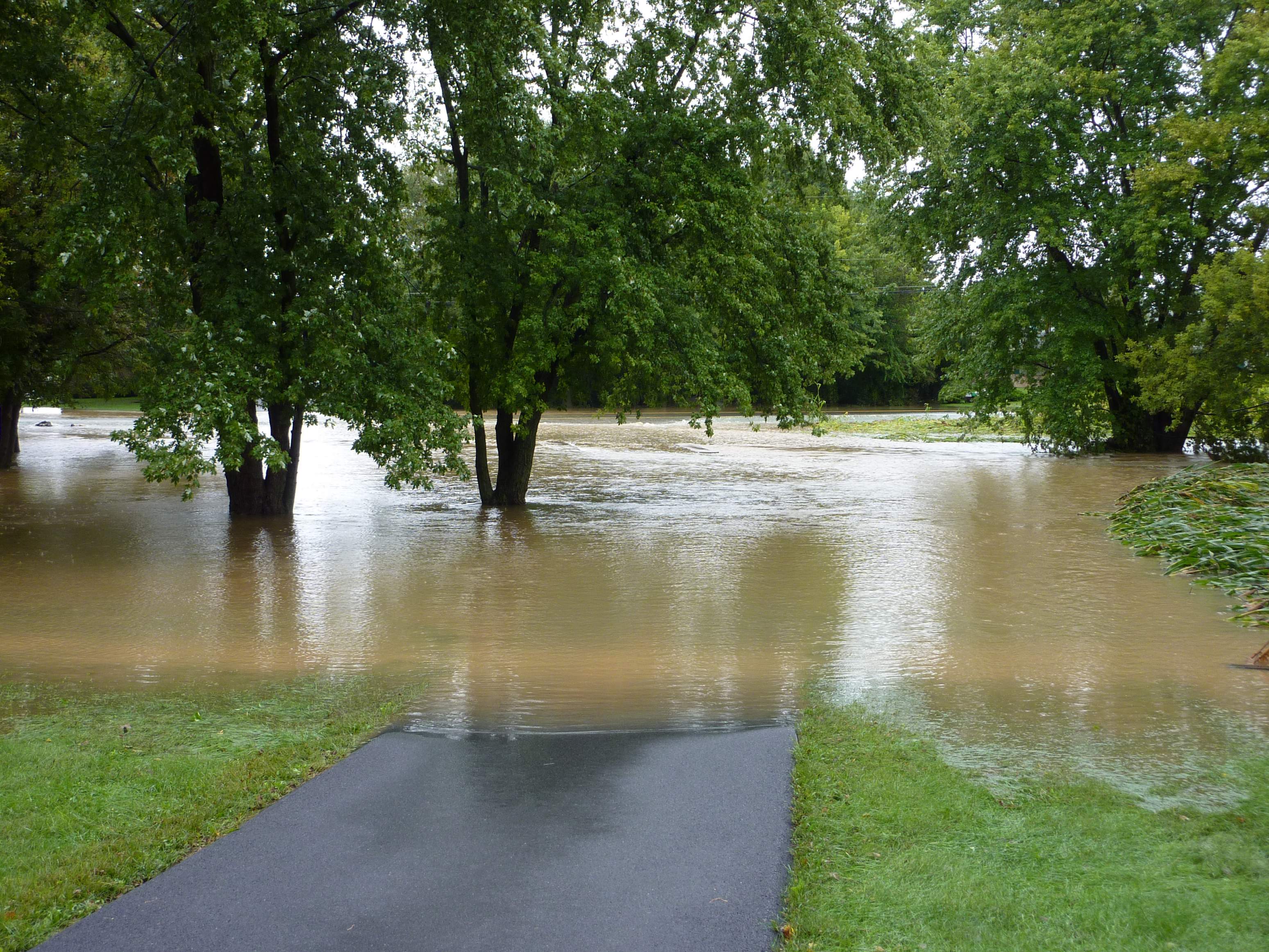

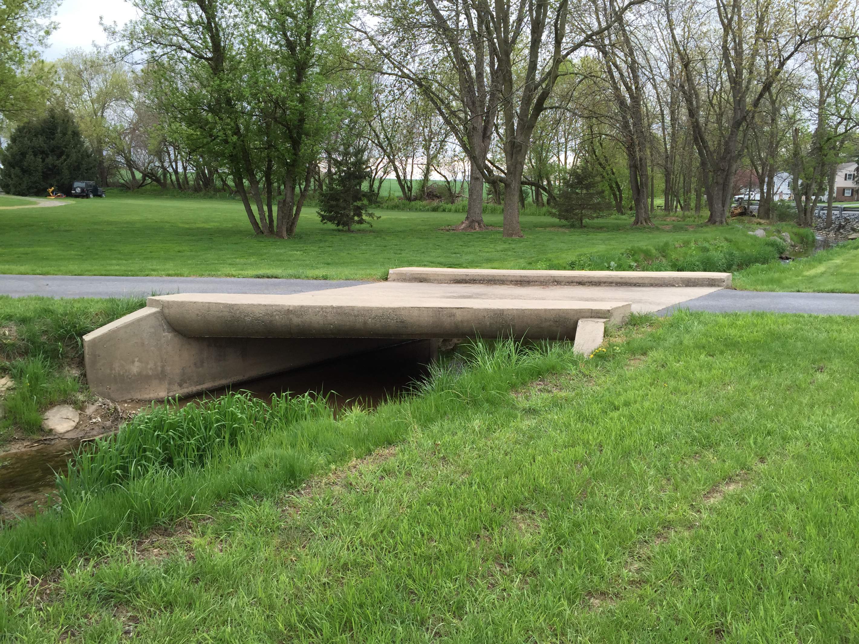

When we built here back in '89 I went to a real engineer and had him design the bridge. We had a temporary OK from the neighbor for the construction traffic to use a corner of his field so we could proceed with the work before the bridge was built. Part of the project included re-routing the creek (removing a large lazy omega-shaped bend). According to the engineer and DEP, straightening the creek offset placing the bridge in the floodplain. Did I mention the approval process took three years?
Anyway, it worked out well because we built the bridge on dry land and then re-channeled the creek to flow under it. I told the engineer I wanted a bridge that would be good for trucks in case we needed triaxle loads of stuff, or something bad happened and we needed a fire truck. I believe the footers are somewhere around 11 feet below grade.
The picture that shows the bridge is looking West, or upstream. The picture with the bridge hiding in the water is looking North during a high water event that happens about 2 or 3 times a year. The driveway curves slightly to the left after getting past the trees and if you look closely you can see the two sides of the bridge. At that level, the deepest water on the driveway is less than a foot. There have only been a few times since we built that we lost access. When that happens, it only lasts for maybe an hour or two. The worst that happens is I get to spend an hour or so gathering old soybean stems, pieces of cornstalks and someone else's firewood.
EDIT TO CLARIFY: Although this is the BIY area, the builder who did the house built the bridge. Since I've had some experience at work, I was thinking about doing it myself. When the builder said he could name that tune for $7K I told him to have at it. I had a price from one of our vendors of over $1K for the rebar alone. I had plenty do do in the house at the time - electrical, plumbing, HVAC, central sucuum, security system, etc. It was a busy 9 months.
