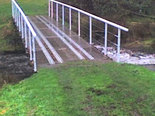

We bought a used flat bed semi trailer. 45' X 8'. Guy we bought it from delivered it and kept the axles. Pulled it across with a winch on our D4. All steel and aluminum as on the highway caarries 40k. Added a hand rail and were done.
This is the least expensive way to do it right. I might have to do it at night but in the morning it is done.

Cheapest I could figure out. Paid $2500 delivered for the trailer. Added a couple loads of 2" rock to sit it on. Back filled to the rock. Then the hand rail. I will add a picture tonight when I get home.
