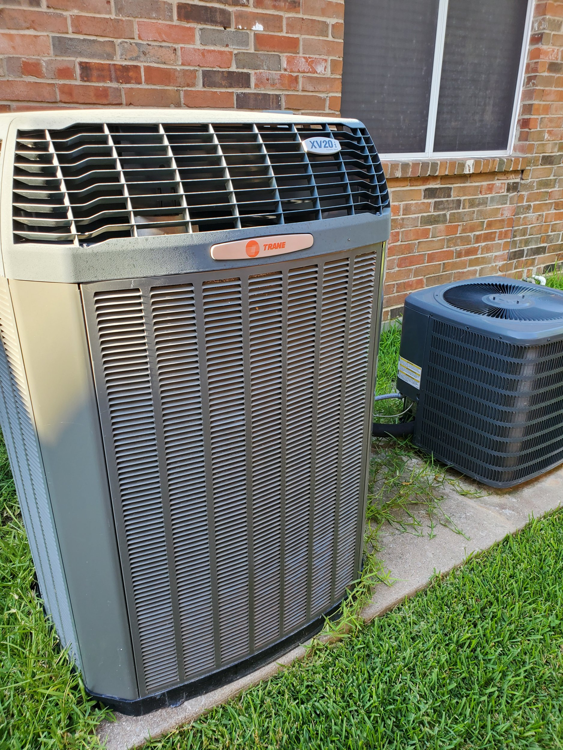

We had a Trane put in as our main system in our house in the DFW area. I want to say it is an 18 seer? The important part for is and that on would highly recommend is the variable speed fan. It barely seems to be running and still keeps it comfortable in the Texas heat. Saves us a bundle on electricity. It is especially good on those days when it is humid, but not too hot. The system still cycles on low power and keeps it comfortable. The older systems were either on full blast or off. On warm humid days it would be sticky because the old system only kicked on once in awhile.
