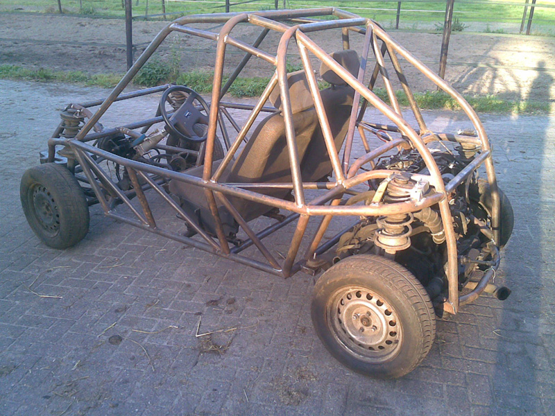

Seems that your exhaust pipe exits below your frame. That will definately get damaged. Any way to route it up higher?
Doug
   / building a dirt buggy
#32
Yes, the original exhaust downpipe goes below the subframe under the floor of the car.
I bolted the first muffler off, the elbow above the rear axle rotted off on its own, one of the reasons i bought a new car and use this one for fun.
Anyway, there is no chance to re route the pipe unless i make a new downpipe/manifold behind the turbo. Its a cast iron piece that collects both the mainstream exhaust flow, as well as the flow from the waste gate into 1.
I need a straight tractor pipe sticking upwards, but as long as i dont have everything else installed, no need for an exhaust anyways... It's going to be one of the last things to be done.

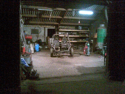

Some photos of yesterday:
photo 1 shows the work so far: seats mounted, and a lot of struts and crossbars added. Now i need to weld some strips against the pipe to bolt the plywood floor to, and i want to make a mid tunnel to mount the gearstick to, and run all the cables underneath.
Photo 2 shows the workshop after i added 2 500 Watt halogen lights: As you can see from previous photos, my workshop was a dark cave. It's amazing how much light 15 Euro worth of Halogen lights can give !!!
I just need to screw them to the roof beams in the highest part, so that they only shine their light down: When i put them to the wall and aim them at 45ー the lamps are still to bright in the edge of your eyes to work properly...

Renze, I'm glad to see your going to have some fun. Not to pour cold water on it but... I think your tube frame will rack and don't you need some triangularization in the corners in the horizontal plane?
Not trying to be spoiler of your fun but I have spent years playing in tube frame rides off road in Baja California, SOCAL, Arizona etc. (Would you believe we even have a little set of desert dunes called Little Sahara hear in Oklahoma.) I have seen an awful lot of frame failures in home brew rigs and not nearly all of them were welding problems. They were design problems. If you can get your hands on a copy of "Sand Sports" or a similar magazine you could see many examples of tube frame off road fun cars. Here is their URL:

i'm taking it step by step: the triangularisation in the floor and roof will follow, but i have to work out the previous steps first.
Actually i want to add 2 slide rails of 1x2" square tubes underneath, to make the belly slide easier over the hills and dunes in the bush.

Renze, If you have enough fan power you can tilt the radiator quite a ways, even horizontal and have a decent sized radiator up front but not obscuring too much view.
Skid plates under everything that can be harmed by impact with dirt, stumps, rocks and such is a terrifically good idea.
Now that I have seen pix of the more completed car, it is looking much much better except for the skinny little undersized tires. You can go narrower up front to get some bite to help turn it but you need more tire in back.
From the safety aspect I recommend at least some decent 5 point harnesses and good helmets. If you don't put canvas or sheet metal or something on the sides to keep body parts in during a roll over you invite trouble. Expanded metal (not too big of holes) is good as dirt will always find a way in to the car but will fall out through expanded metal. It is good to have at least some expanded metal in low areas to avoid collecting sand and dirt.
