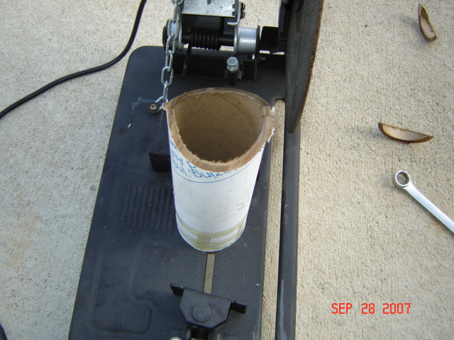

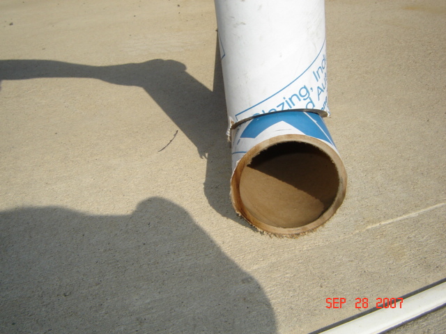

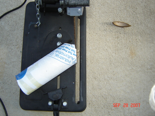

How to fishmouth a tube with a chop saw:
To make a 90 degree tube to tube fishmouth set your chop saw around 35-40 degrees. Align the end of the tube so your cut ends at, or just shy of, the center of the tube, & cut. Rotate your tube 180 degrees, align so the end of the cut is again at, or just shy of, the end of the tube, & cut (see pic #1). This will give you the rough fishmouth (see pic #2). Some minor grinding of the inside of the "points" may be necessary for a tighter fit. When finished, your tubes should fit together as shown in pic #3.
To make a fishmouth at other than a 90 degree angle, the inside angle will need to be increased & outside angle decreased.
Note: A 4" shipping tube was used for illustrative purposes.
