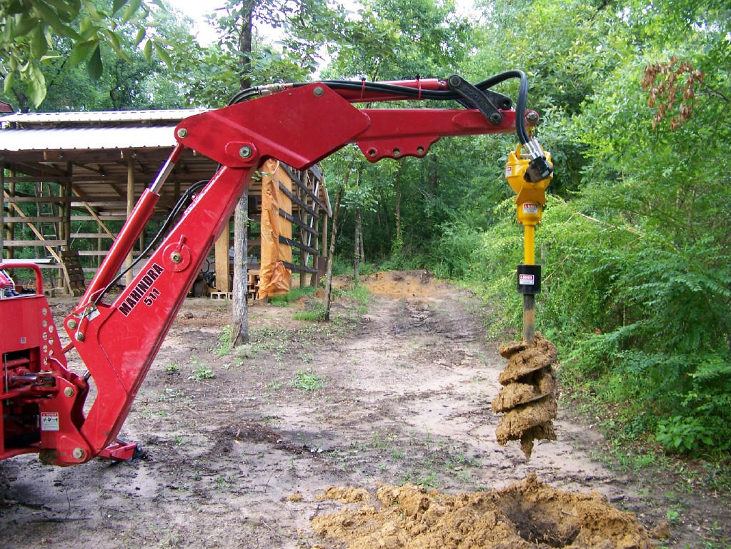

Hydraulic auger on your backhoe. All you have to do is cut your bucket curl line and add fittings and QDs. Run the auger with the bucket's curl and dump lever. 5-27-07 PHD Ops Ck.jpg
