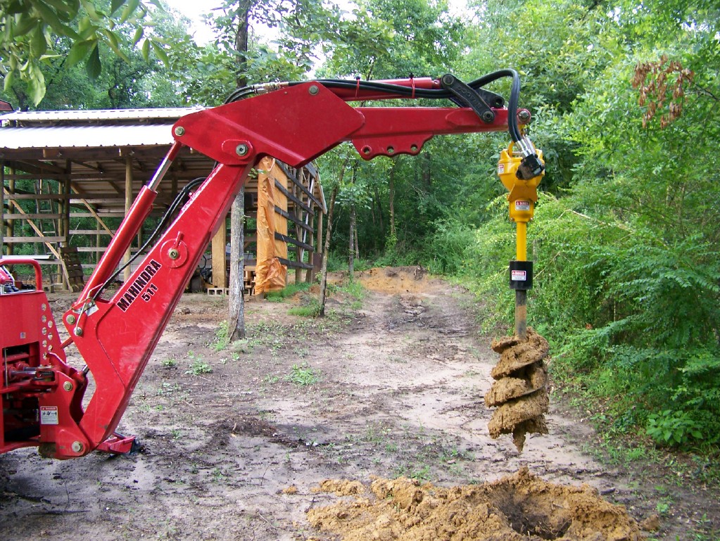

Hydraulic auger on your backhoe. All you have to do is cut your bucket curl line and add fittings and QDs. Run the auger with the bucket's curl and dump lever. View attachment 423235
hugs, Brandi
You definitely have the "Cadillac" set up for post holes. The only thing that might be better is a radial arm digger with a boom tip mounted winch like we used on the crew when I was building power lines.

As for the auger on the end of the BH, would it be preferable? Probably, but it's also a lot more work than just throwing on a 3 point auger, and again, I'm in the unique position (for my area anyway) that my land is flat.
