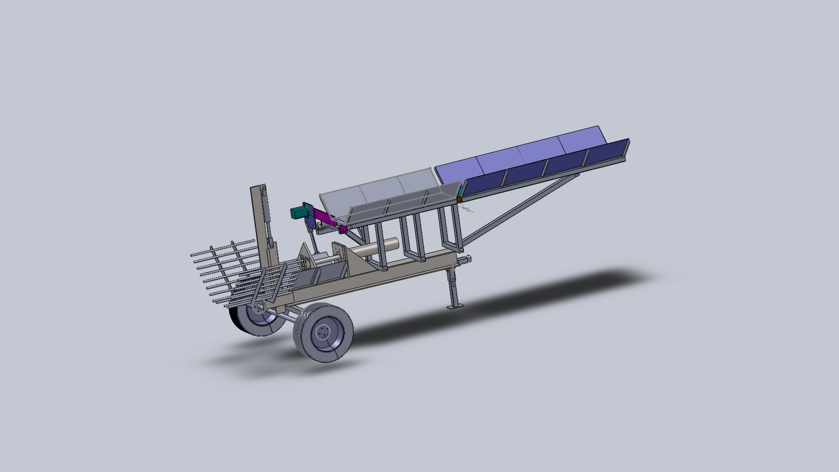

Heres a quick sketch of what im planning, but the more i think about it, im likely going to keep it simple and just build the split section with the adjustable wedge, then i can add the processor when i round up cheap parts.
That Parker F11-iP saw motor can defend its 2000$+ price on a 150000$+ harvester head, but not on a low budget firewood processor...
Have you ever thought?? about the option to use the return stroke from the splitter to feed the log forward into the saw cut position.....using a reverse pivoting linkage....and that way save from using another another function (feed motor)....
Together with a up sized gas chainsaw, you would have a low cost, fully functional processor operated with one single spool valve....
..."make it simple is a challenge too..." and will save 1000$+ in hydraulic hardware...

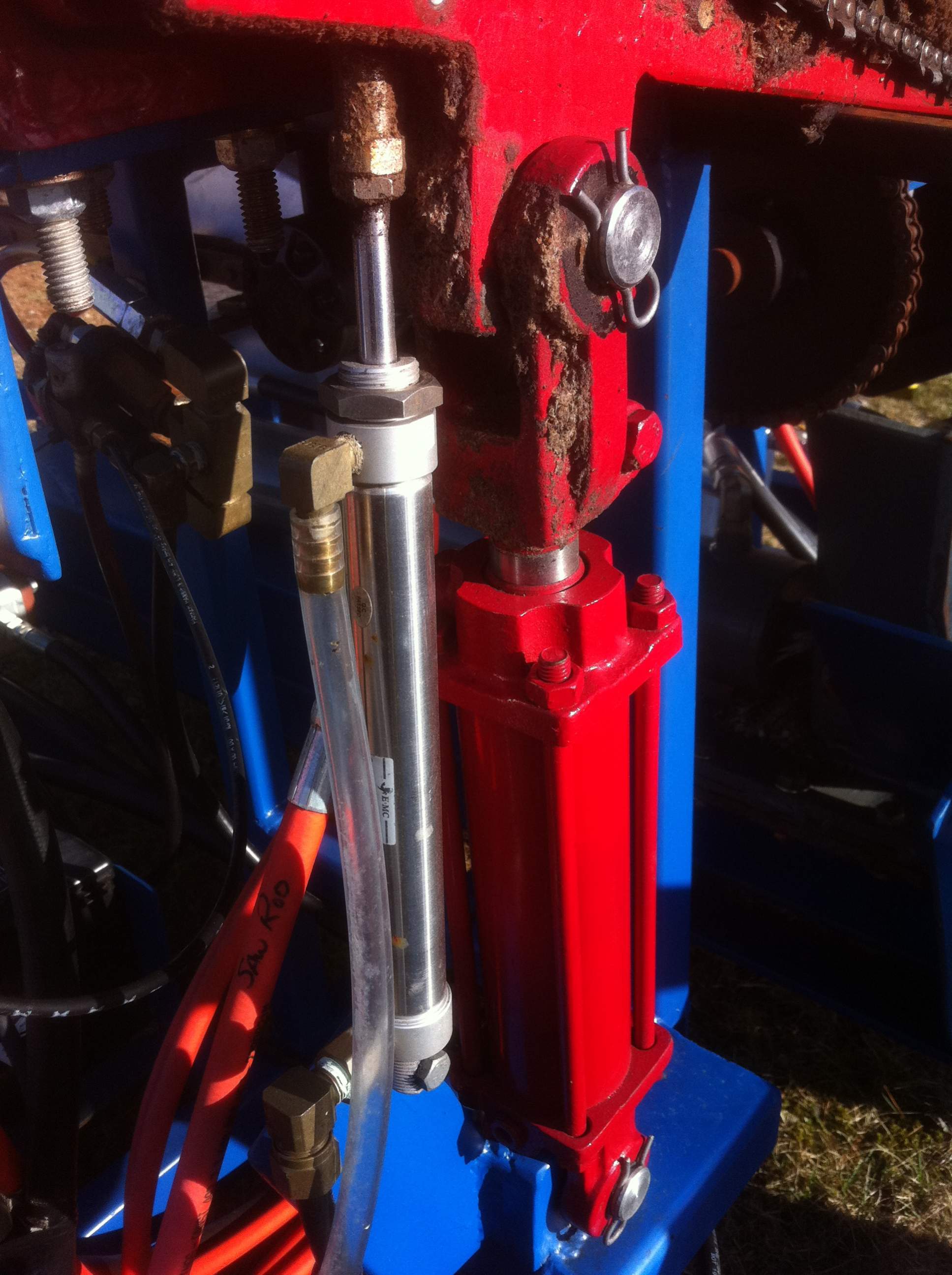

glastron how did you build the oiler? and how much oil does it go through

Sorry for not getting back sooner.. was in NFLD and was not able to take pics...the first pic is of the silver air cylinder (princess auto) attached next to the saw cylinder.. as the saw is stroked to the up position the oil is sucked into the bottom of the air cylinder. when the saw is dropped into the wood the oil is then forced to the chain through bars lube channel. The top clear hose is just vented.
The second pic is of the check valves (3) and the flow regulator. on the bottom check, the oil is drawn from the oil tank ( 4 liter jug ) on the left side (clear tubing) this check is a 5psi and flows from left to right. The oil then flows to the cylinder via the large black air line in the center right tee fittings. As the saw is lowered the oil is forced through the center check (5psi) from right to left, into the flow regulator ( this adjust the amount of oil going to the bar) to the bar via the small black air line. The top check valve (65psi) dumps any oil that is not used for the chain back into the suction hose from the oil tank(flows from right to left). we installed a check valve right at the bar to prevent oil from running out the hose when not in use.
we use about 4 liters every 12 cord, but this can be increased or decreased as required, our chain is only turning when it is not stowed. Jim

If you want to make it even more simple, you can use the return pressure from saw motor, and divert hydraulic oil for lubing the bar...this have been used on harvester heads and feller/buncher saws....Appropriate bar oil have better lubing properties, so with hydraulic oil you need to increase volume a little bit, 25% or so, (needle valve)....usually one use more bar oil than needed....volume also depends on length of saw cycle....keep chain sharp reduces wear....
edit: Bar oil is cheaper than hydraulic oil though...

Thanks AKKAMAAN good idea.I think that works for me.Cheaper than buying check valves and an air cylinder but that is a good idea to:thumbsup:
