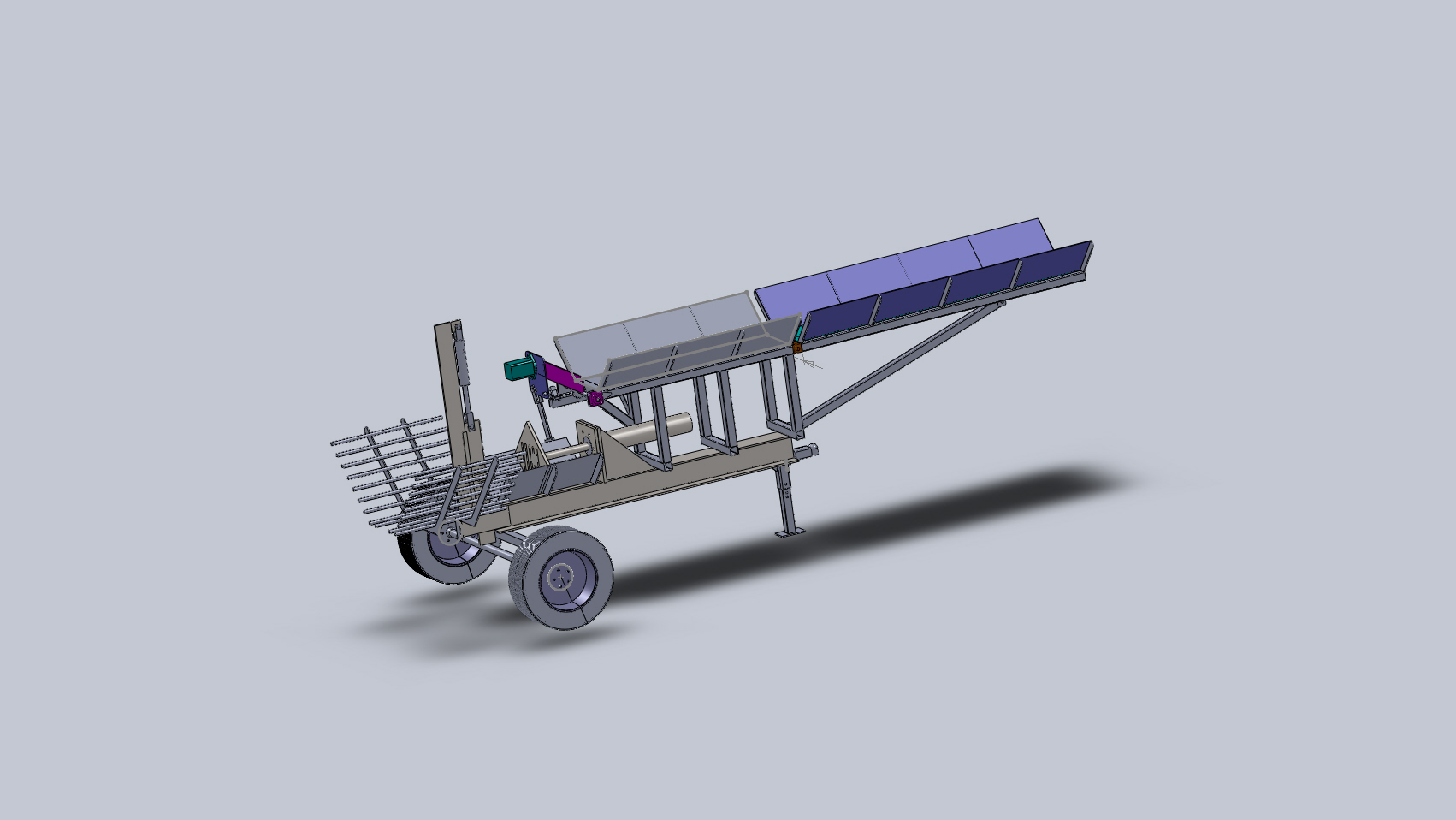

Heres a quick sketch of what im planning, but the more i think about it, im likely going to keep it simple and just build the split section with the adjustable wedge, then i can add the processor when i round up cheap parts.
That Parker F11-iP saw motor can defend its 2000$+ price on a 150000$+ harvester head, but not on a low budget firewood processor...
Have you ever thought?? about the option to use the return stroke from the splitter to feed the log forward into the saw cut position.....using a reverse pivoting linkage....and that way save from using another another function (feed motor)....
Together with a up sized gas chainsaw, you would have a low cost, fully functional processor operated with one single spool valve....
..."make it simple is a challenge too..." and will save 1000$+ in hydraulic hardware...
