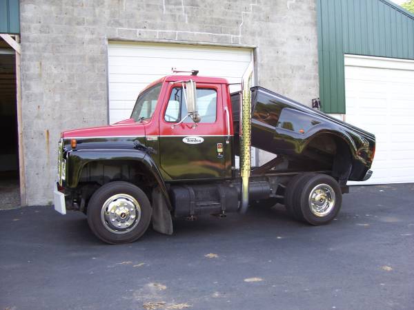

Here's a local truck for sale I was considering to buy but went a different route.

They sure look good with a short wheelbase and P/U bed on them. Mine was a long frame truck that I cut a chunk out of the frame on to shorten it.

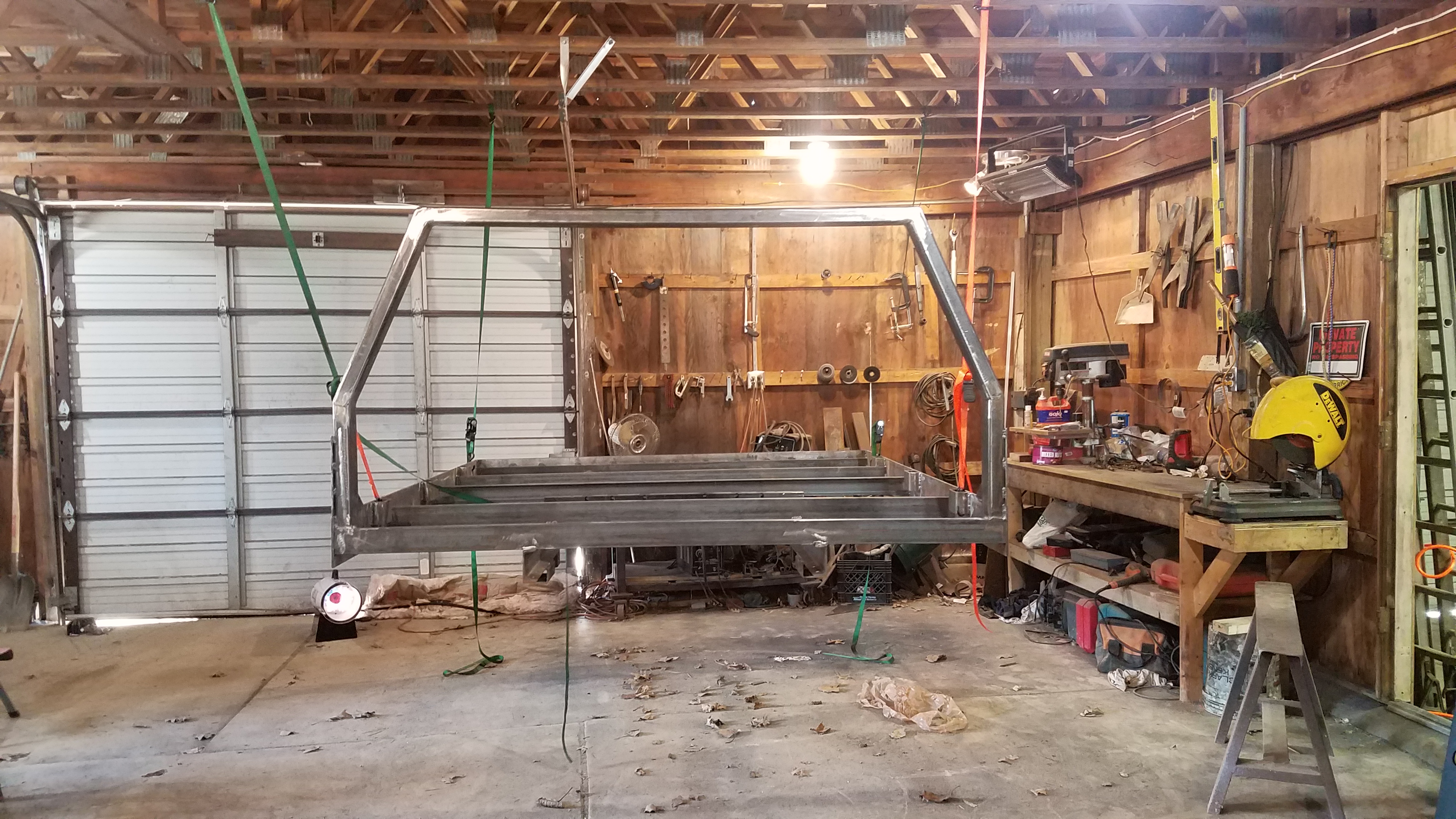

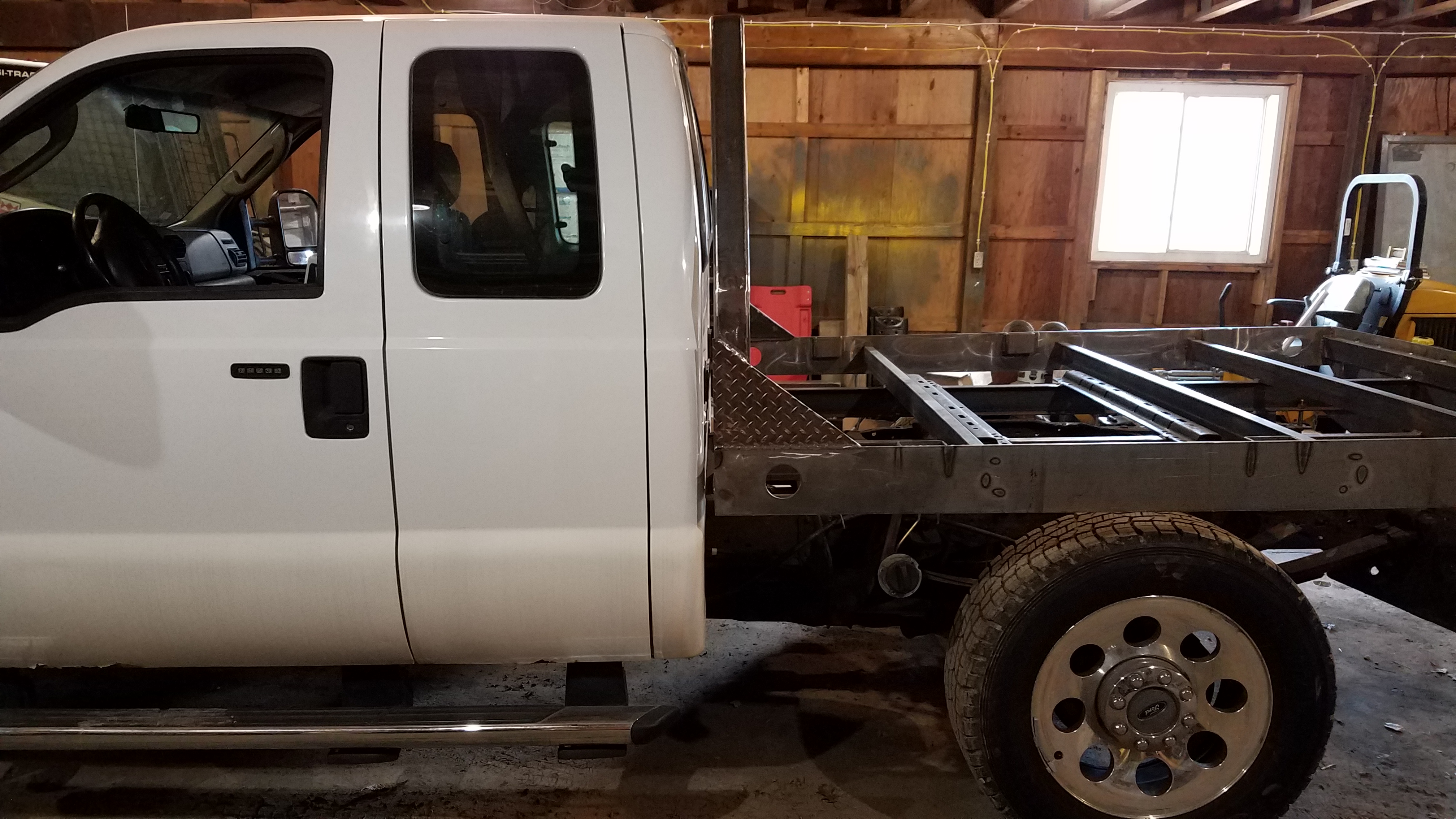

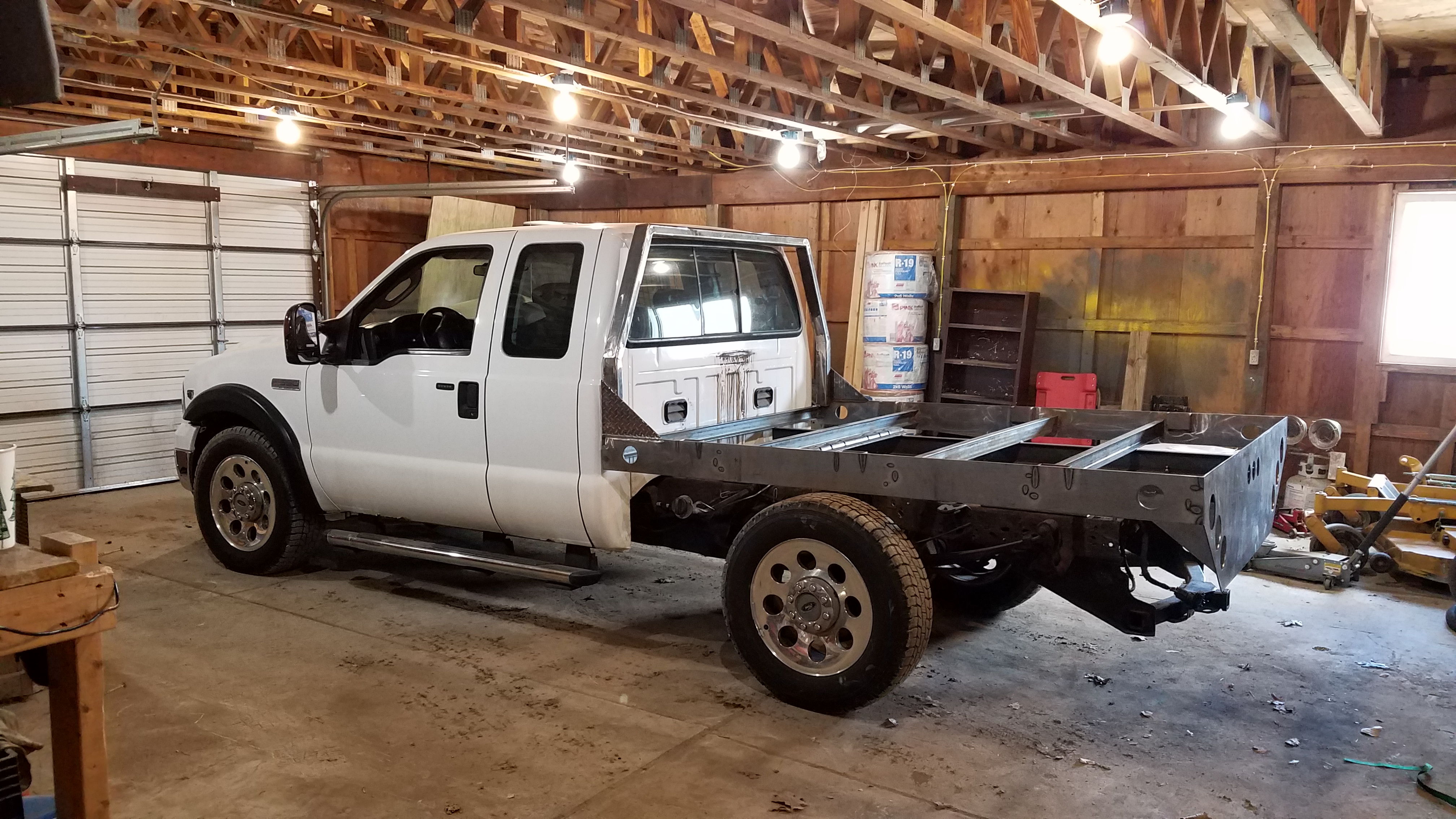

Finished the bulkhead outer framing (still need to attach the front plate material and inner cross member)
Figured it was time for a test fit.
Now need to make provisions for the fuel filler ... Thanks for pointing that out, it does need some adjustment.

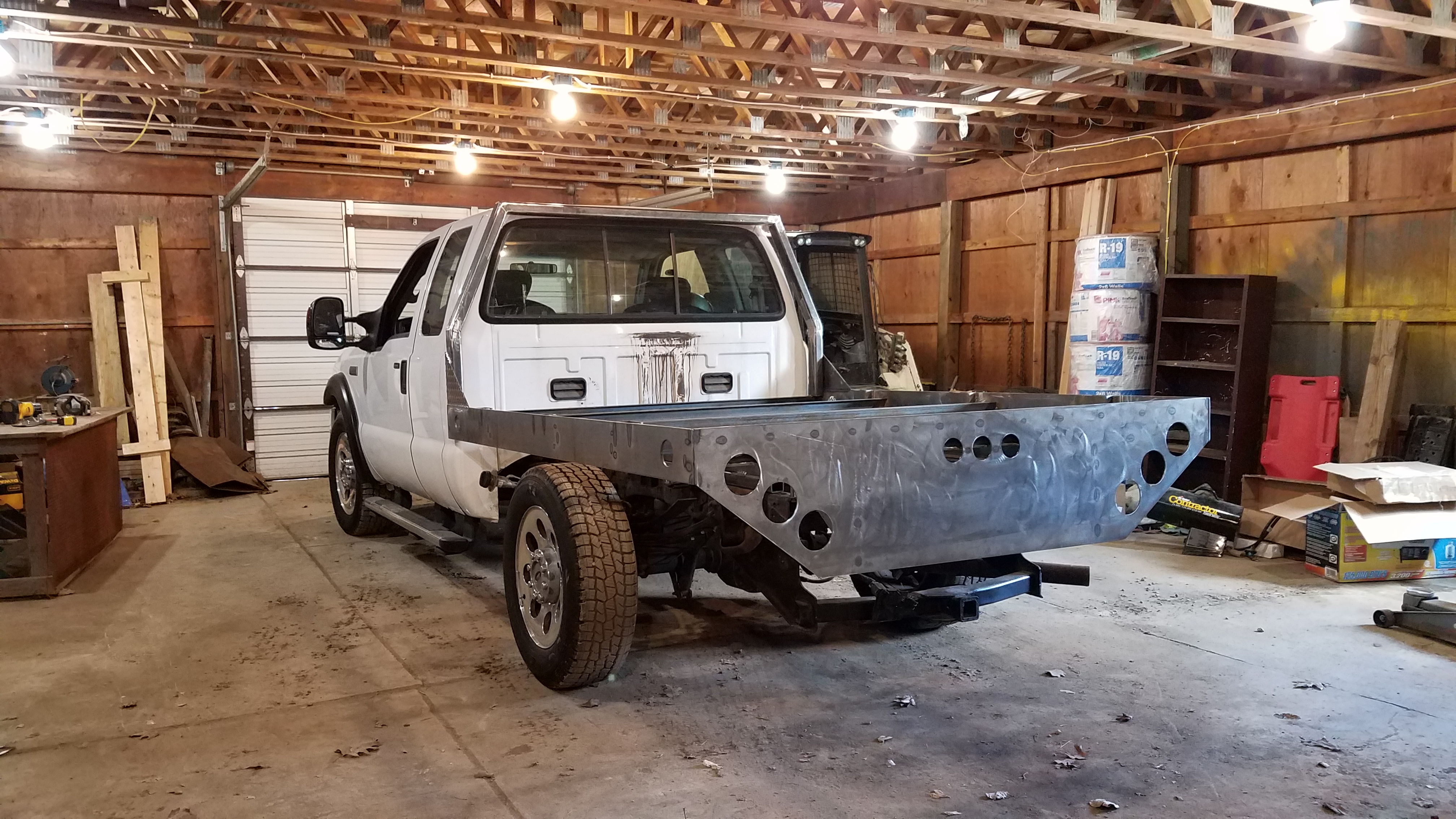

   / Building a flatbed for my F350 #58
That looks great so far!! What kind of wood are you going to use for the bed?? Oak, PT 2X?, or maybe marine grade plywood sheathing? I am guessing you will be painting it black?? I notice it looks like you added some stake pockets that are welded on the inside of the outside frame rail, is that right?? If so, NICE touch! Also, I would consider adding some rear facing LED lights on top of the headache rack to light up the bed when you're working at night, and maybe weld some guards over them for protection, so they won't get knocked off by limbs, etc. And while you're at it, I would custom install a rear view back up camera, just for the finishing touch. I like spending other peoples money lol. Keep up the good work, I'm anxious to see the finished product!
#59
Thanks. I'll be using treated pine, 2x8 or 2x10. It's a work truck so that'll be the best route, allows for cheap and easy replacement boards when needed.
I'll take the lighting suggestions under consideration.
   / Building a flatbed for my F350 #60
If you're using PT, a lot of the modern treatments promote rust like crazy.
On the last project like that I did, I used rubberized roll flashing like they use on doors and windows to put under wherever the boards would touch. Time will tell if it actually helps or just eases my conscience, but I rest better knowing it is there...
