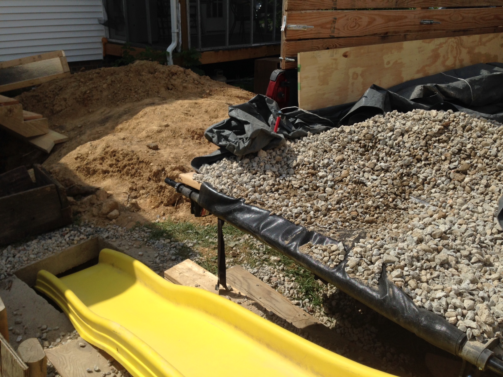

I use my F350 routinely for gravel and mulch and have found that the Loadhandler type belt and crank works great
Works even better when my son provides the power:)
I ended up buying the additional pad so it slides off even easier.

Then I guess you should have shown us a pic of your F350
The second pic shows the rear of my F350 after a partial unload.
Do you need complete diagrams?
The first pic was from the link I gave.
What difference does the pic make?
My point was that although a dump is often desirable, for the small loads (< 3,000lbs) there is another inexpensive alternative for rather easy unloading with some muscle.
We unloaded about 5 "bedfuls" of mulch, sand, gravel manually with a shovel before I bought the HF load handler and I was surprised the load handler would work so well.

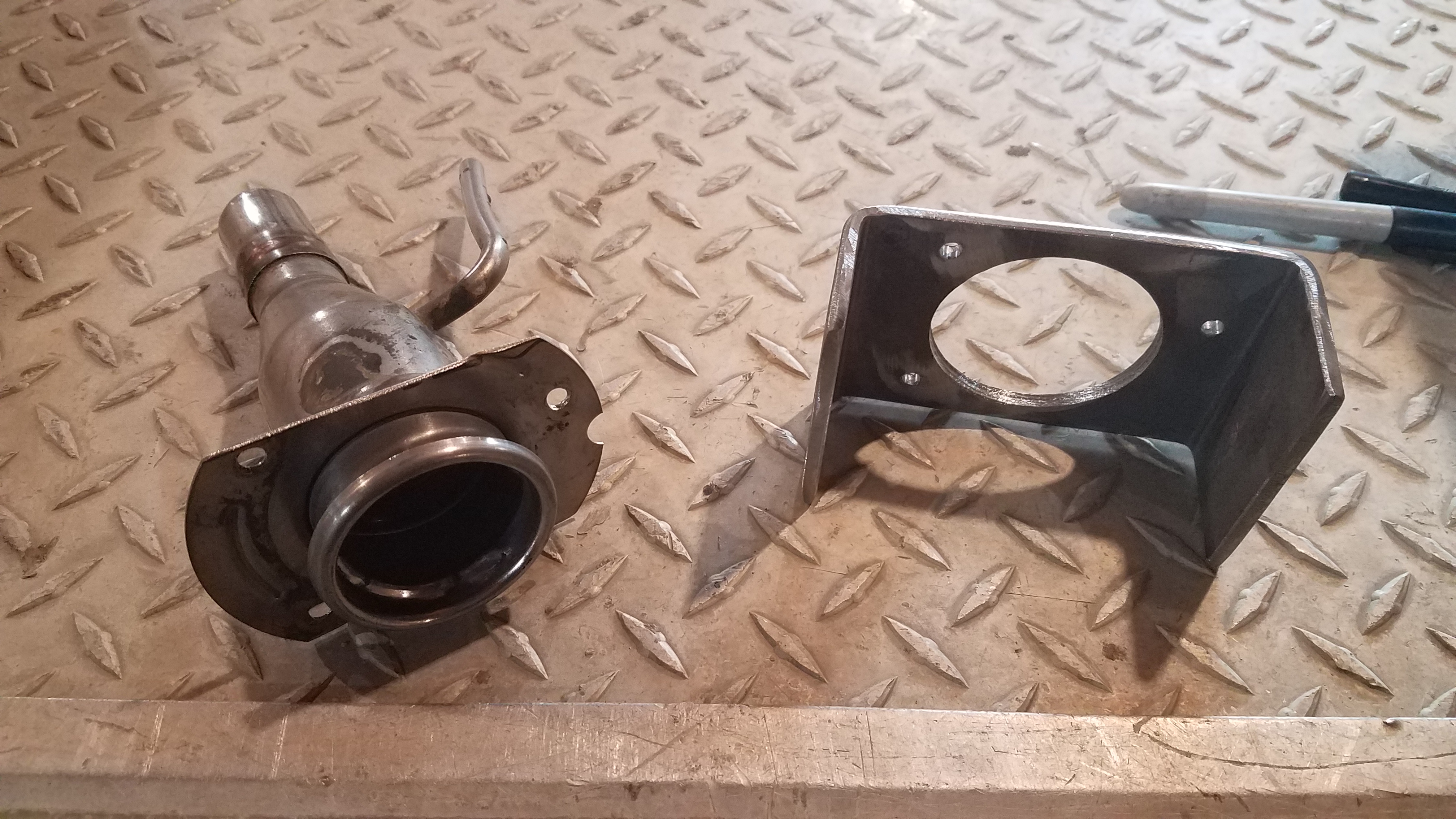

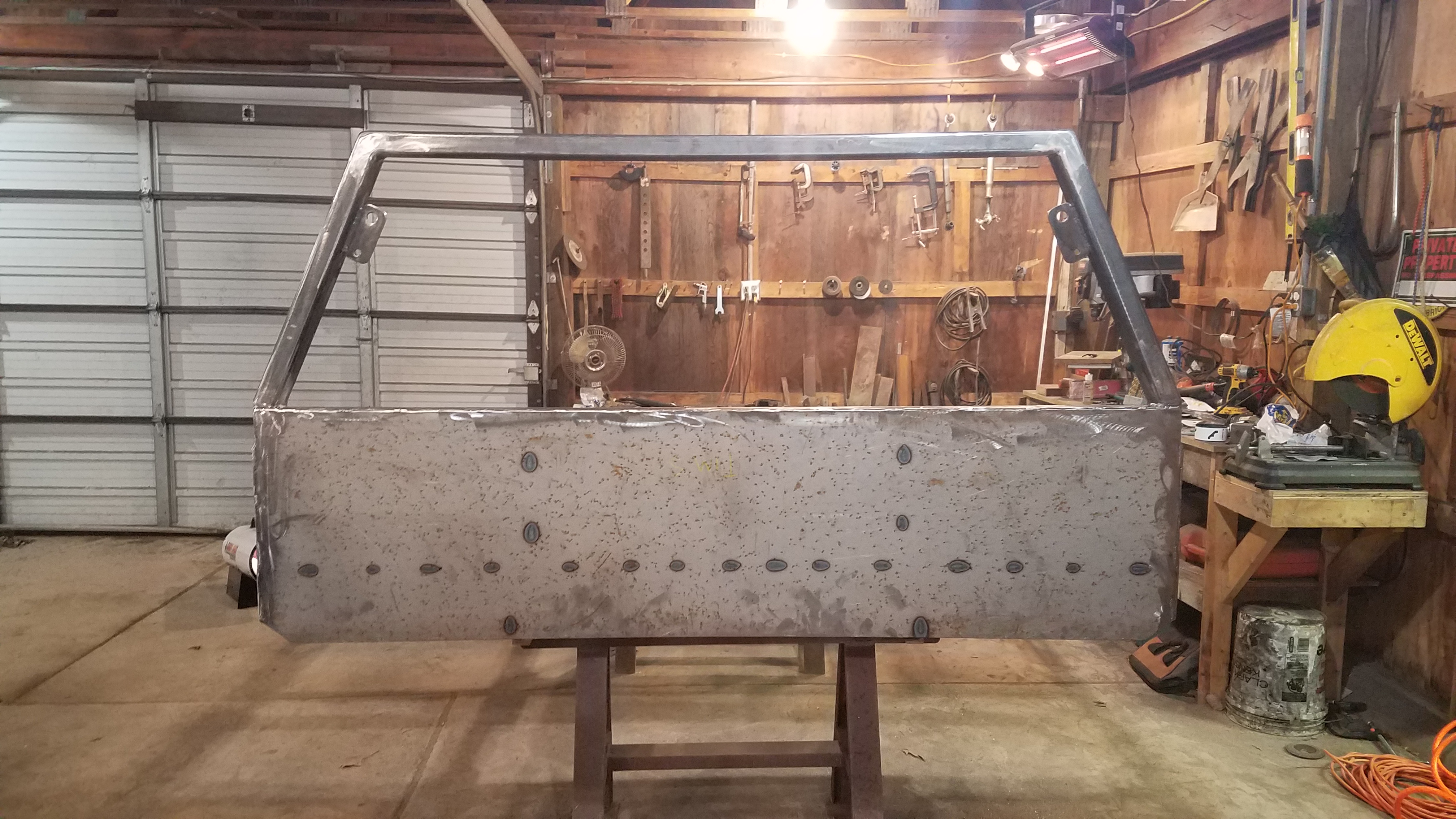

Some updates...

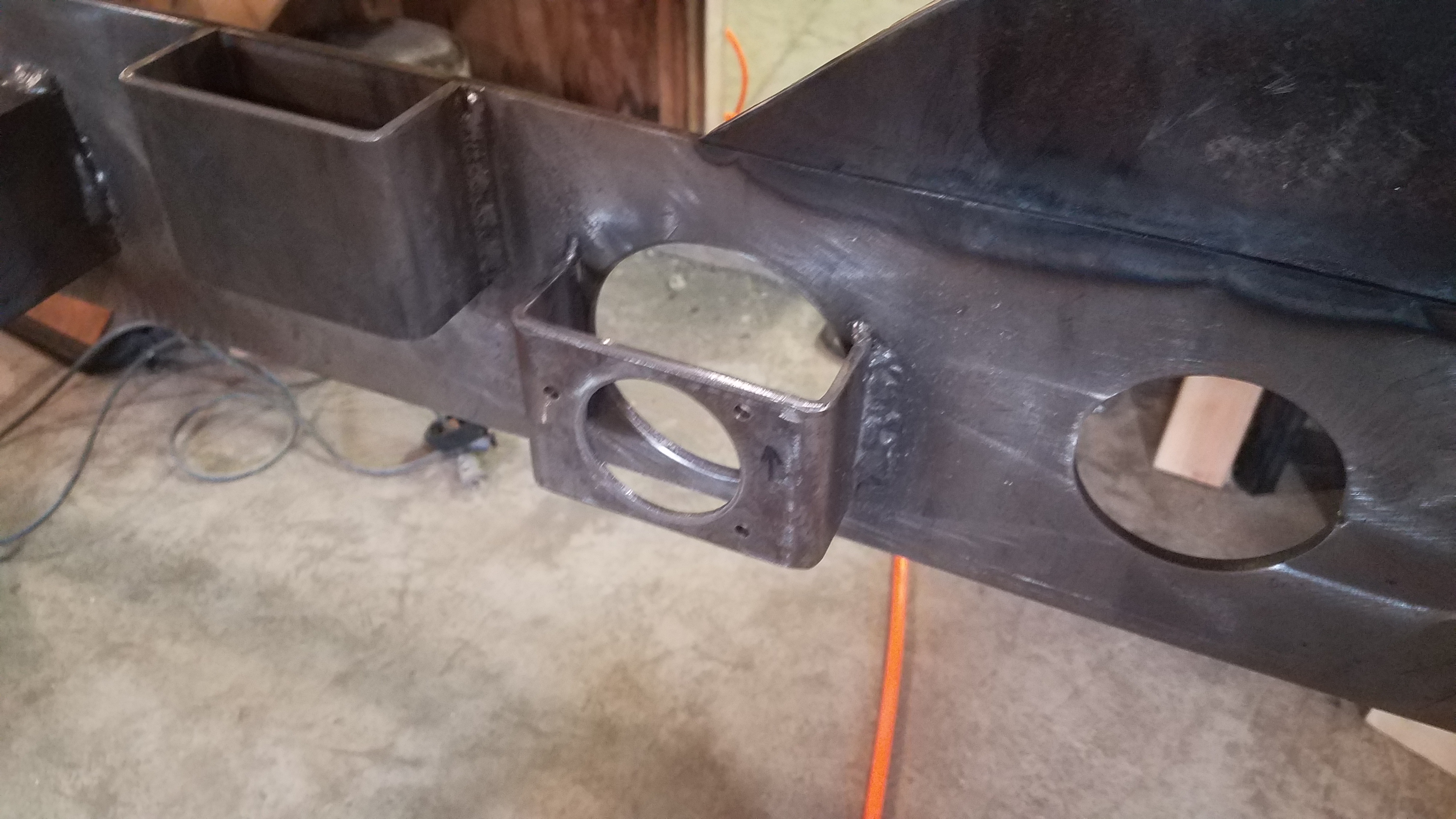

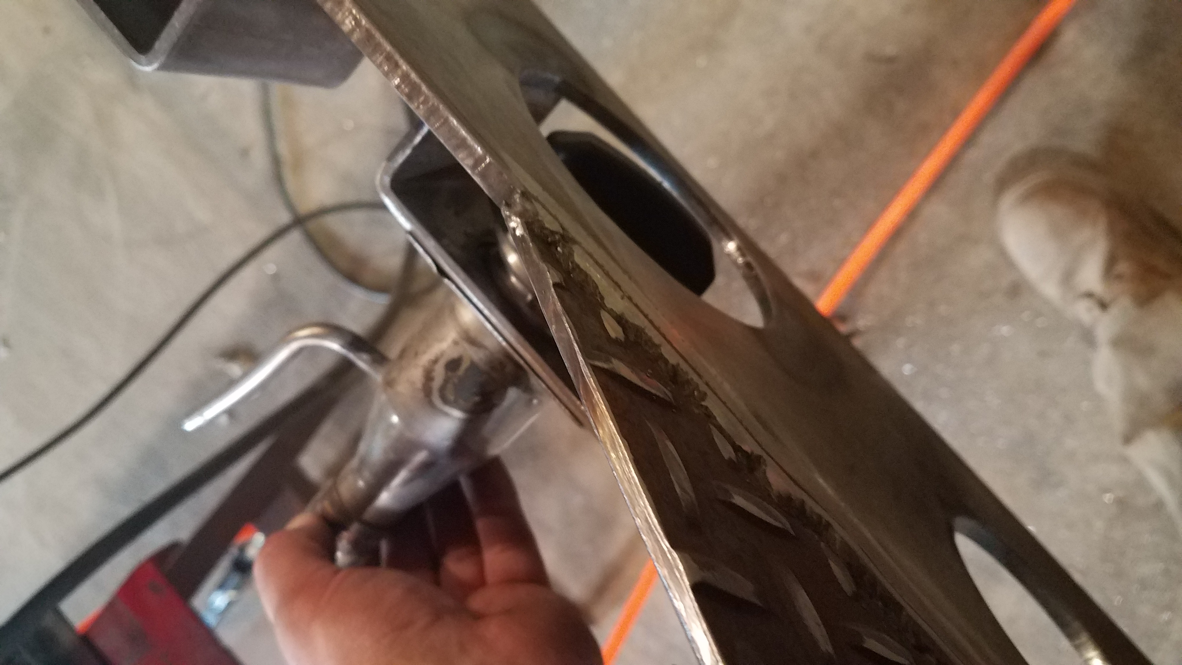

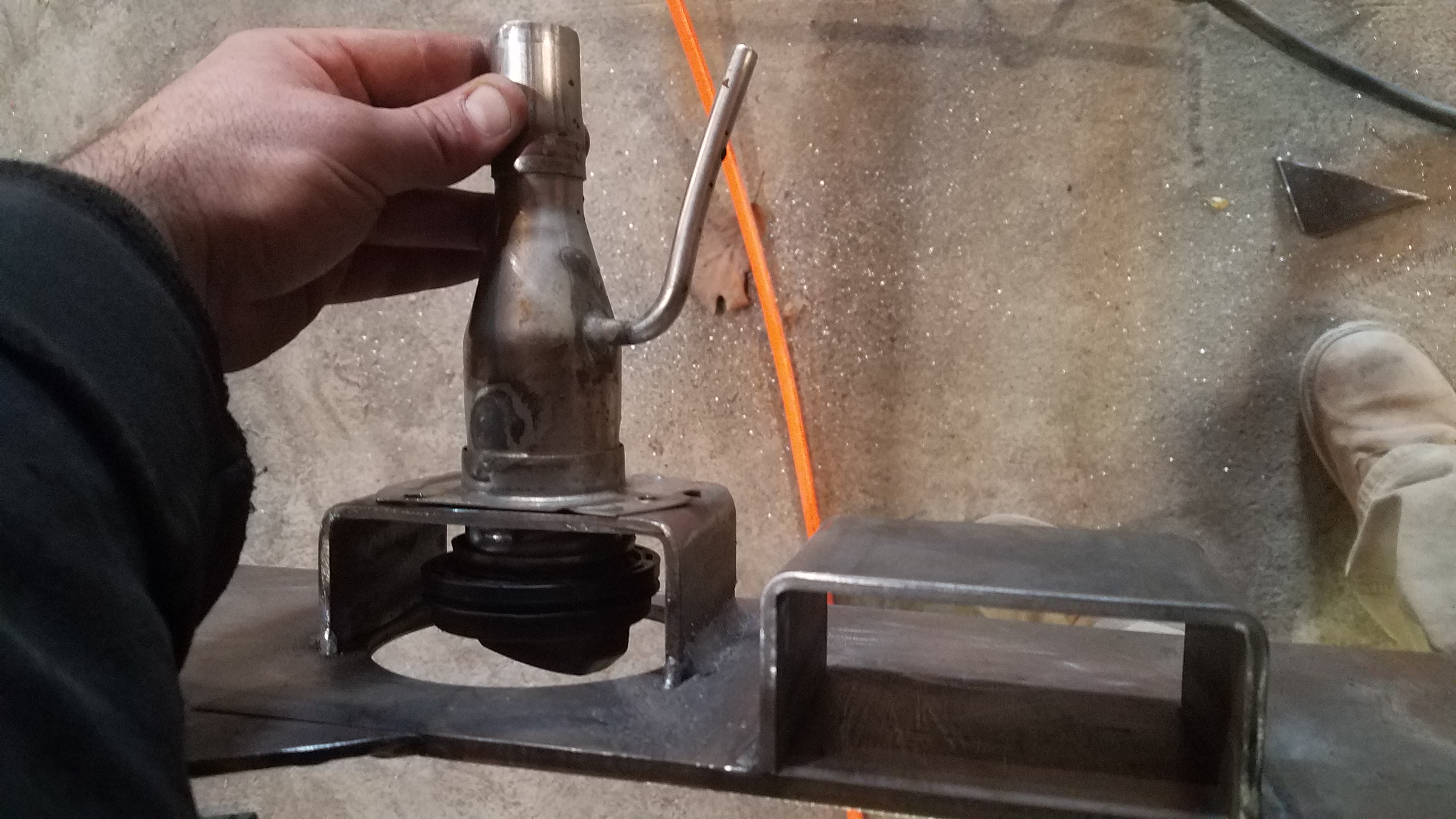

Here's the solution to re-locating the fuel-fill neck. I mounted it thru the side-rail, and the cap sits flush with the outside of the rail.

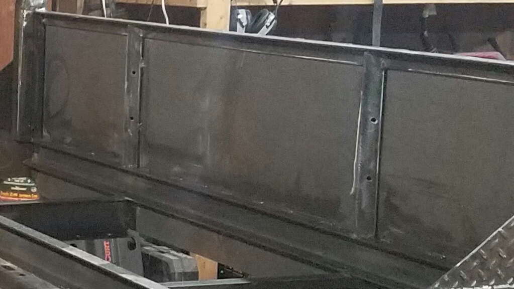

Also finished the bulkhead. Added a few bungee and cargo strap holes. I'm not going to cage the rear window. I'd rather have access to it in case of needed repairs/replacement, and available for exit/entry (if needed).

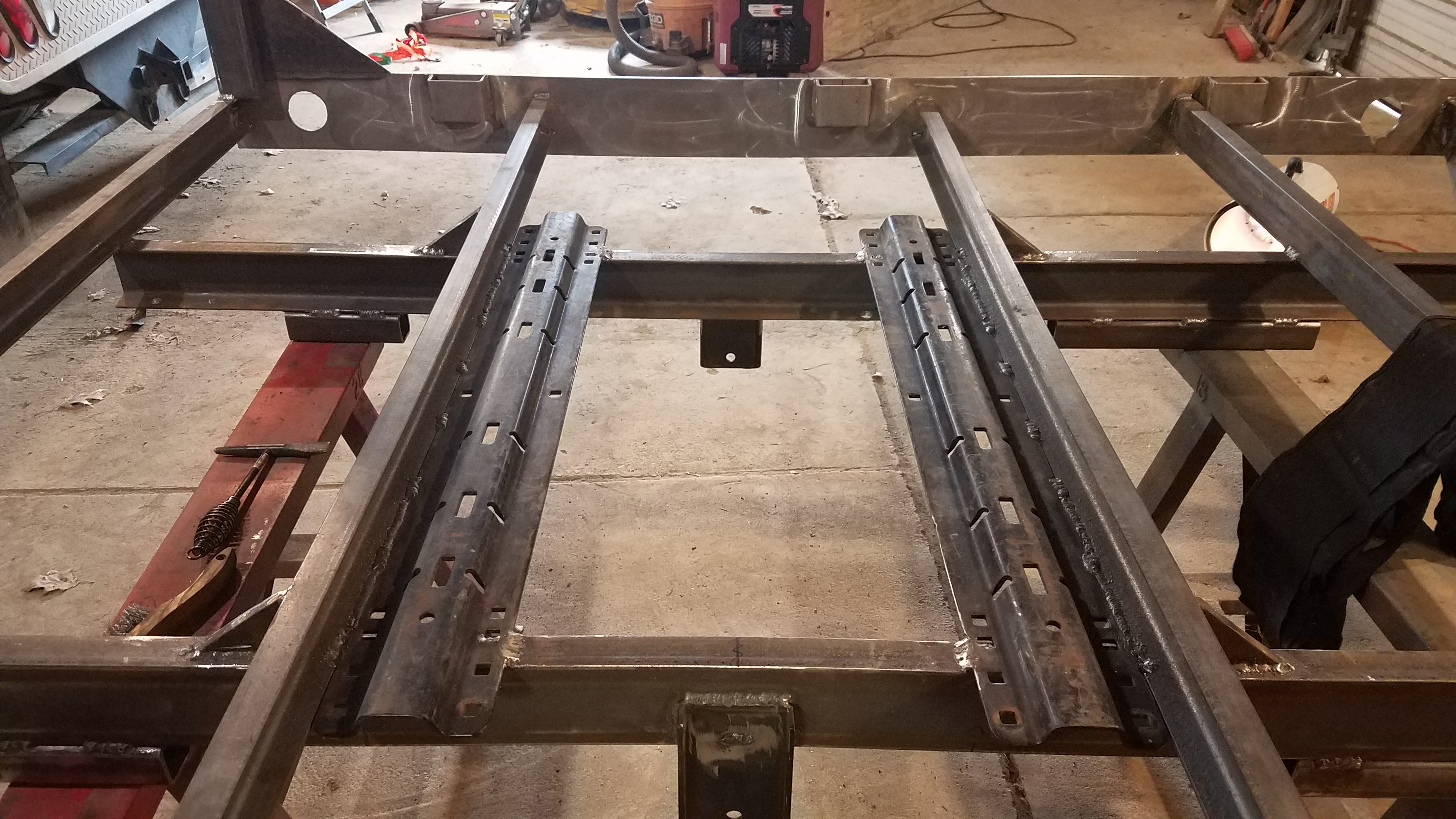

Then finished up by reinforcing the fifth-wheel-rail welds and adding gussets to the C-channel near the rails attachment points.
So, construction is complete. Just have a few holes to drill for wiring, trailer-connecter harness, license plate, backup camera, etc.... Then time to clean her up and paint!

Very nice work!!! Professional grade!!!
I tried the horizontal gas filler method. Puked fuel out unless filling slowly. Even then dribbled every time. Finally moved to a vertical position. Hope yours works okay. :)
   / Building a flatbed for my F350
#70
Yeah I'm hoping so, but i expect it will be ok. It's now the exact same height as the factory mounting location was.
