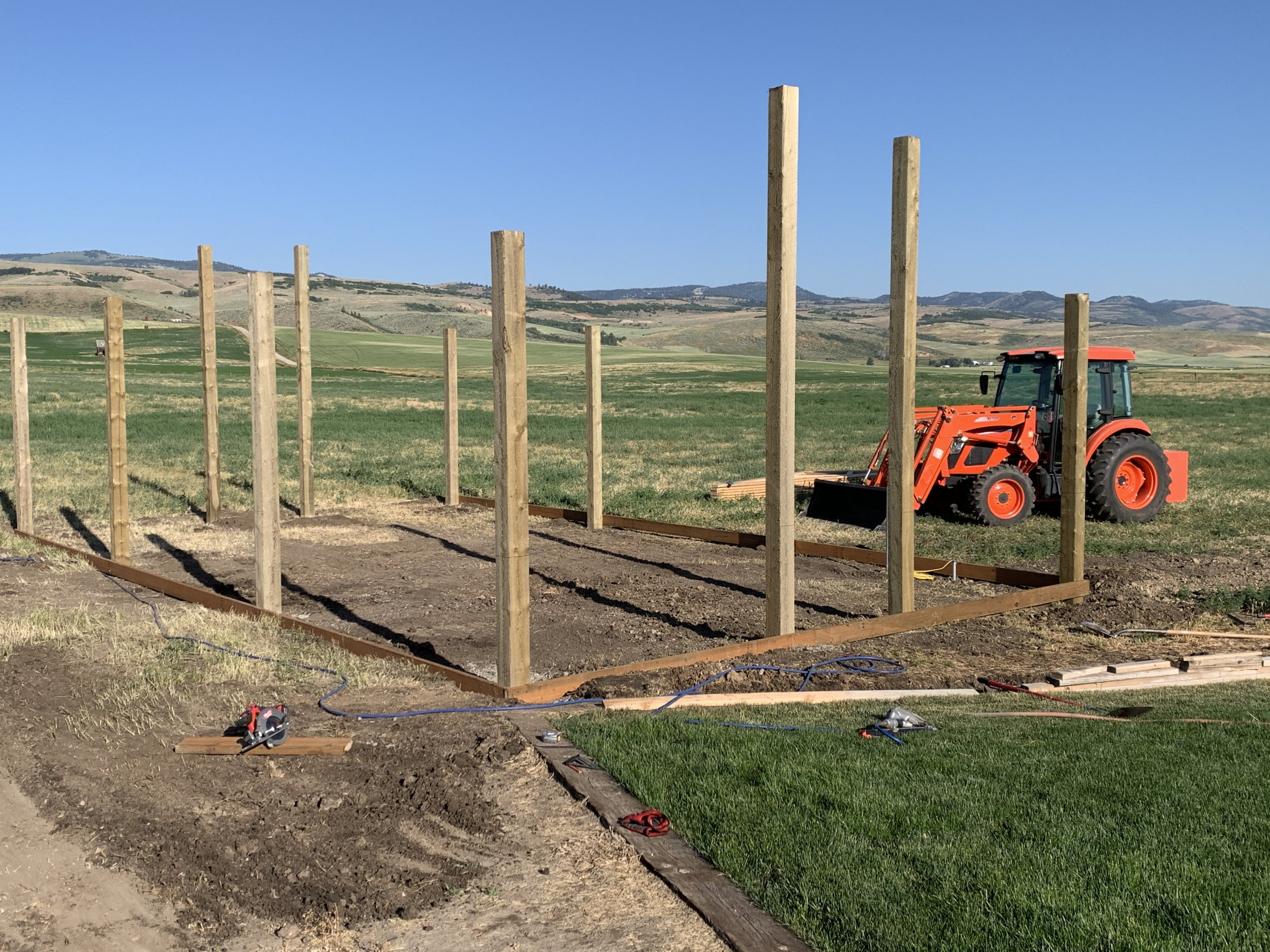

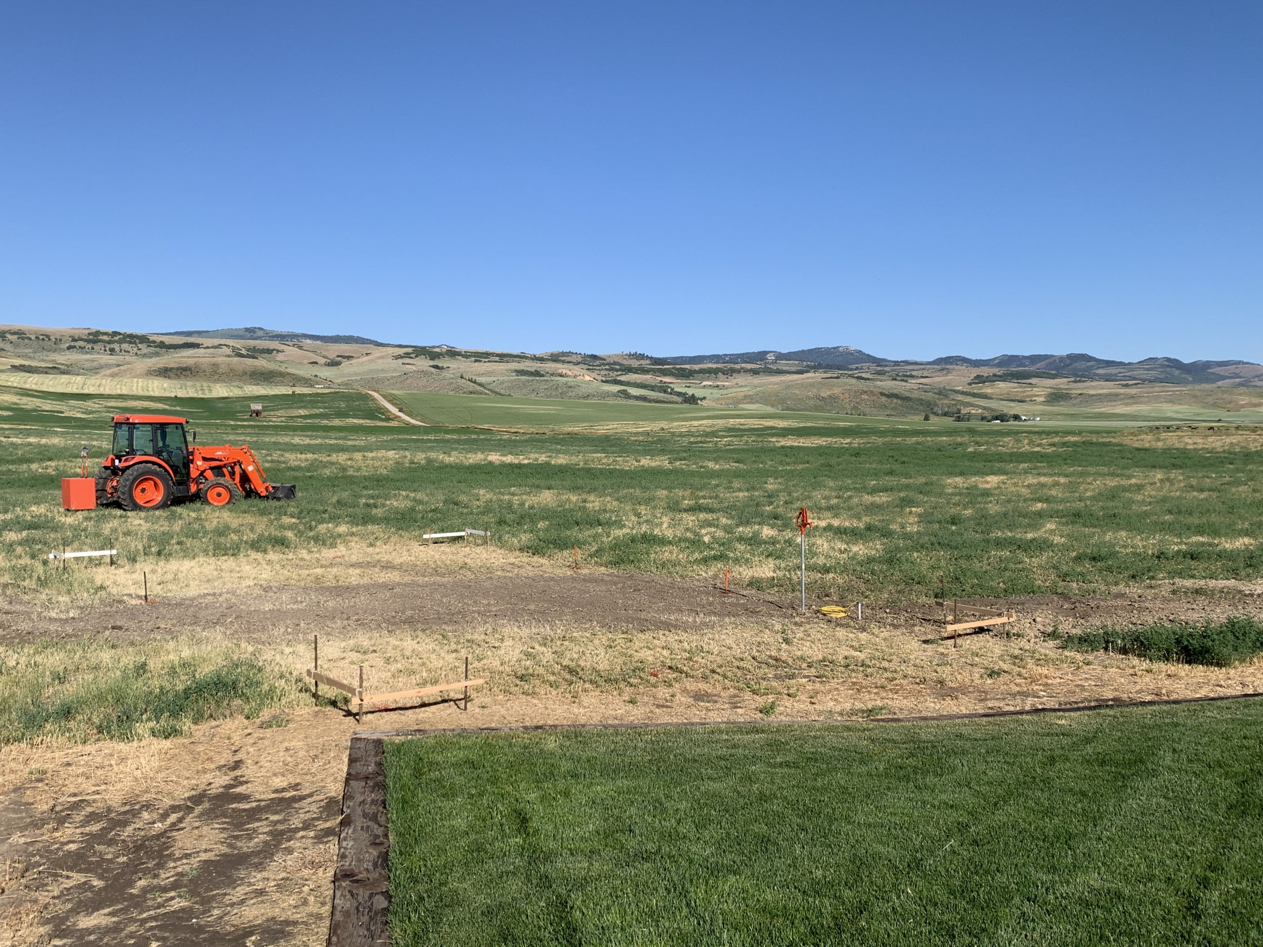

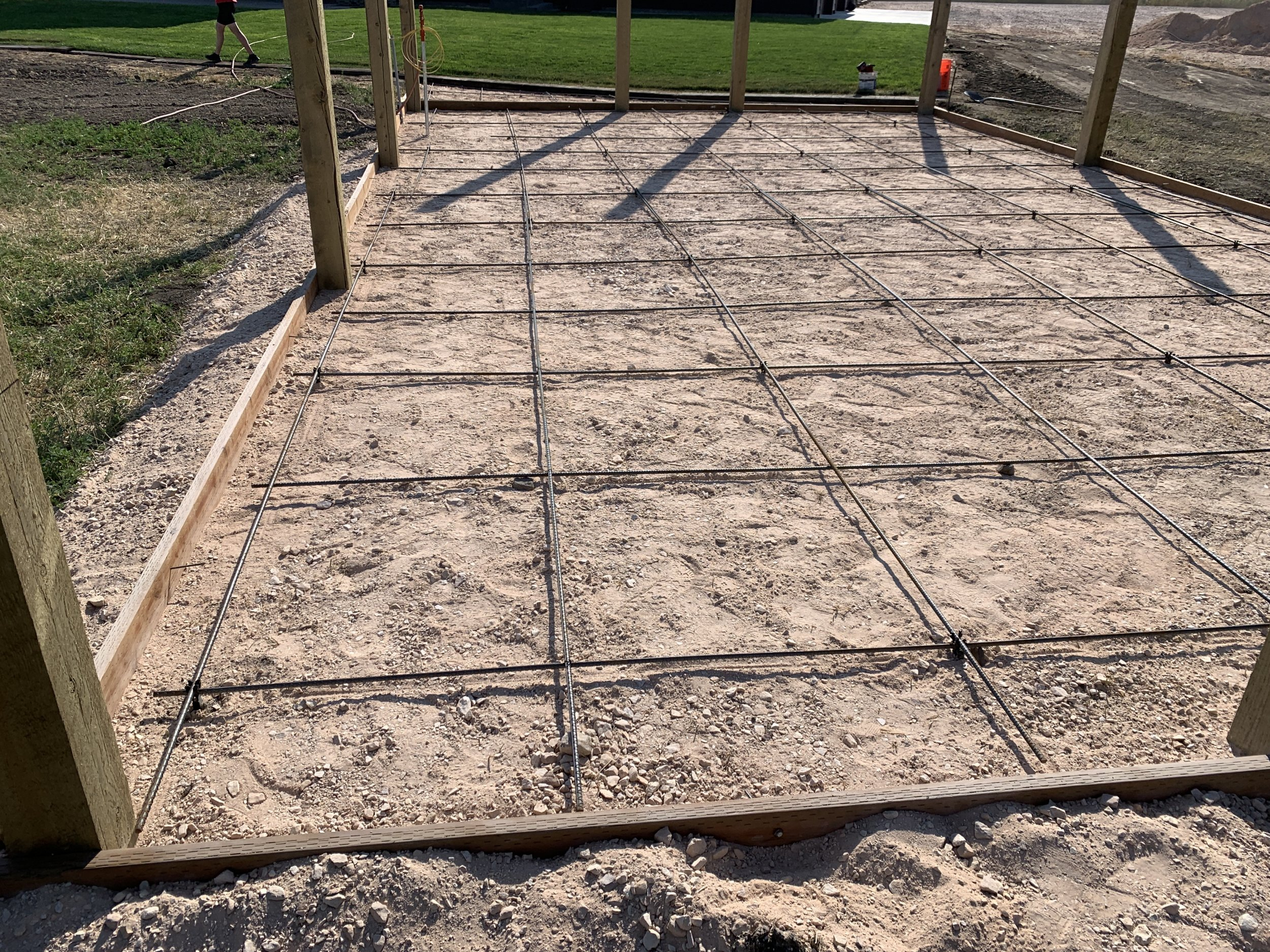

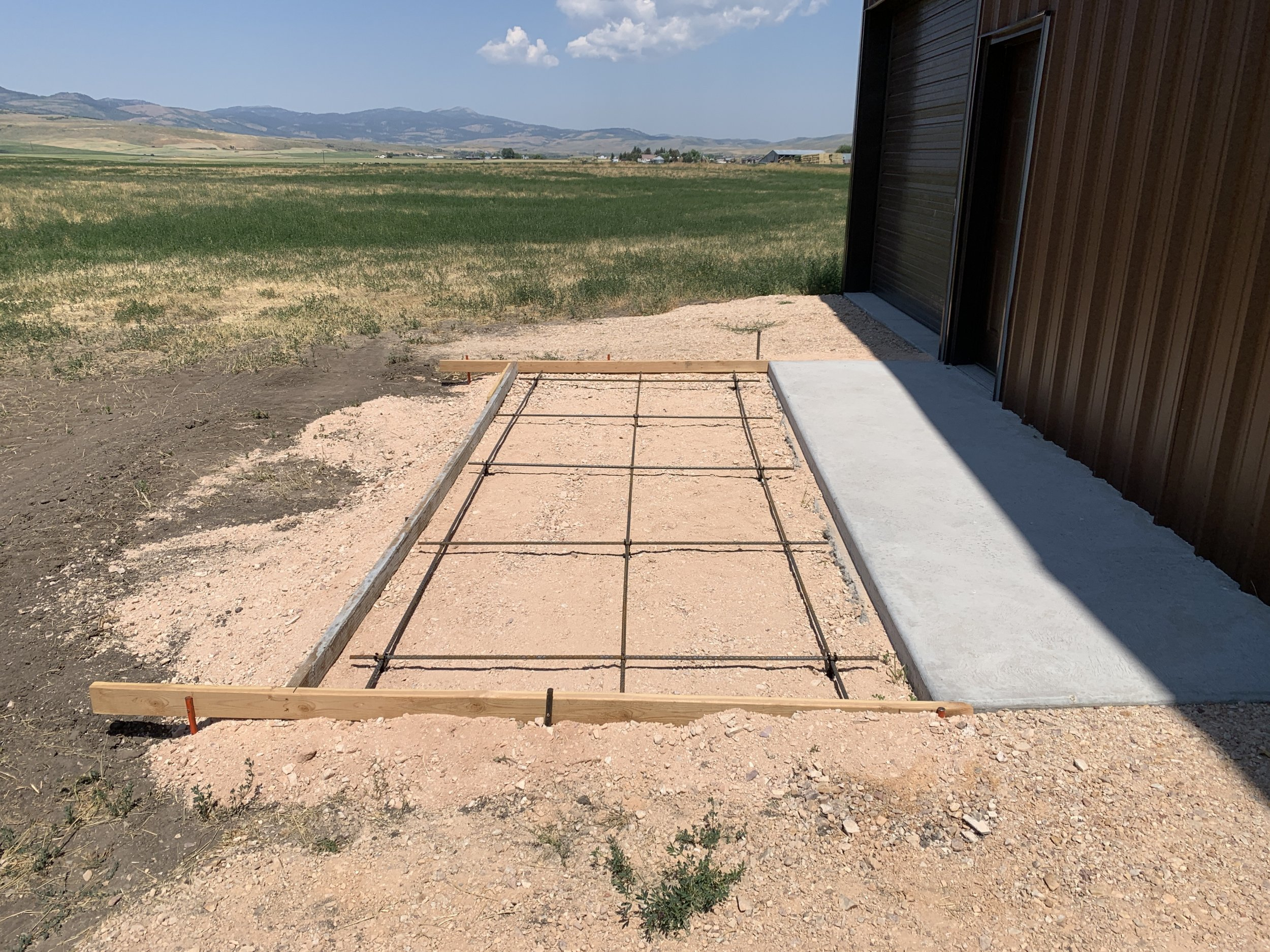

My wife and I decided we need a greenhouse. So here are a few pictures of the progress.
It's 21'X36'X8'ish, It's a little different design tha
n what you would imagine a greenhouse to be, but trust me it'll work.
It'll have a concrete floor and raised beds.
Side note, the guy in the skid steer is 91 and still going strong.

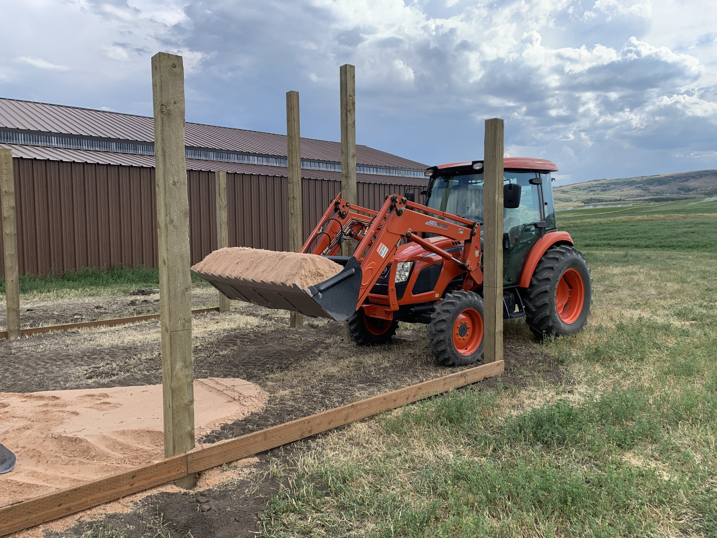

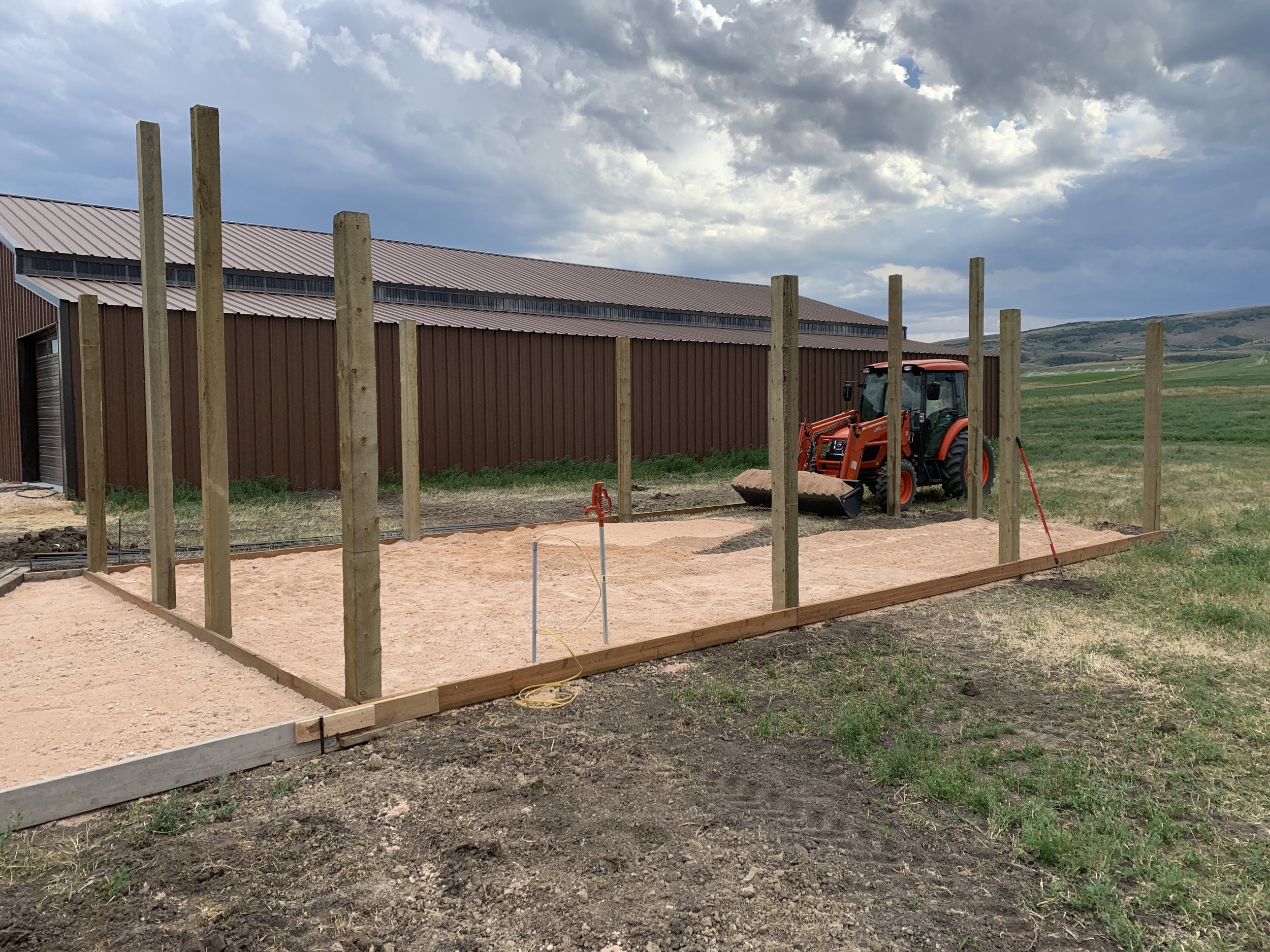

Not sure why the system split up the writing but its all there.

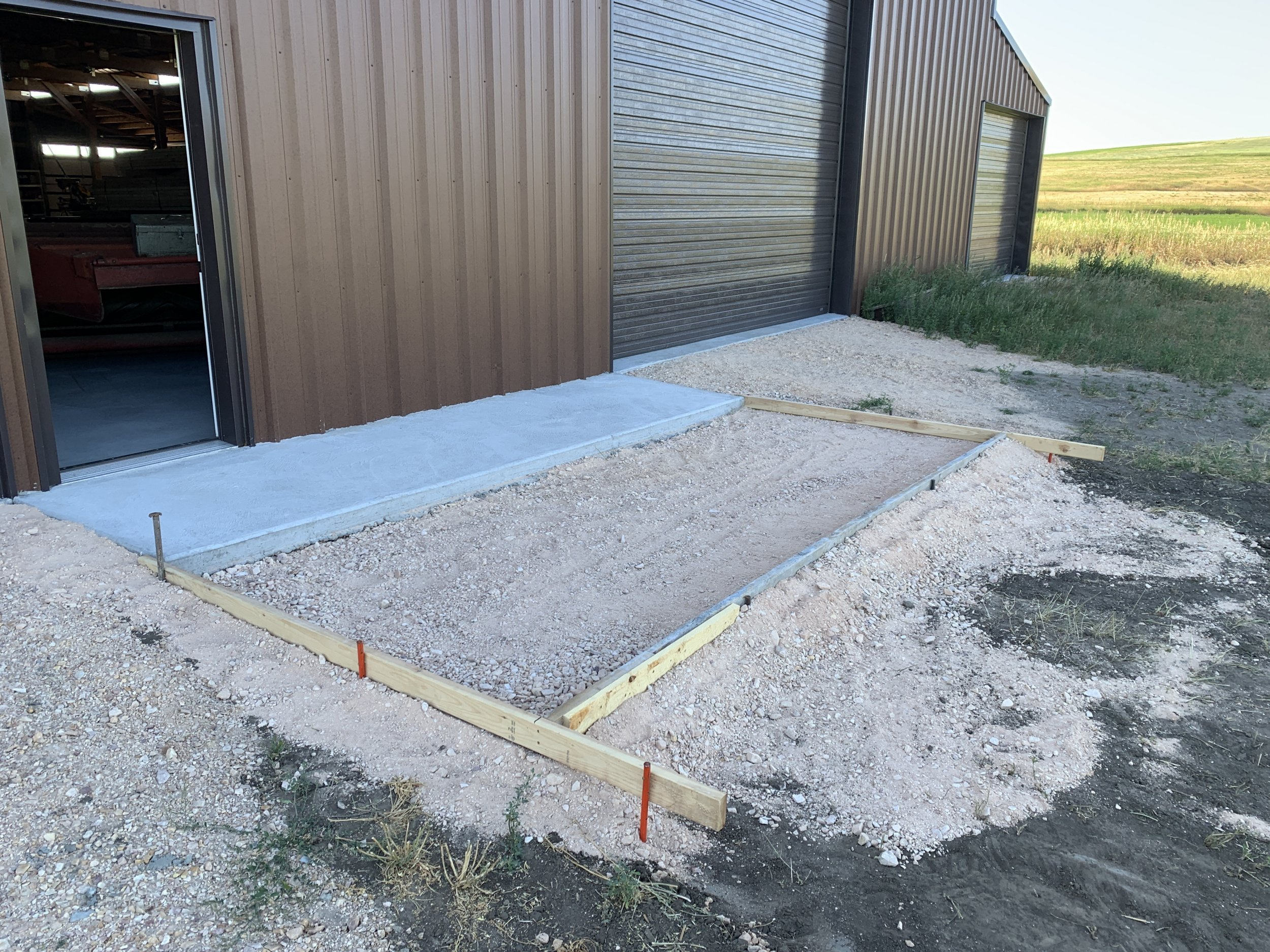

Also why we have cement trucks coming I'm going to get a pad for my diesel tanks (2-550gal.)
I have the rebar in now but not at the time of the picture.

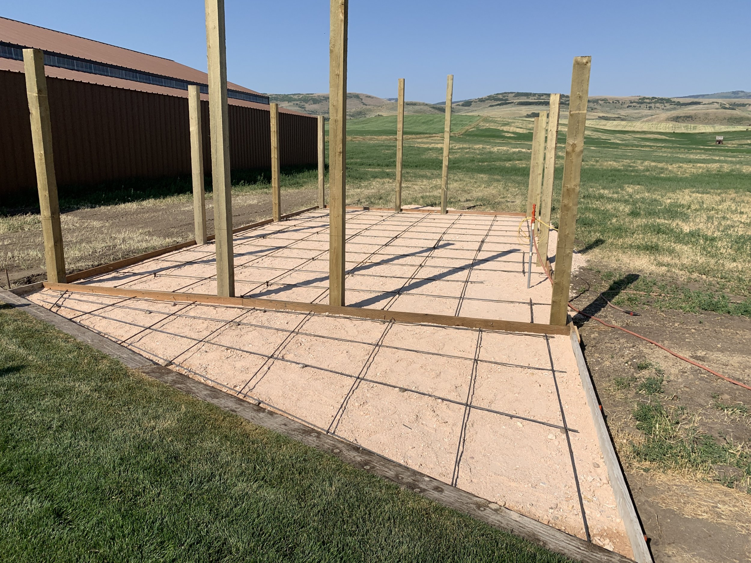

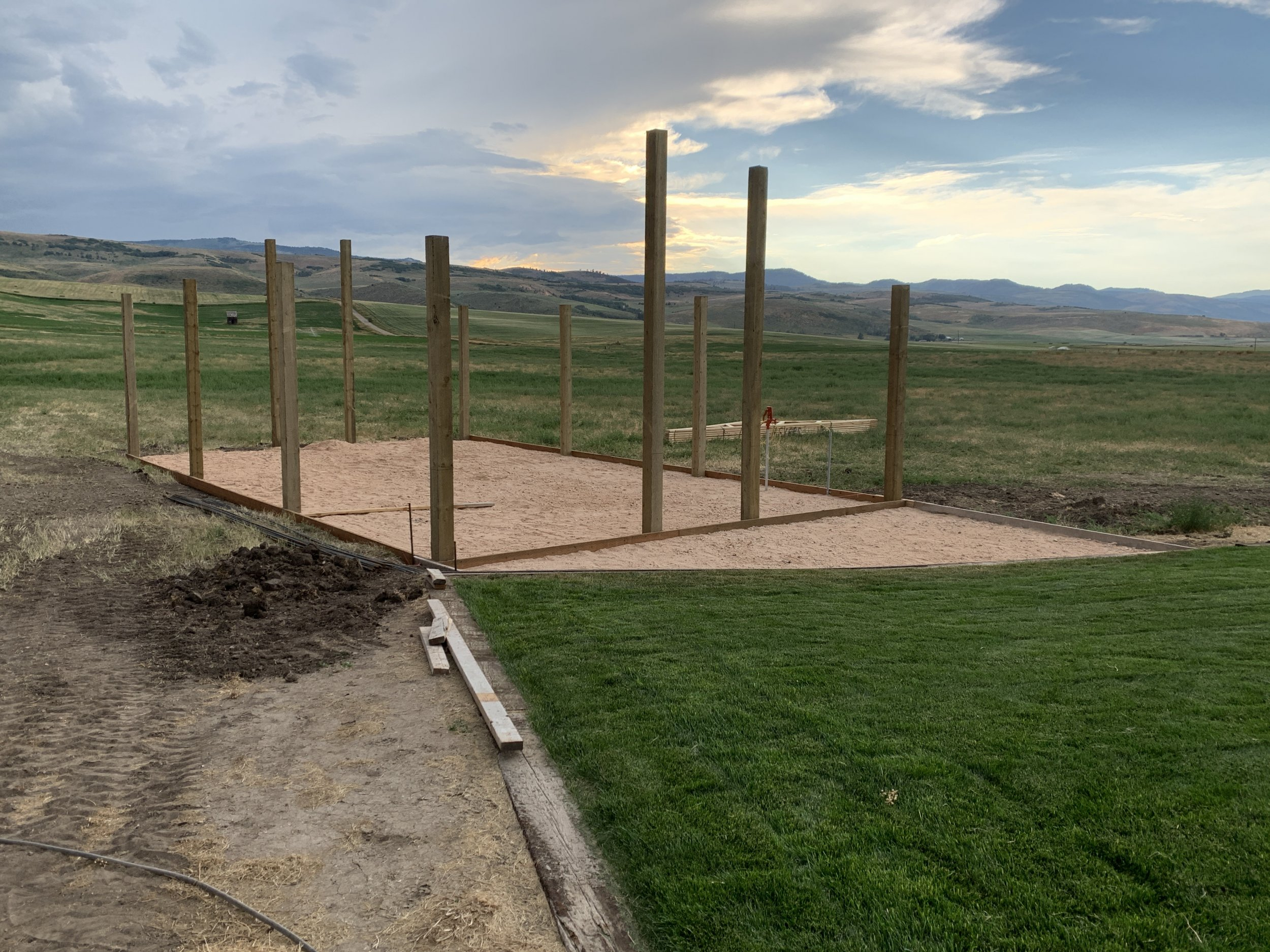

OK, I'm ready for concrete on Monday.
Also got a call from the place I'm buying my fuel tanks from and they are being shipped, should be here Monday.
/ Building a Green House. #9
That's a big project, looks good.
are the fuel tanks going on that triangular end ?

Thanks, the fuel tanks will go on the rectangular pad. (last picture on post #8)
