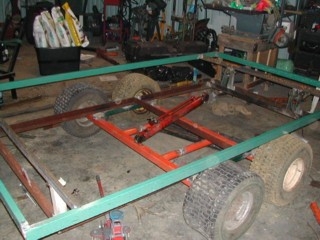

I have started building a hydraulic dump trailer from scrap that I have been collecting for the last couple of years. Some of the main components are:
Axle carriers made from the gauge wheel brackets of two Hinomoto tillers.
2 rear wheels from a Craftsman lawn mower and 2 from an unknown brand.
Hinges for the dump are from 2 Yanmar tiller toplink brackets.
Hydraulic cylinder is from a Yanmar front end loader
The front post that support the bed are post from a weight bench. Here are a series of pictures of the assembly so far.

The rolling frame

   / Building a hydraulic dump trailer #7
Looks like a great start!! Keep the posts coming.

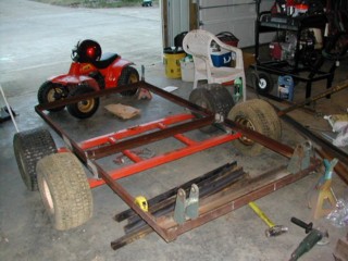

That is my daughter Suzuki LT50 and knowing her she will try to pull this trailer. Actually hydraulic power will come from a Yanmar YM1500D. The trailer is a little out of proportion for the little tractor but I went ahead and built bigger for when I step back up to a 30+ hp tractor again.

i hate to cricize but that little angle iron frame is probably gona fold in half when you try to dump that thing with much weight in it. personaly i would have used channel or sqaure or rectangular tubing for a trailer that size,angle iron isnt that strong when loaded that way. i dont want to see a post a few weeks from now titled "dump trailer oops" where the bed looks like an inverted taco and there is a pile of rocks on your toung and drawbar,i have seen what happens when the rear hinges rip off of a dumptruck and the body kicks up and comes crashing down onto the center of the frame and back of the cab, its not pretty and it takes alot of welding to fix that

I haven't re-inforced the sub-frame yet. I will be added more pictures in a few days. I have got National Guard drill this weekend so I won't be able to work on it.

I'd also add plenty of bracing on the cylinder ends because u will have a lot of push until the trailer goes up some.
This is where scissors hoists work really well.

I am still working on the trailer. I am reinforcing all critical components. I will then have to weld some light weight angle iron across the bed. The will support the wood in the bottom of the bed.

Another one.
