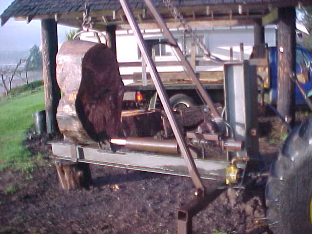

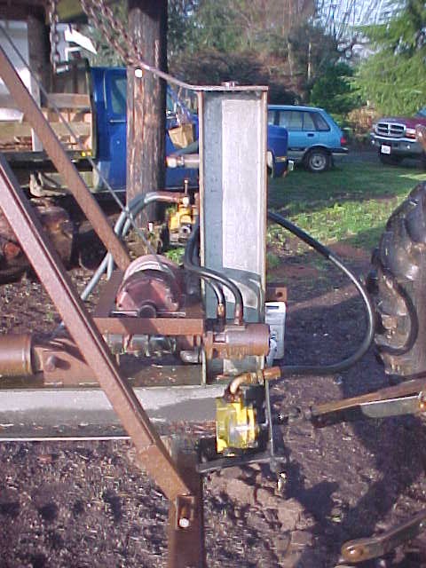

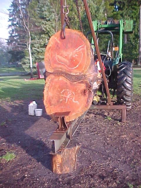

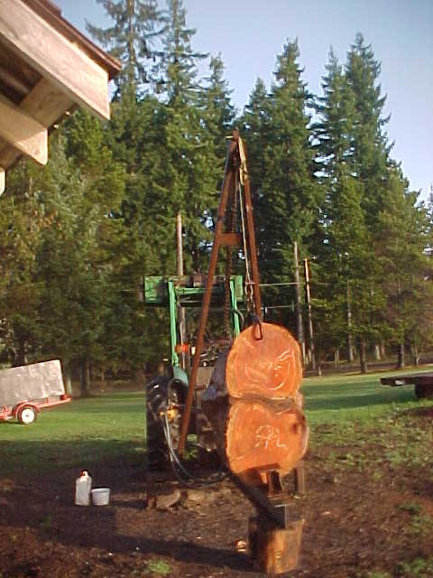

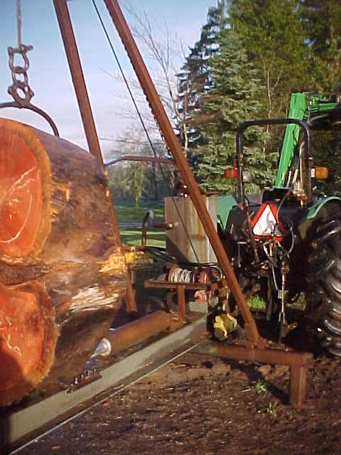

ok, found the disc, now to try to post them.

As you an see it is a conglomeration of stuff thrown together, but it works great. like I said I am changing to having it self contained, but will keep the 3pt for moving it and stablization. It will free up the tractor however once planted, just won't be yarding on any logs, just the blocks.
As you can see by the bent steel on the knife, it has taken some abuse, but still does the job.
Good luck on yours, hopefully this will give you some ideas.
Just noticed you notes on the flexing of your ram. Mine has quite a healthy rod and I haven't noticed any flex there, although it sure can flex that I beam. The one I am splicing in will be much heavier.
