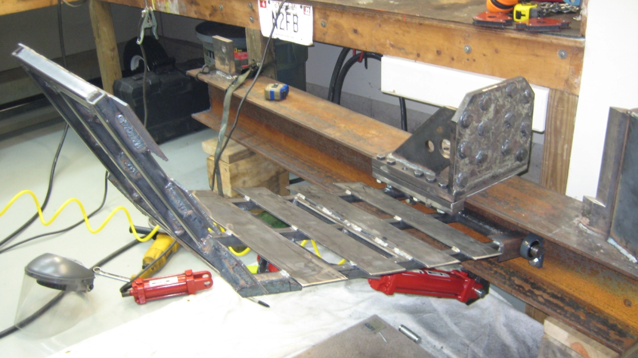

I have to say that you do some really nice fabrication work and came up with a really nice design! What part of PA are you from?

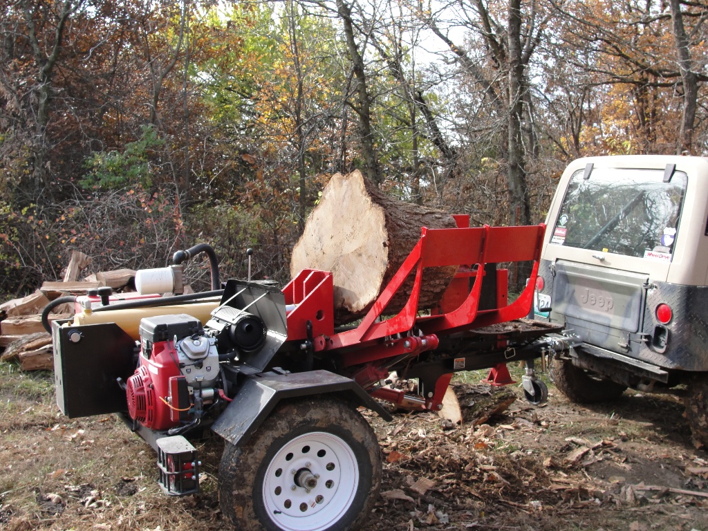

many years ago my dad built us a log splitter. I have it now, and am in the process of adding quick-connect hoses so i can run it off my tractor. My question is, why build a log splitter that "lies down" (horizontal)? This splitter my dad built will lie horizontal for transporting, but when you split, you raise the boom to a vertical position so the base sits on the ground. No need for lifts, just roll the log under the ram and split it. MUCH easier.
   / Building a hydraulic log lift for splitter #34
And then you bend over and pick your split wood up off the ground...... Hmmmmmm...... Doesn't sound easier to me. I'd prefer a horizontal beam with a lifter to handle the big ones. then all the split wood ends up on the catch table as working height. MUCH easier. ;)

1962, great job of fabricating. Tough as a boot
Good idea on the stop block on the opposing side. Makes the big ones a lot safer.
I often leave my lift table in a horizontal position and stack it full of wood, then split, when working by myself. Or if I have help, leave it horizontal and someone is carrying everything that's able to be lifted by hand and stacking on the lift for me to split.
Now ya need to build yourself a catch table so you don't drop split ones on the ground!!! I built one, then modified it a little bigger, then modified it again with round rod railings to catch the really big ones that need split again. Anything to avoid another bend over!!! :)

I have to agree that horizontal splitters are alot better I usually park the tractor in front of mine and split right into the bucket, have you ever tried to maneuver a 36 inch round standing on its end? no fun, horizontal with log lift is the way to go.

Sorry I did not catch this thread sooner. I am just finishing my splitter with a lift and a four way wedge. I actually used a calculator and math to determine where to put the attachment points and and what length cylinder to use for the lift. I ended up with an 8" cylinder and the math worked.
It needs painting, but here it is as of today. I copied most of it from Timberwolf, but used a W8x40 beam and looked hard at the Rayco splitters.
Here are the first test runs.
