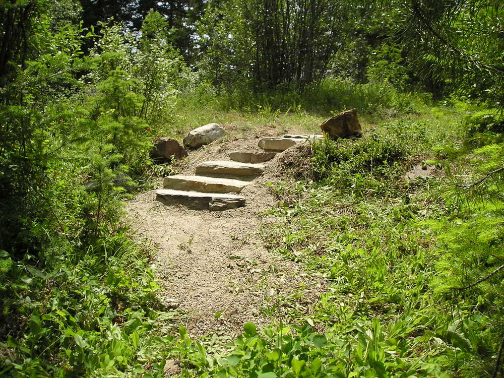

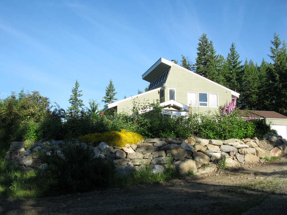

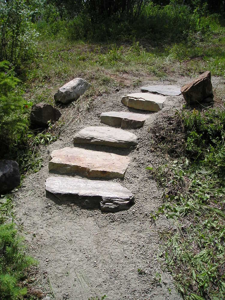

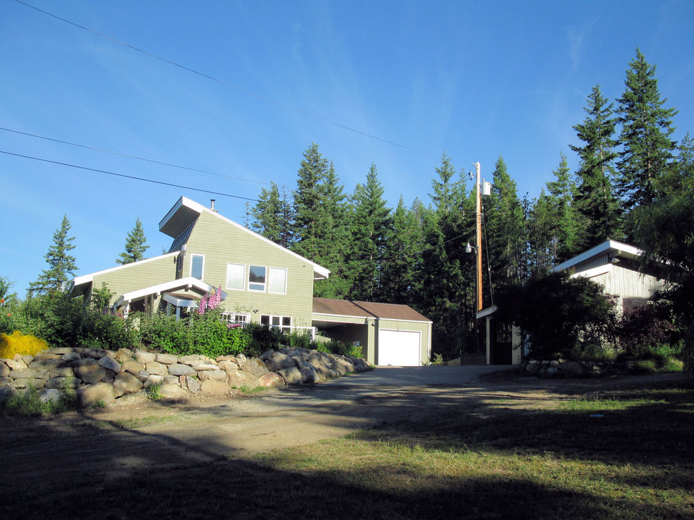

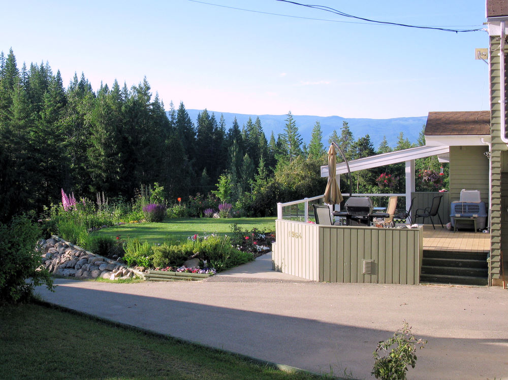

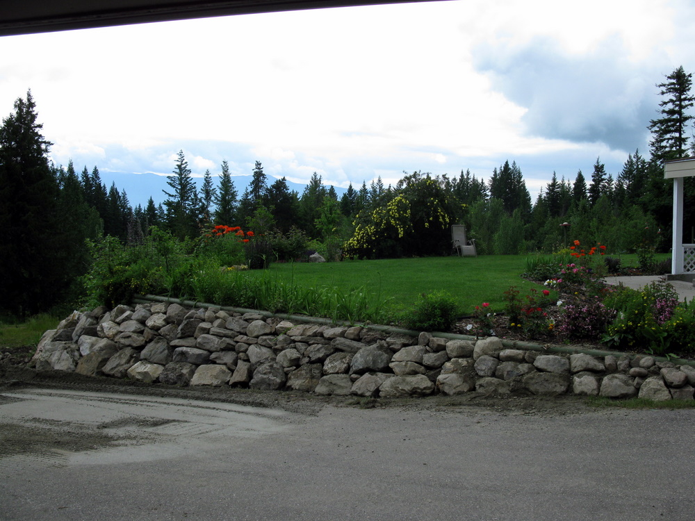

I realise this isn't likely suitable for your application but I am posting some pictures of my retaining wall that I had built to replace a rotten landscape tie wall that was ready to collapse. We built the new wall in front of the old one using boulders dug from the property. The small wall goes from about 2' to 4.5' high. The longer wall is about 6.5' high by the yellow bush.
I built the steps using flat rocks I found elsewhere.
