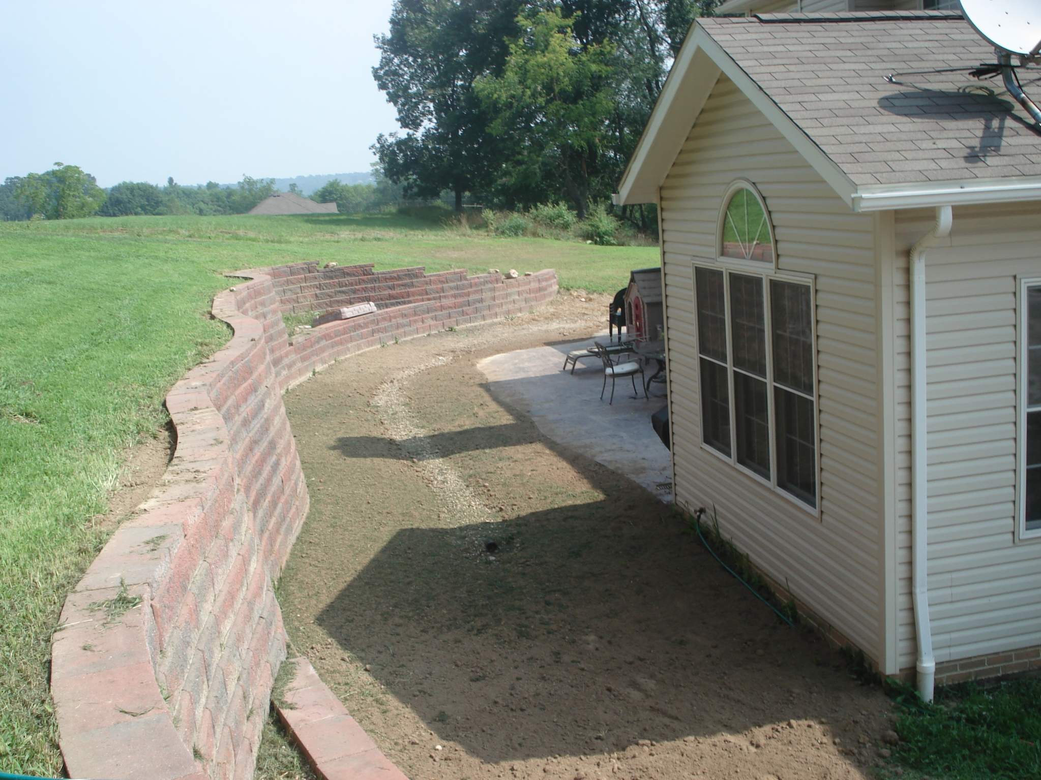

Yes....that's a lot of work! These blocks are about 60lbs each. This is my retaining wall that was already installed when I bought the house. I had 5 pallets of retaining blocks that I had to move around a few times before I extended the walls around the garage.
What I've found out with retaining walls.....
To do it so it will last a lifetime, use the actual retaining wall blocks. They will not move if properly installed. They have a lip on the back that locks them together and has a setback for each row. The material goes in the middle of the row set back into the bank. The blocks are filled with gravel, and also backfilled with gravel behind the wall for drainage. And, a plastic drain line along the length of the wall. The caps are actually glued in place with landscape block adhesive.
Now granted, this wall is 60' long, and over 6' tall, so it needs to be built to last.
hope this helps!

I almost forgot the most important part, as someone else already said....the base. We we used 303 rock base, well compacted. The base is the key to a long lasting, even, straight wall.
Good luck!

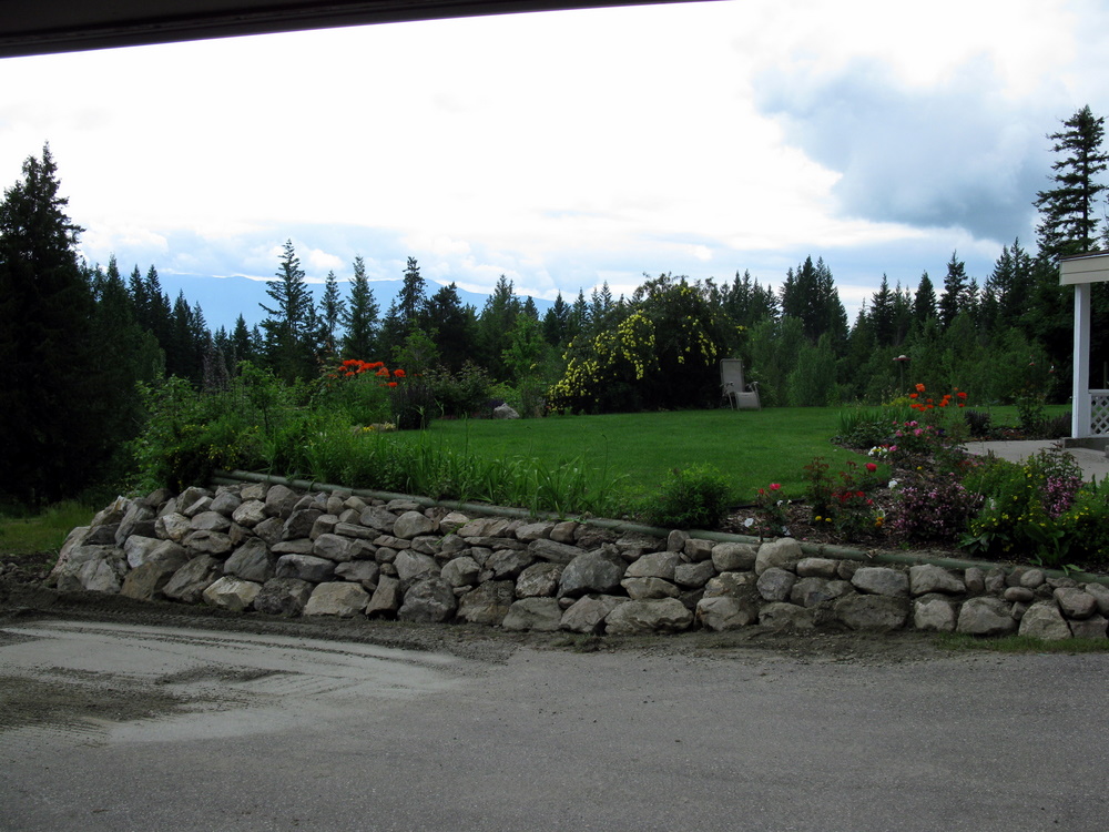

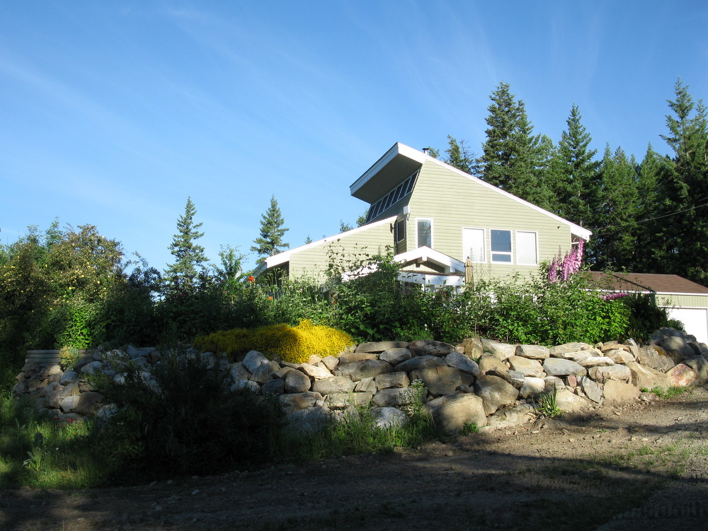

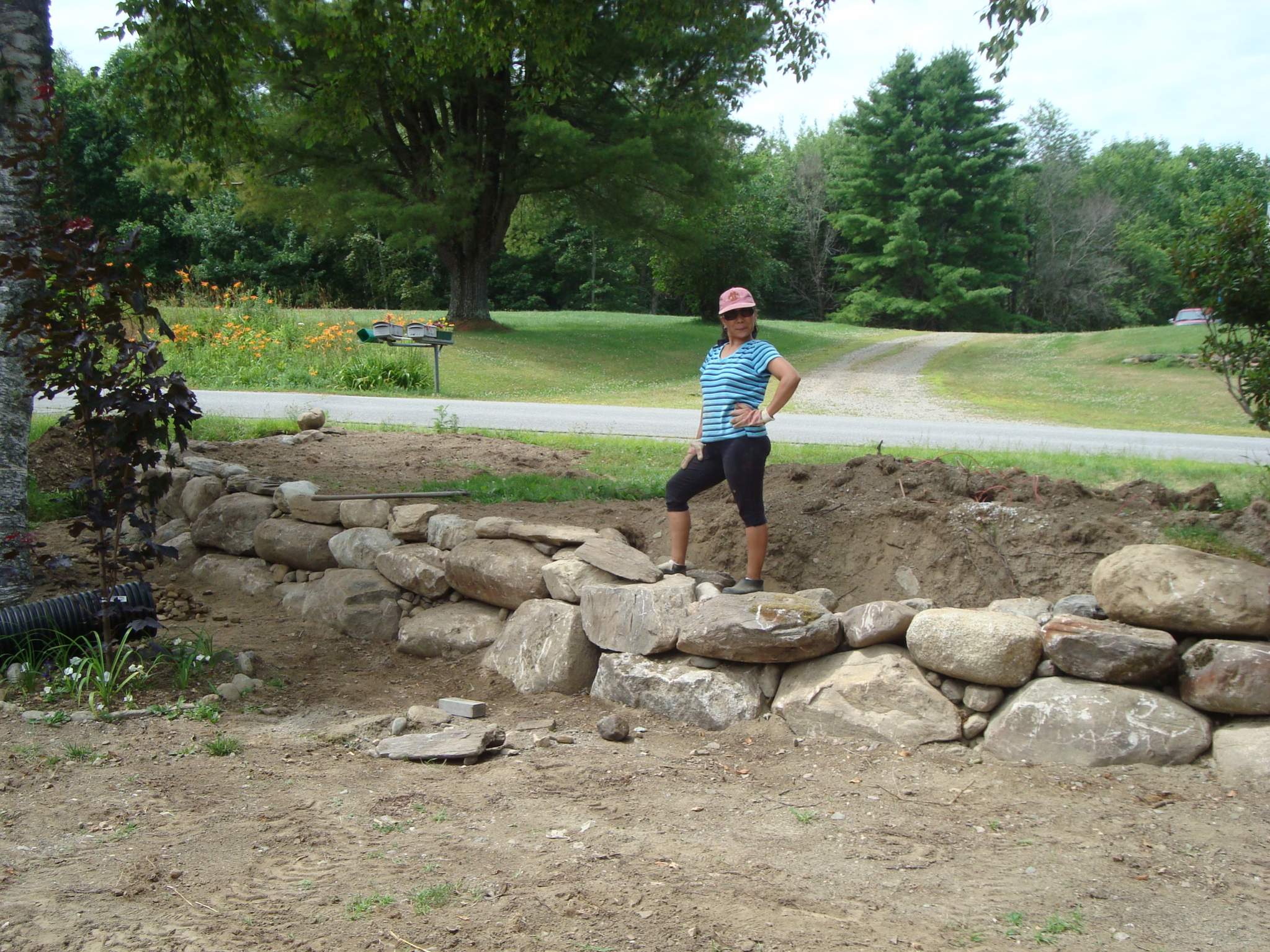

I started my wall a couple of years ago with field stone found around the property... so far it has not moved...
Problem is I need to go another 24" in height and ran out of 30 to 60 pound boulders...
So far I have not been able to come across any locally... the BX was a godsend moving the material and boulders...

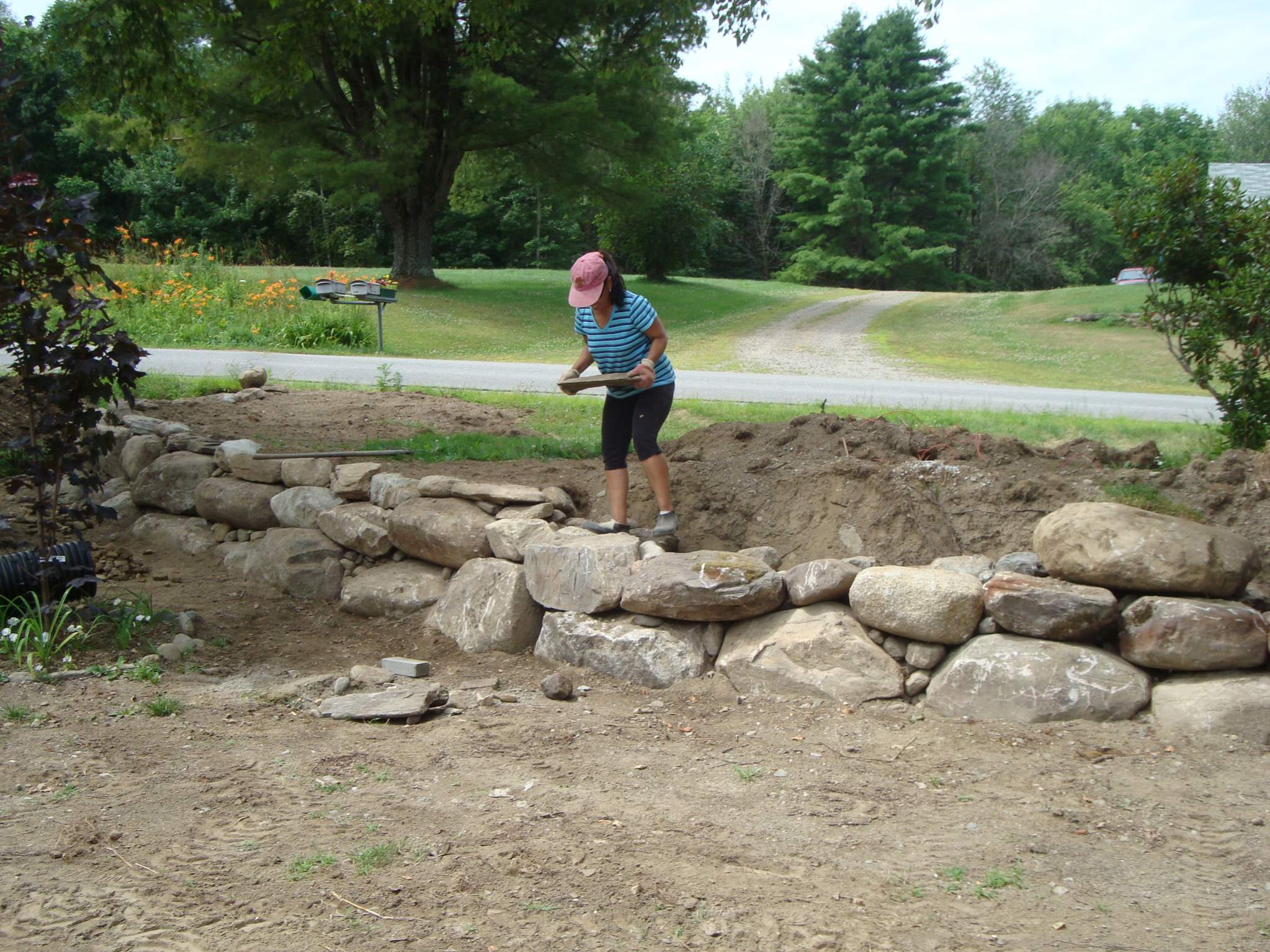

Pic's of the wall my wife built this summer.. I placed the base rocks for her with the BH and she did the rest.. :D

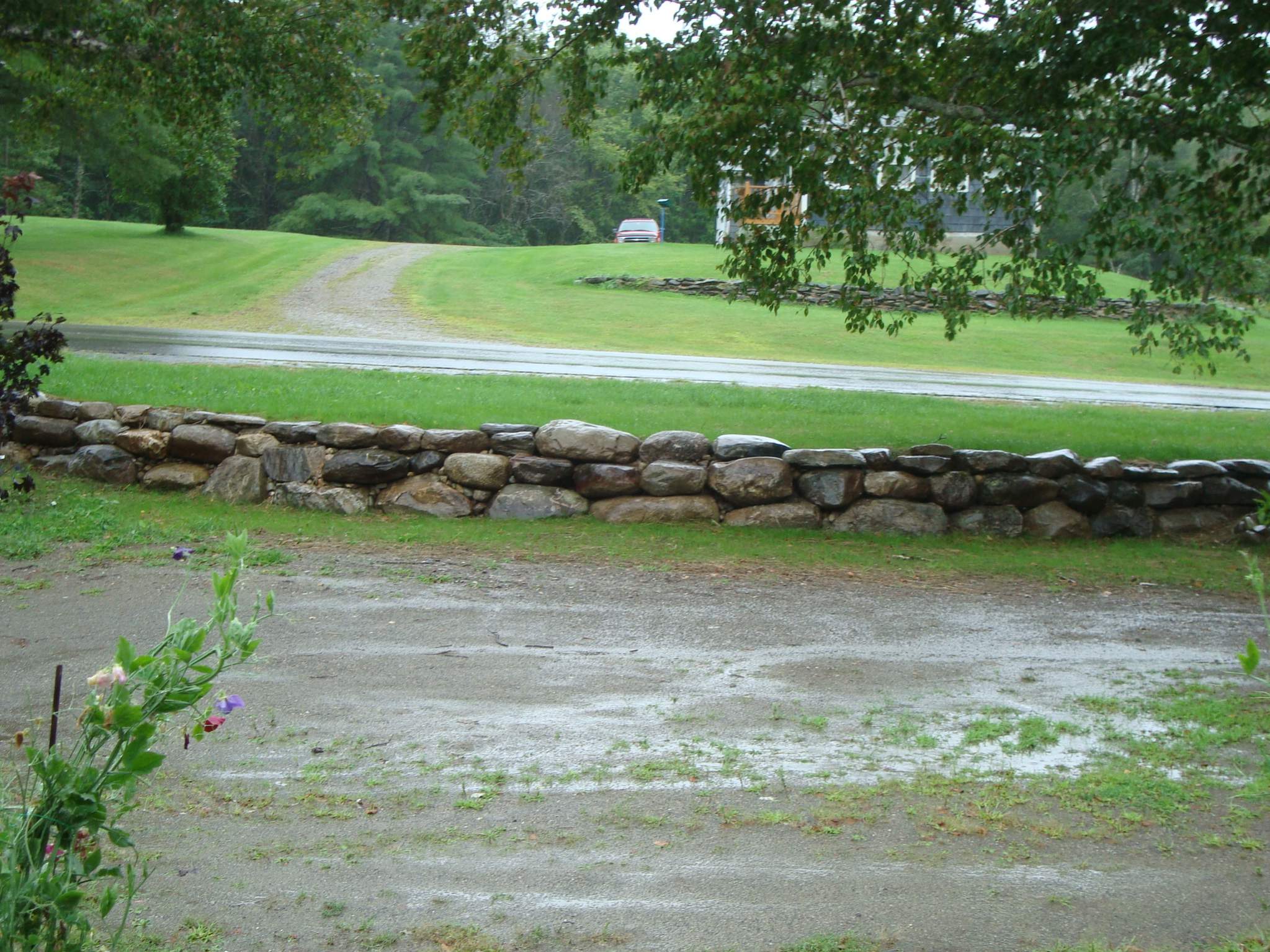

I've been building a stone retaining wall down in the draw... it's been 7 years of finding boulder's and stacking...
So far not a single stone has come loose.
We have all kinds of requirements for engineered walls... none for dry stack boulders.
A neighbor had a beautiful dry stack boulder wall built with an excavator on site for about 10 days and all the rock trucked in... some complained about his wall and the city could find no violation...
