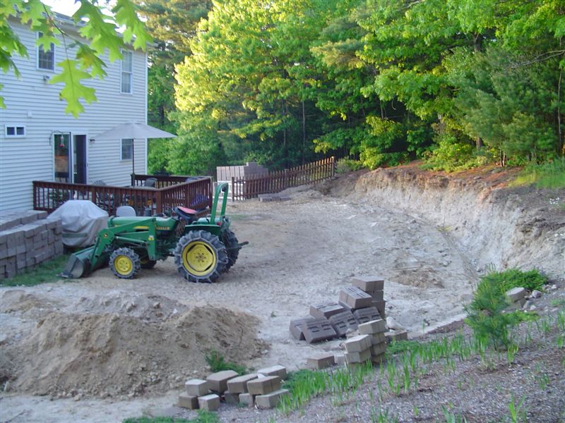

Yes....that's a lot of work! These blocks are about 60lbs each. This is my retaining wall that was already installed when I bought the house. I had 5 pallets of retaining blocks that I had to move around a few times before I extended the walls around the garage.
What I've found out with retaining walls.....
To do it so it will last a lifetime, use the actual retaining wall blocks. They will not move if properly installed. They have a lip on the back that locks them together and has a setback for each row. The material goes in the middle of the row set back into the bank. The blocks are filled with gravel, and also backfilled with gravel behind the wall for drainage. And, a plastic drain line along the length of the wall. The caps are actually glued in place with landscape block adhesive.
Now granted, this wall is 60' long, and over 6' tall, so it needs to be built to last.
hope this helps!

I almost forgot the most important part, as someone else already said....the base. We we used 303 rock base, well compacted. The base is the key to a long lasting, even, straight wall.
Good luck!

George I would sure be trying to find a way to access the area with a skid steer or maybe one of the walk behind units like the Toro Dingo. You are going to have hundreds of 60 pound blocks to move and an unbelievable amount of gravel fill to move. Your a better man than I taking that on by hand and wheelbarrow.
MarkV

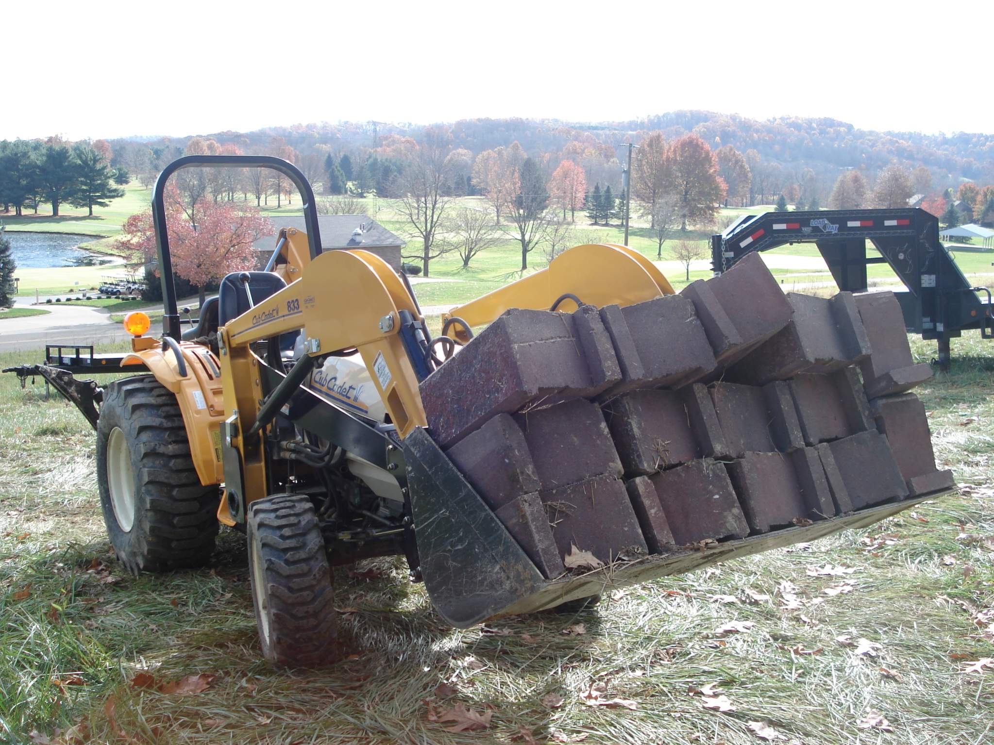

Why is the OP doing it by hand,, He has a tractor right..:confused::confused:
   / Building a retaining wall...by hand.
#29
The OP's tractor sits on a 237 acre tract of land in the country. The OP's backyard is in the middle of downtown in a small city.
As far as moving material, I can have blocks and gravel set down at the end of the driveway. From there it would have to be hauled maybe 30-40 feet, slightly down hill fortunately. But yes, a small (tiny) skid steer would help, or one of those walk behind deals. But rental costs add up fast and so it would have to be rented for maybe a couple of days at a critical time, maybe after the base and first course are laid.
