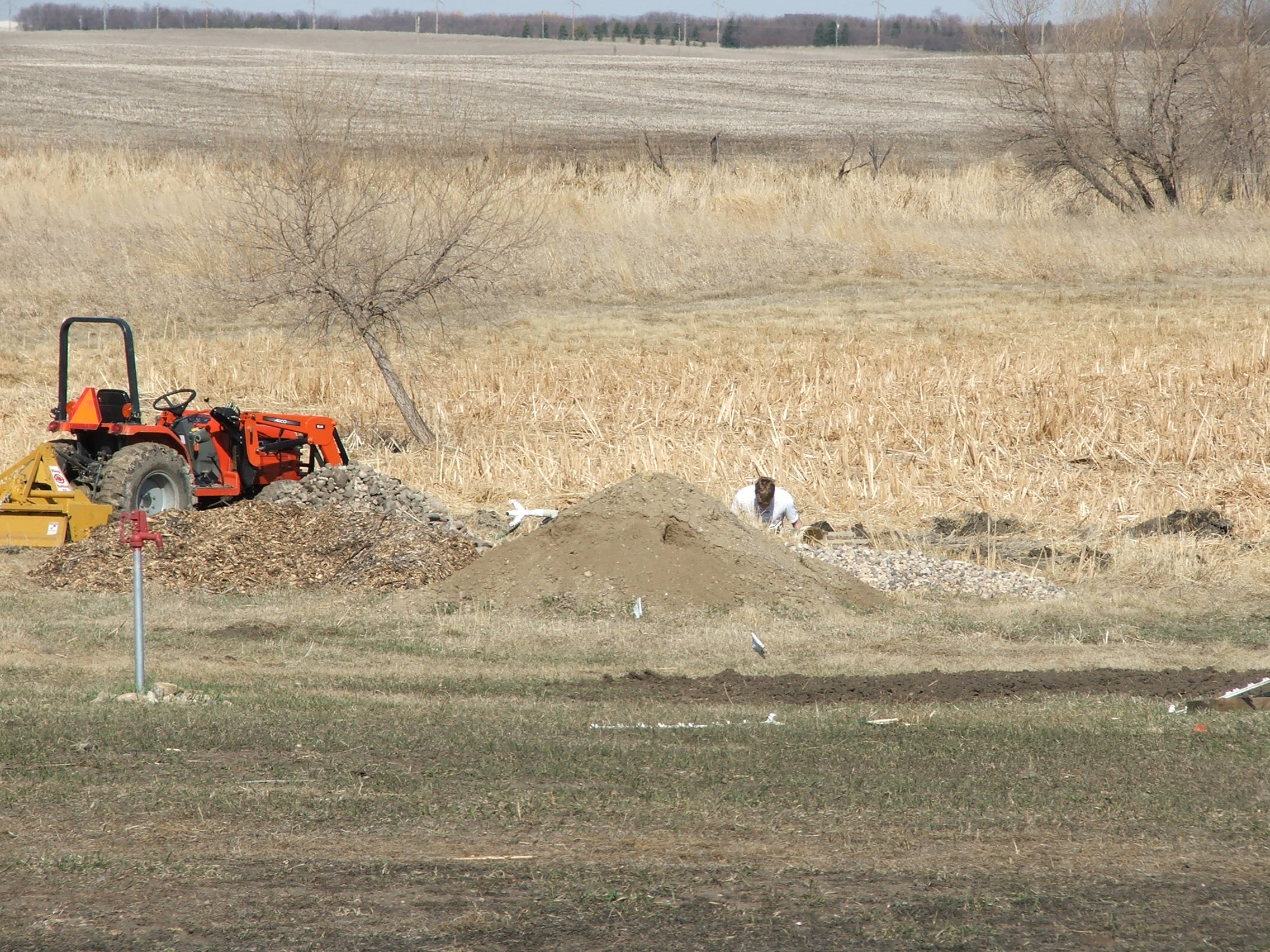

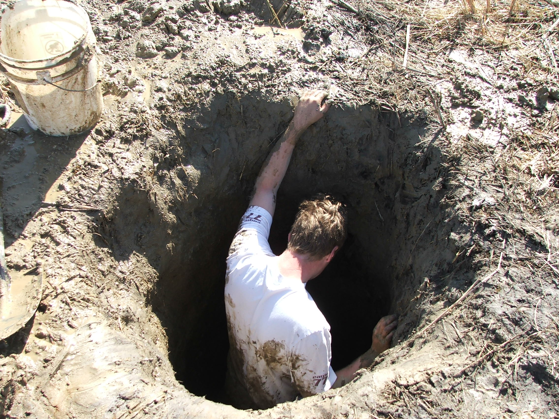

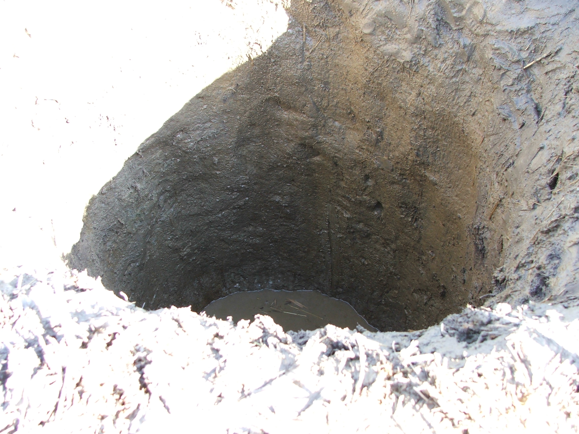

well i started digging the hole and right around the seven foot deep mark i started to get a little clausterphobic sp? . Also i now cannot bail the water out fast enough so i think this is all the deeper i can go.

My hat is off to you!! I know how much extra work it is digging a narrow, deep hole.
/ Building a shallow well #8
Too bad you don't have a long post hole digger with a good sized bit on it to punch a little deeper to get further into the water layer. I would think if it is too shallow it still might silt up. Looks like fun though
/ Building a shallow well #9
Since your standing in the hole and not swimming in it, I have my doubts as to how much water you will get out of it. That clay holds the water like a spong and isn't letting go of it. In time, you'll get water in the hole, but it's going to be a slow process.

well i stayed around 7 feet deep, i would fill about 5 5 gallon buckets with water for ever 5 gallon bucket of dirt. i just could not keep up with the water coming in the hole. so i went and got a 10 foot piece of 6inch PVC and drilled holes in it and put it in the hole. My first choice would have been a 15" plastic culvert but i could only find them in 20' sections and that was way more than i needed. so i backfilled with rock and then about 8" of dirt/clay on top of the rocks.
then i hooked the pump up and ran one garden hose wide open for about 35 min. and then it dried up, i have to wait an hour or two and then i get about another 35 min. the flow is less than i hoped but I was pretty uncomfortable with the hole being deeper than i am tall.
i would really like to use my post hole digger by adding sections of pipe. I just have not figured out the how i am going to do it.
all in all it is an alright well for $20 and 4 or 5 hours of my time.

Mike, I generally think the safety police are too cautious but you are pushing your luck in that unsupported hole. A cave-in in a 4' hole can be fatal.
Anyway, I dug a well like that in my basement by digging as far as I could until I couldn't keep ahead of the water. Was in gravel & only 4' deep. I stacked up 3' tall concrete perforated drywell tiles one at a time as needed then got inside with my pressure washer & a diaphram type mud sucker pump. Ended up 12' deep. As I washed loose the gravel the pump sucked it out & the tiles settled into the hole. MikeD74T
