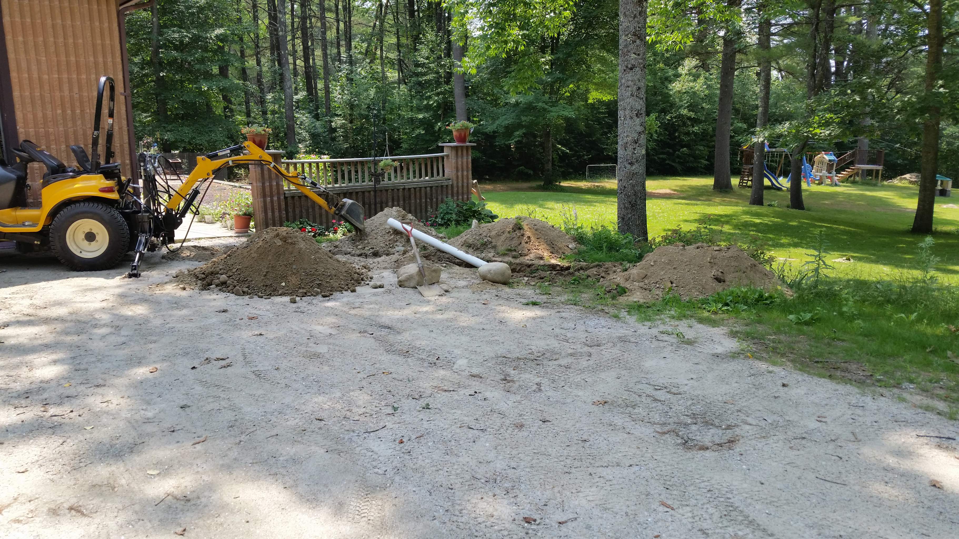

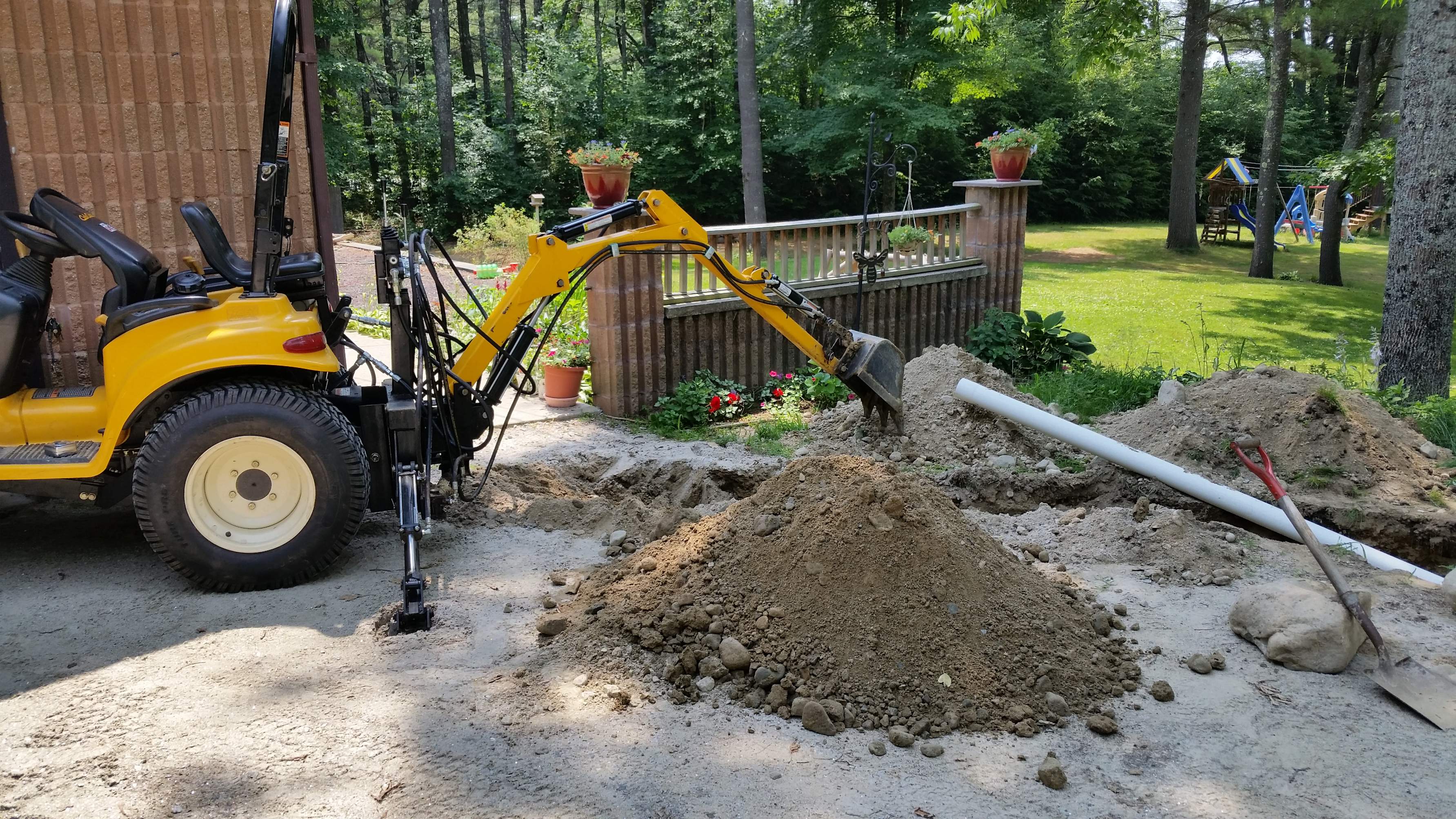

It is 96" in total. If I move the rear pivot point in the top arm I could get a lot more. But I'm kind of burned out on building this thing so I'm happy to just use it as is. Here is a project I finished today to run my rain gutter underground. Just need to dress up the yard and cut the drain line of and put a grate on the end. 20140713_124130.jpg20140713_124144.jpg20140713_124229.jpg20140713_144140.jpg20140713_144200.jpg
