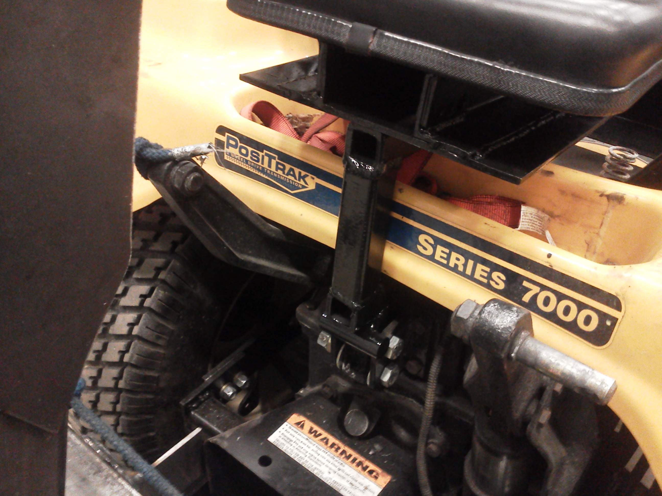

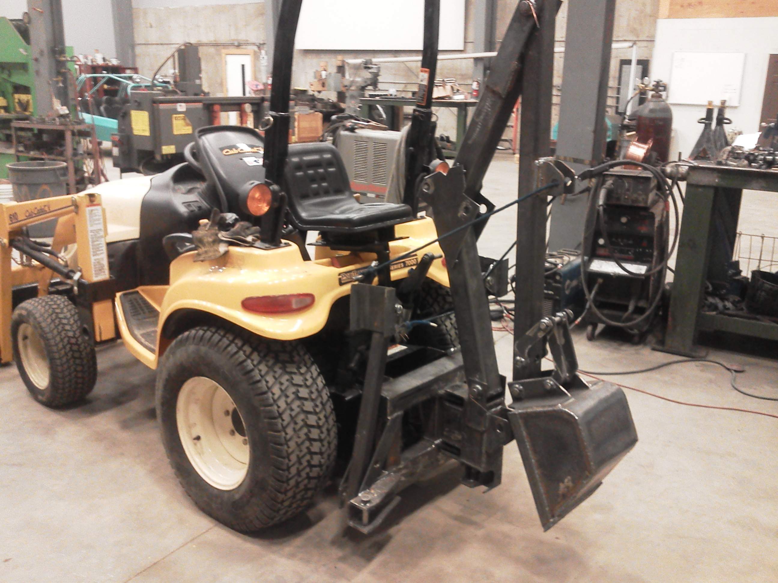

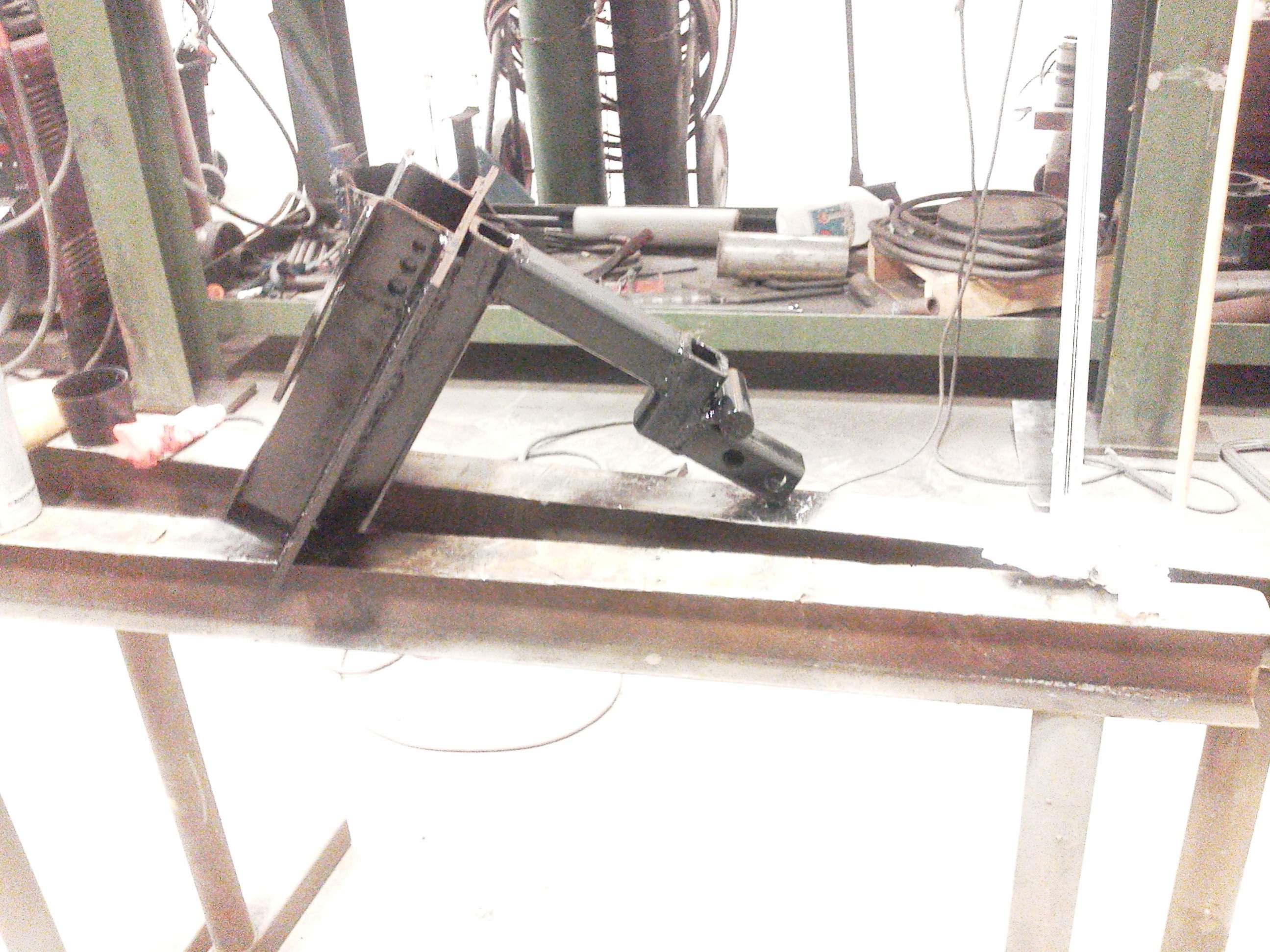

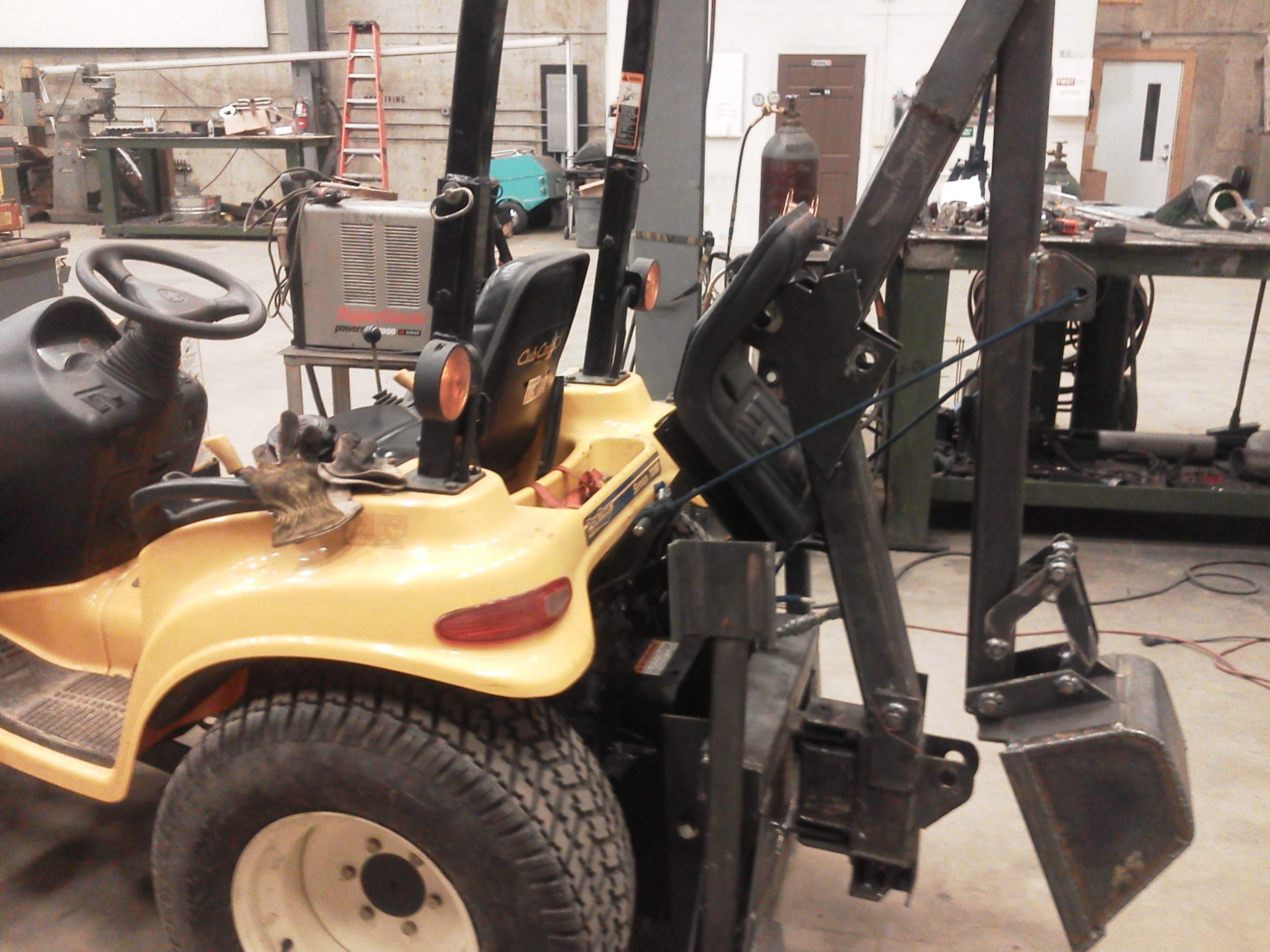

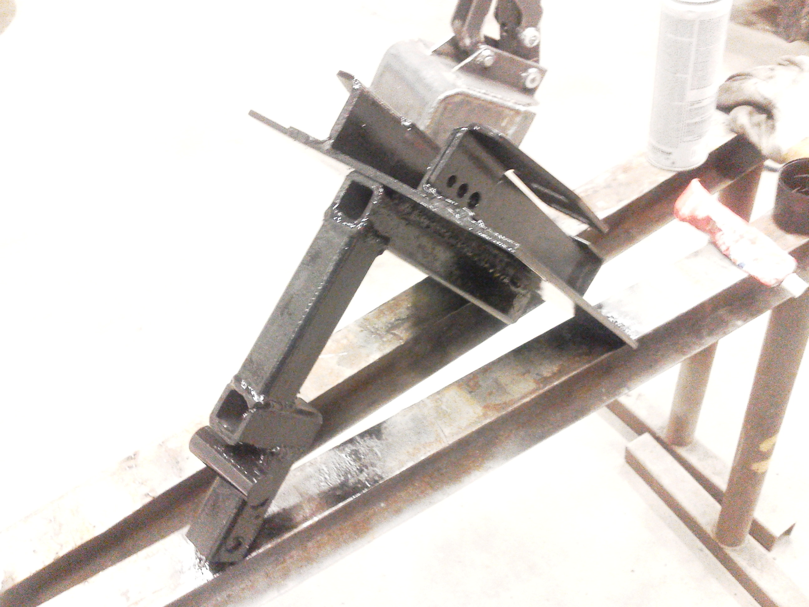

I've been building a small backhoe for my tractor that I thought people might be interested in. People have certainly built this backhoe before. But I just wanted to say that the CAD plans that I purchased from P.F. Engineering are amazing. And the gentleman that made the plans who's name is Paul has been extremely helpful with suggestions and tips for building it. All of the previous build is in my thread "New (to me) 7264 Owner". I'm not sure how to move the portion of the build from that thread to a new one in the Build-It Yourself section. I think I'm going to post the remainder of the build pictures as I go here though. I just made a place for myself to sit. I am going to be using the spot where the top link for the 3 pt would normally be mounted. If I pull the top pin the seat tilts forward so I can drive the tractor like normal. Seat picture #1.jpgSeat picture #2.jpgSeat picture #3.jpgSeat picture #4.jpgSeat picture #5.jpg
