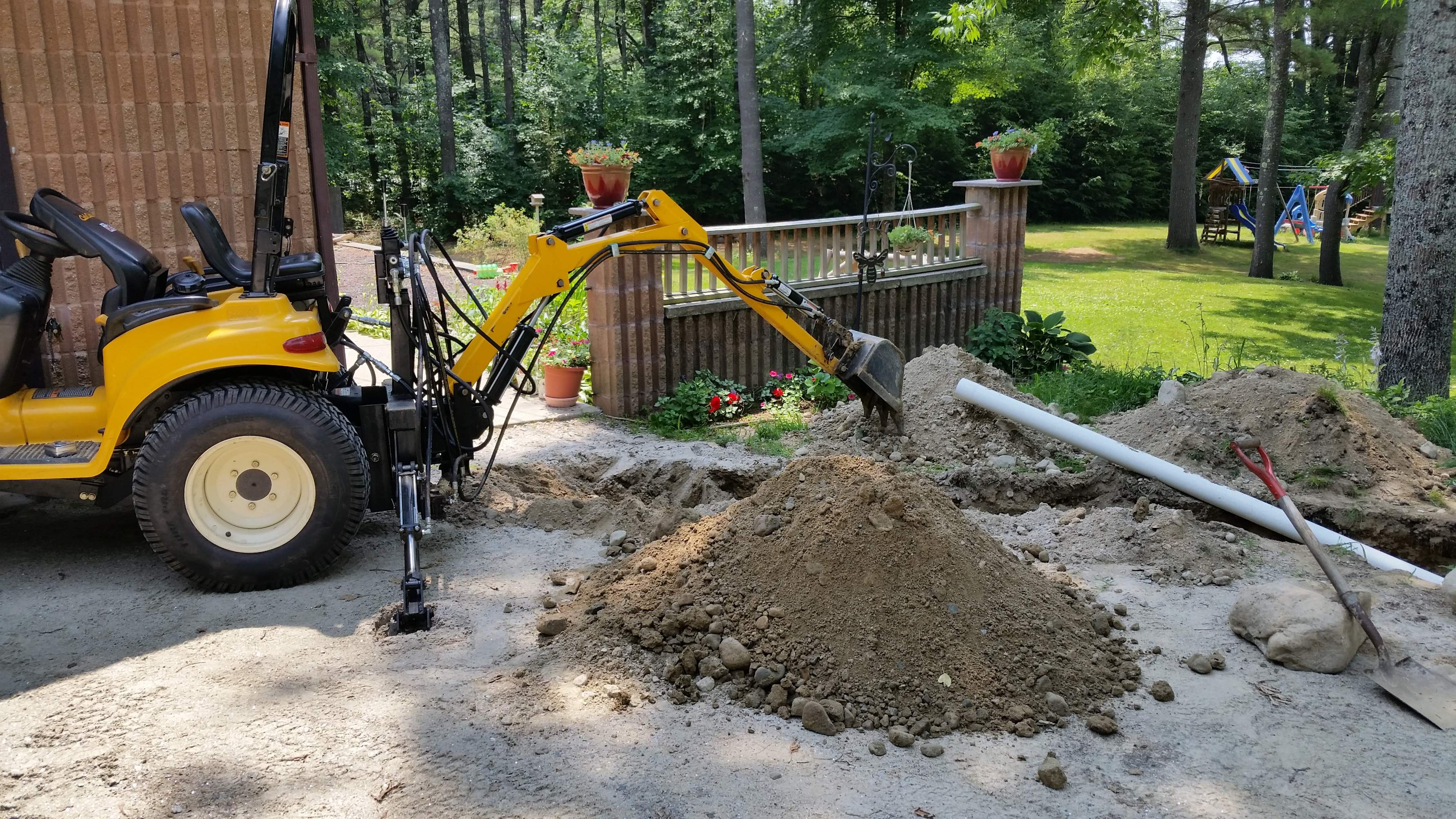

2014-07-03_17.15.11.jpg2014-07-03_17.15.00.jpg2014-07-03_17.14.51.jpg2014-07-03_17.14.41.jpg

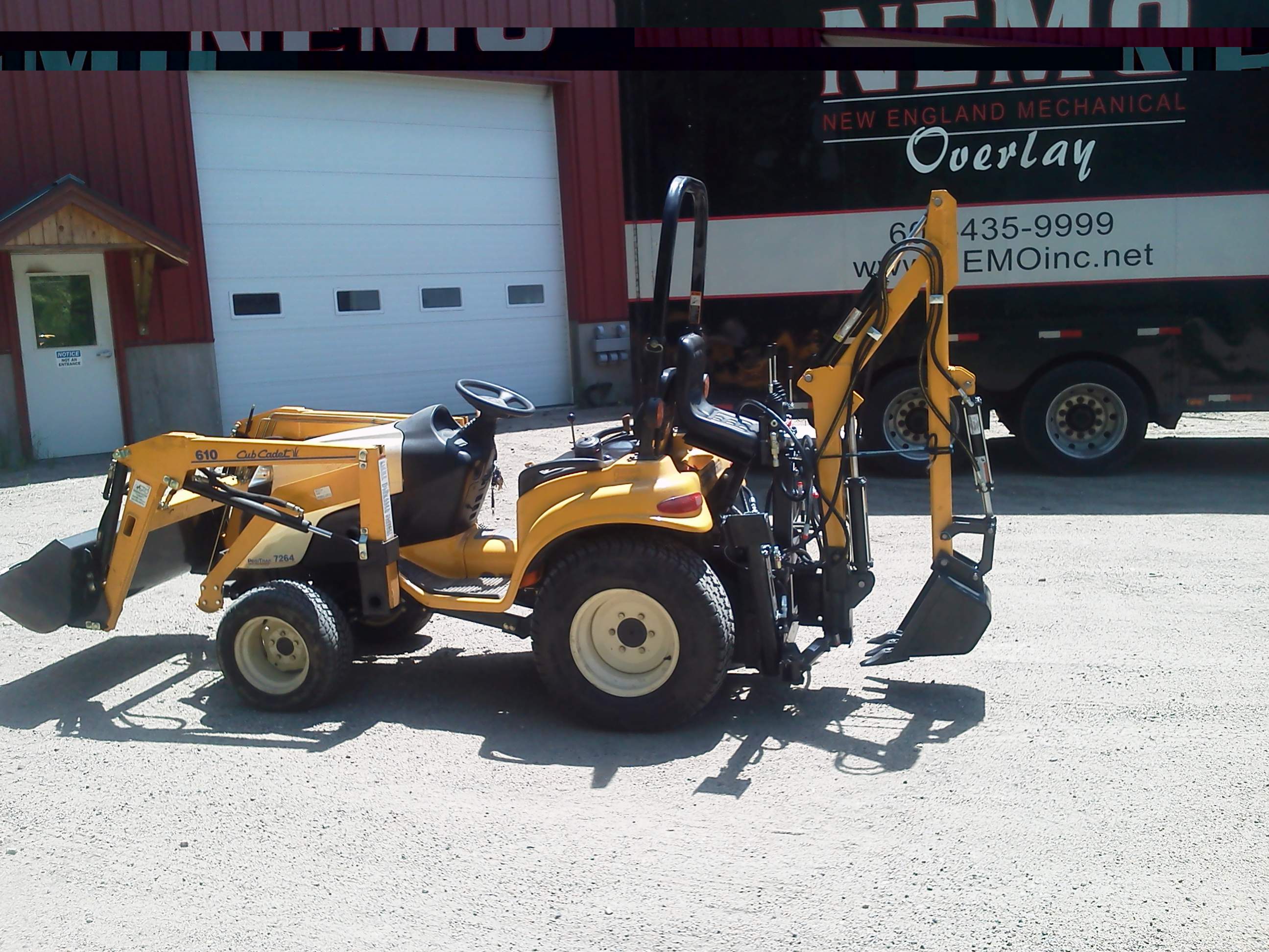

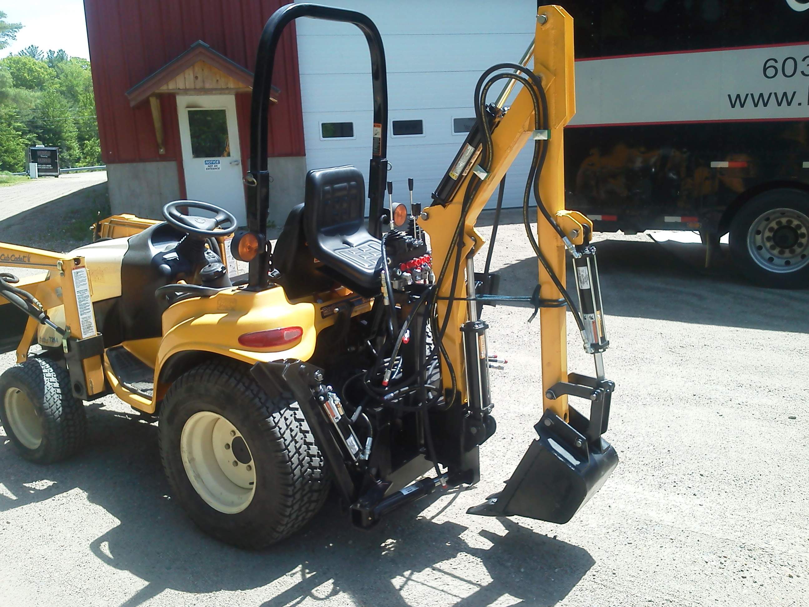

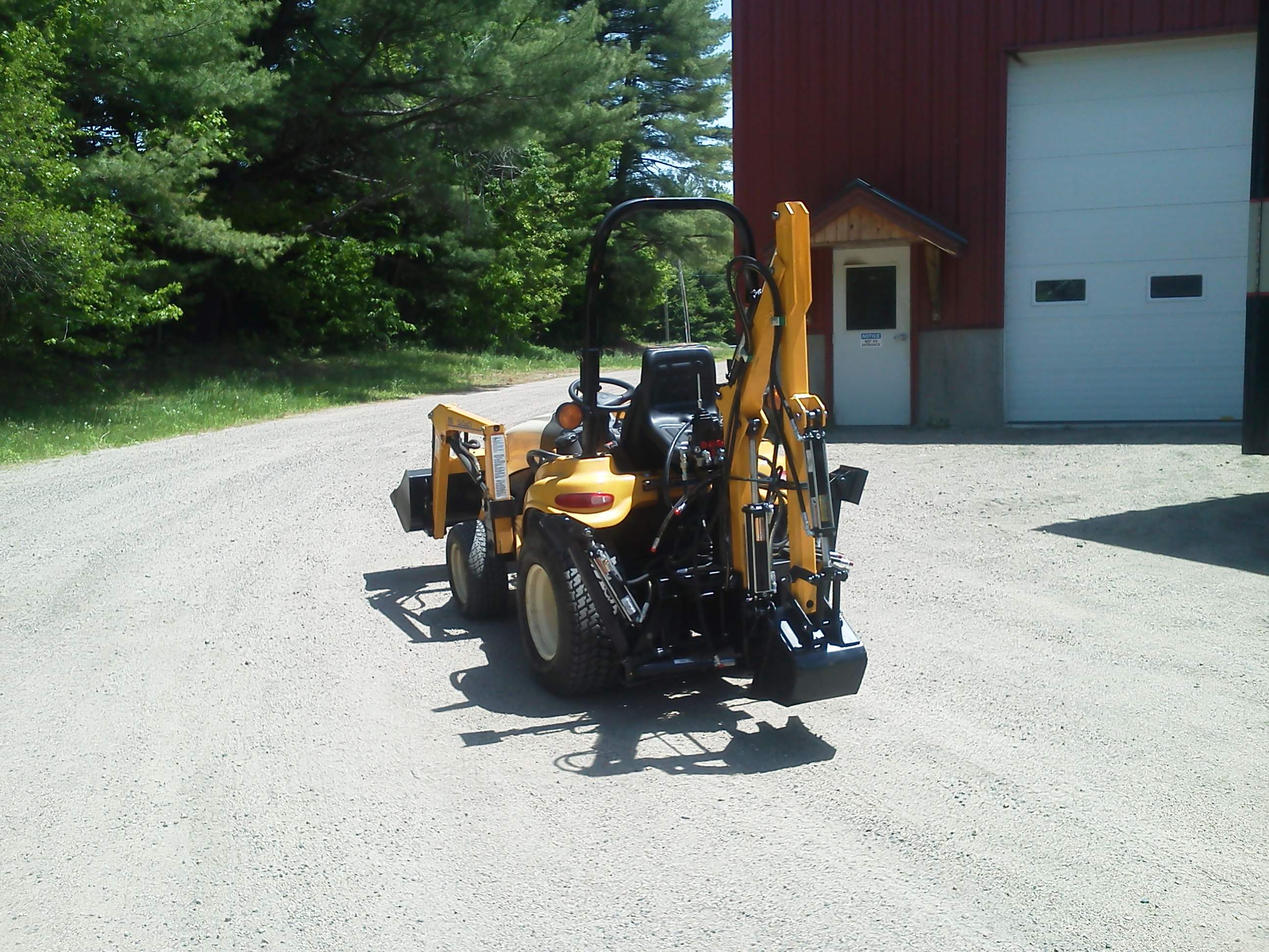

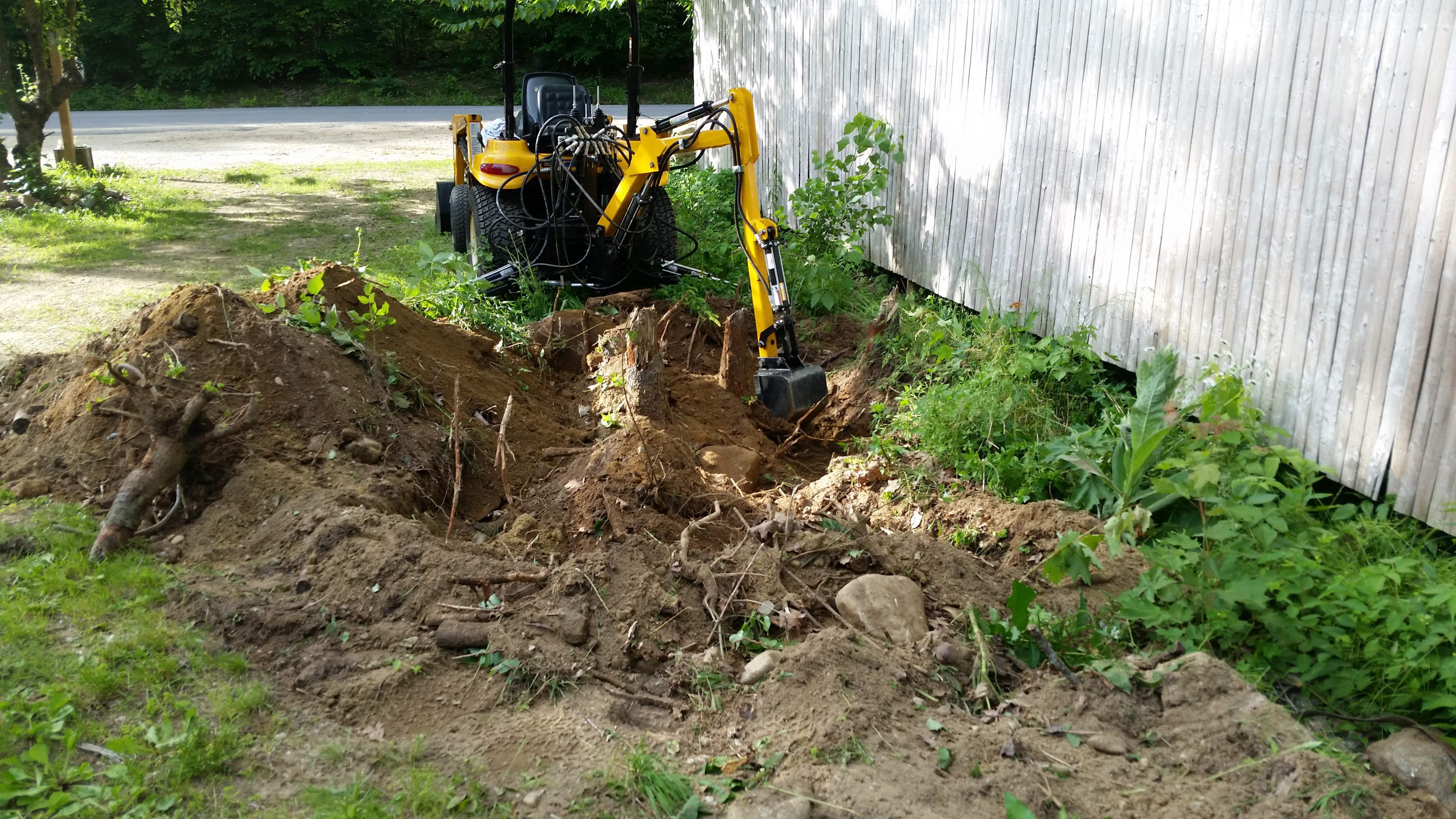

Just a quick update, I've dug approximately 25' of trench approx. 3' deep in very rocky N.H. soil, dug around four 6" diameter maples and pulled the stumps with my truck. The backhoe is sized very well to my tractor. If there was more power in the backhoe I think I would use less finesse and break some things. I put a pressure gauge on the inlet side of the valve and I set the hoe to 1500 psi. Max pressure per Cub's recommendations of max psi for the hydraulic system of the tractor. I'm happy with the height I manufactured my seat at, and would suggest spending some time thinking about that.. that's why I decided on a second seat rather than swiveling the existing seat around. I'll update when I attempt the larger trench. Oh, also at 1500 psi the 2" cylinders with 1.125" bore will not lift my tractor off of the ground. (My tires are loaded with windshield washer fluid) but it is plenty to take almost all of the weight off of the axle and transfer the forces to the frame.

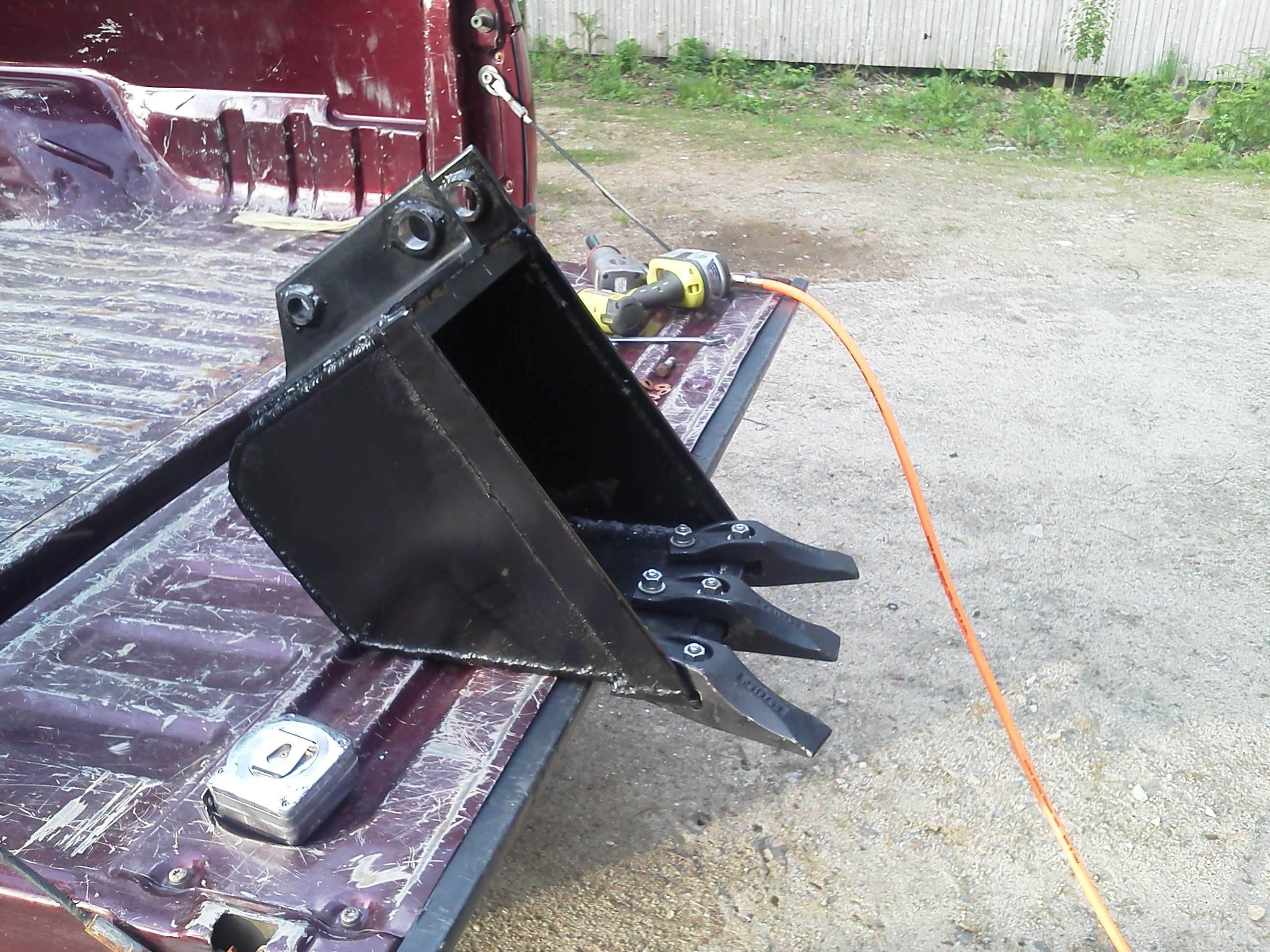

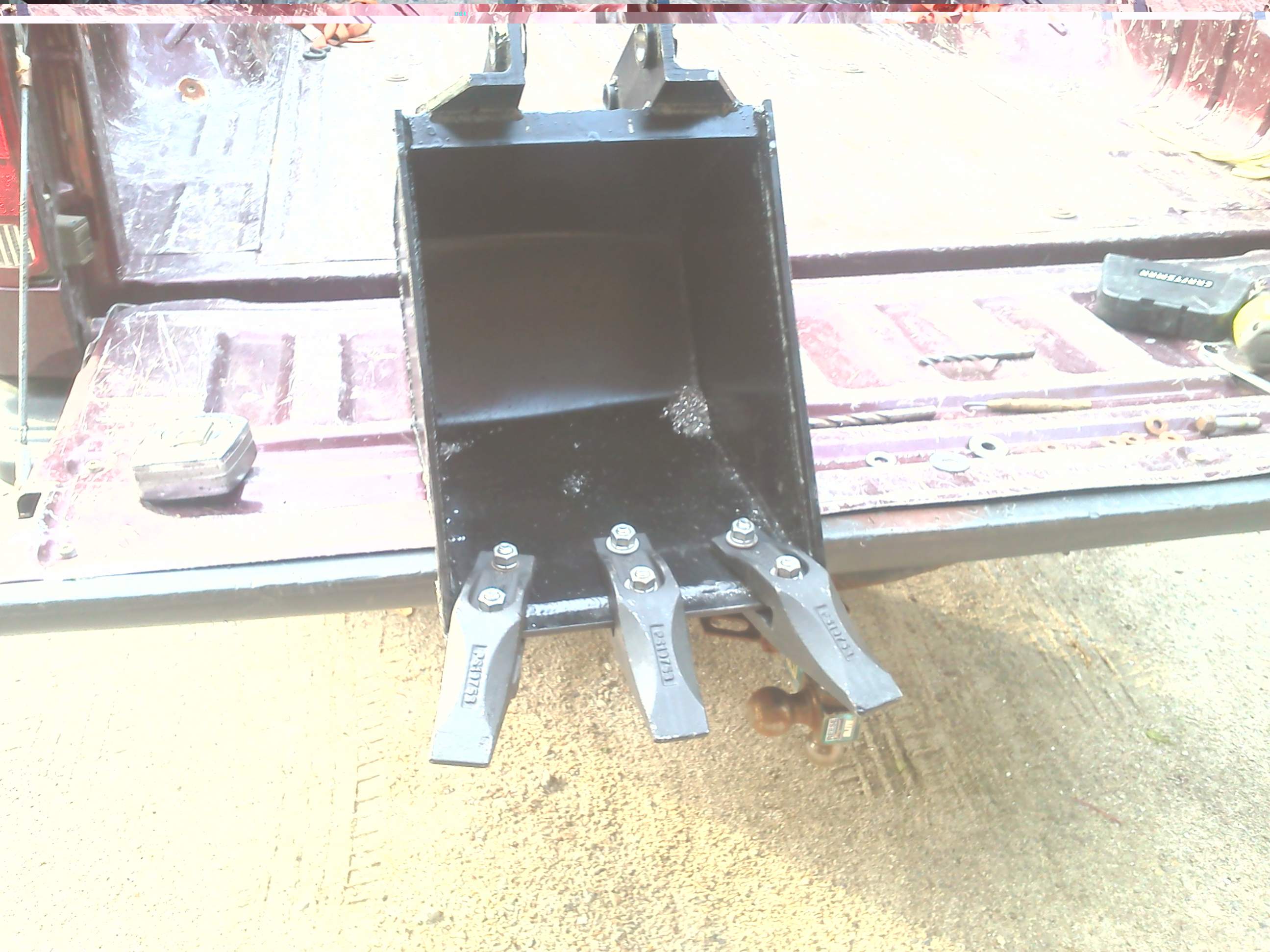

how bout some more info on those bucket teeth...where did ya get em and how much?
/ Building a Small Backhoe
#26
ooooo. good question. That was the hardest part for me to find at a good price. I don't know anything about bucket teeth so sizing etc. was a shot in the dark. I went with a bolt on type, I could have gone either way, they are sized pretty decent to the 12" bucket I made I think. I ended up buying the
Hensley 099-HX Bolt-On Tooth. Part#:pS1975B Price:$9.78.
I can't remember how much shipping was but they came within the work week from http://augerteethonline.com/
I was pretty proud of that find, I spent a while on the inter web and I can usually find things fairly quickly but teeth that weren't 20-30$ a pop proved hard for me.

#31
It is 96" in total. If I move the rear pivot point in the top arm I could get a lot more. But I'm kind of burned out on building this thing so I'm happy to just use it as is. Here is a project I finished today to run my rain gutter underground. Just need to dress up the yard and cut the drain line of and put a grate on the end.20140713_124130.jpg20140713_124144.jpg20140713_124229.jpg20140713_144140.jpg20140713_144200.jpg
