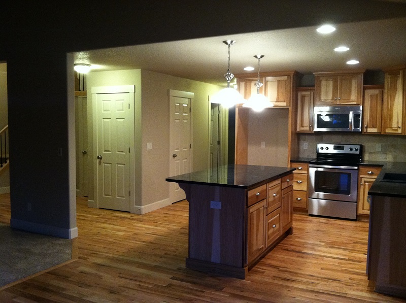

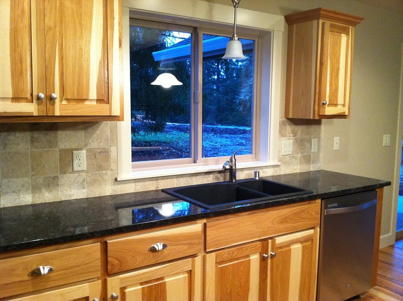

Here's an idea, take a look at these two pics. This trim is in a 'craftsman' style not much different that what you are doing with two exceptions. The rails (trim) along the top of the doors and windows are thicker than the stiles and overlap the stiles about 3/8 inch on each side. The different thicknesses give it some depth and both the thickness difference and overlapping is a lot more forgiving vs trying to cut things super accurate.
Excellent concept for this type of trim and many other "finish" applications unless you are doing it yourself and willing to devote extra time. Keep all of those edges apart. :thumbsup:
