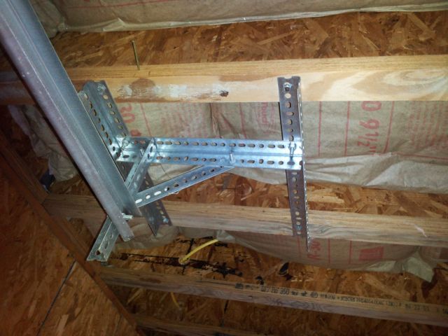

I think I can picture it.
There would be two lengths of angle iron, both parallel to the door rail. They would be bolted to the two trusses that bracket the end of the door rail. One of those angle irons would be directly above the rail, the second one would be offset outside the door rail by the length of the base of the triangle.
The vertical angle irons carrying the door rail would be attached--one to each ceiling bolted angle irons. The ceiling provides the third leg of that triangle.
you could save a piece by lining them up better, but this is how I normally see it done.

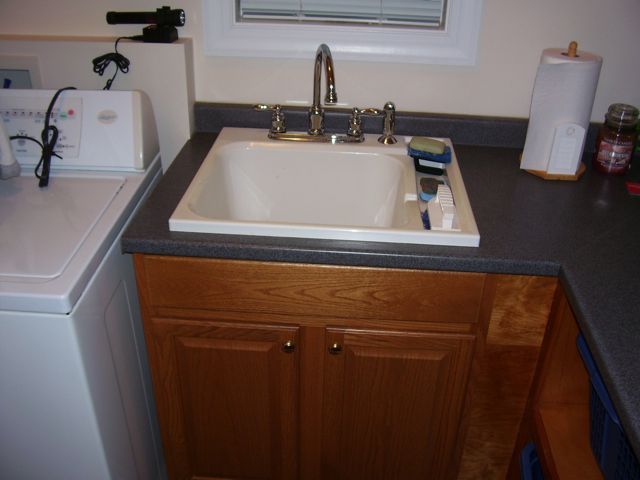

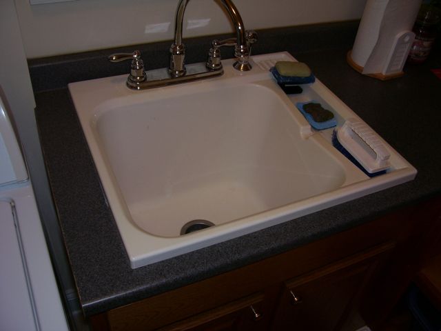

Here are two pics of our sink in the laundry room. A 14 x 14 BAR sink is useless for a mud room!

Took some pics this morning of the mudroom and bath sink issues.
Bar sink in mud room
The faucet is way too big for it I think
This is the sink that was supposed to go here. It will fit in the cabinet fine, but the front edge of the granite would be too thin
The real fix would have been to make the granite counter top wider in the first place. There is plenty of room to have done that and the washer and dryer will come out further anyway. I'll see what mom has to say. They will likely need to go back and redo this after final.

While the garage door track won't move they way they did it, it looks terrible. They should have spanned the two nearest trusses with angle iron ran parallel to the track, then put the cross angle iron between those two, directly above the hole at the end of the track, then hang straight down.

Buckeyefarmer,
Thanks for posting your picture last night.
My error, I was reading just the first part of your sentence which sounded like only one piece running parallel above the rail.
Your way is fine on an open ceiling.
I would probably still do it the other way as a fix to Peters hangers. To span the trusses and have holes
in the center of his 1-1/2" width trusses he would need 4 new lengths at least 25-1/2" or more of the angle, depending on whether the trusses are set right or not.
With plasterboard under the screws and the head of the bolt holding the down brackets on the ceiling side of the angle, the head would either hold the piece
in a sway with the ceiling or cut into the PB. In either case, if the nut ever needed tightening the piece would have to come down to get a wrench on it.
The way his is attached to the ceiling now, at least the angle against the ceiling has full support from the truss above it.

I really don't think that bar sink is going to cut it as a util room sink. If they need to re-do the granite to fit the right sink, then make them.
you can live without the util sink for a few weeks while they make it right.
