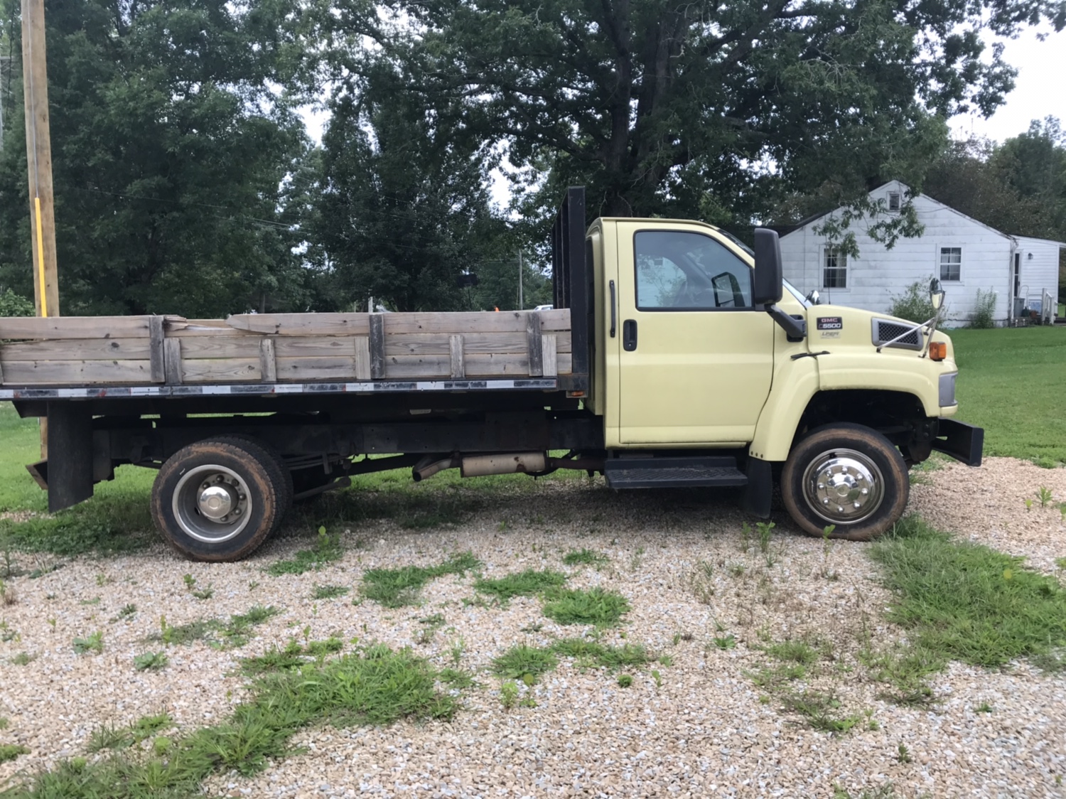

I wouldn稚 want a dump trailer of that capacity anyway. A medium duty truck would be a lot more useful IMO. Here痴 a truck I was looking at buying to add to my collection of 2 gravel bed dumps. It痴 a 14 flat dump. The 5500 is quite a bit lighter than my 6500 dump truck but I would say it would still handle 7-8 tons.View attachment 666843
Nice, but not an option. Already have dump truck.
I don’t want any more trucks. Already have too many engines, transmissions, axles, inspections, registrations, etc.
Trailers are much simpler and cheaper for me at this point. If my RAM can handle a 35,000lb trailer of hay, it will handle a much smaller dump trailer.
