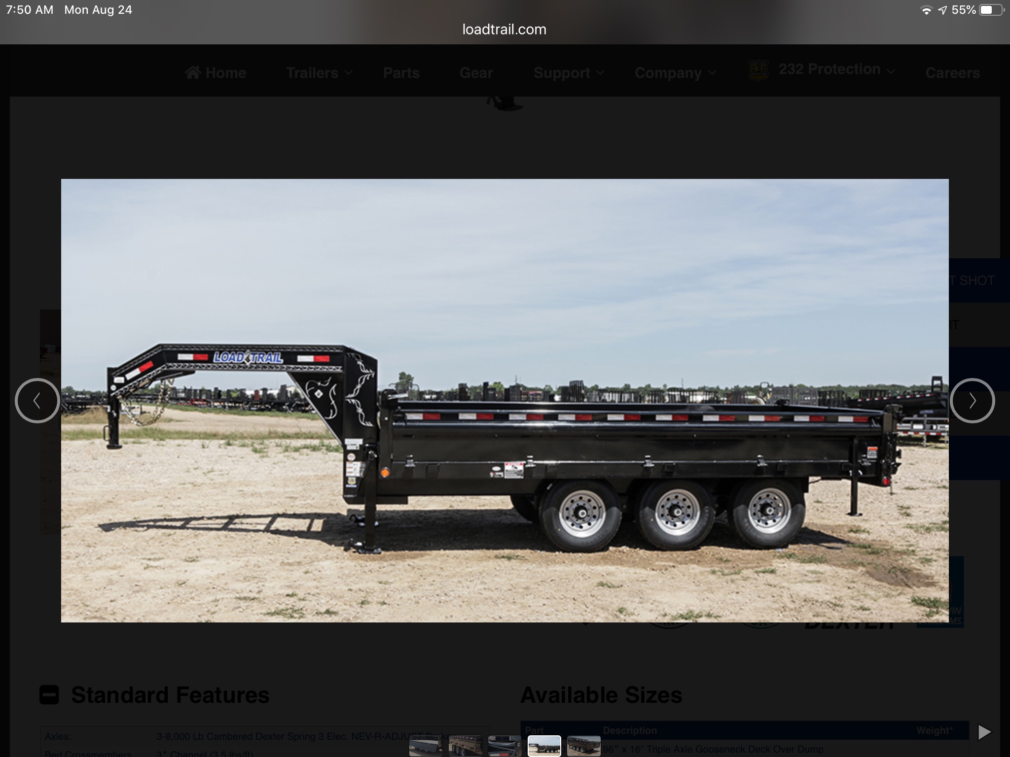

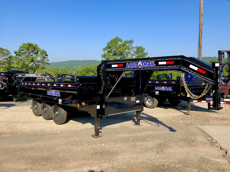

I just may go ahead with the Load Trail GZ21 with a few options. 3 8k oil baths and 8’ ramps.
Now I have to get a few dealer bids.
