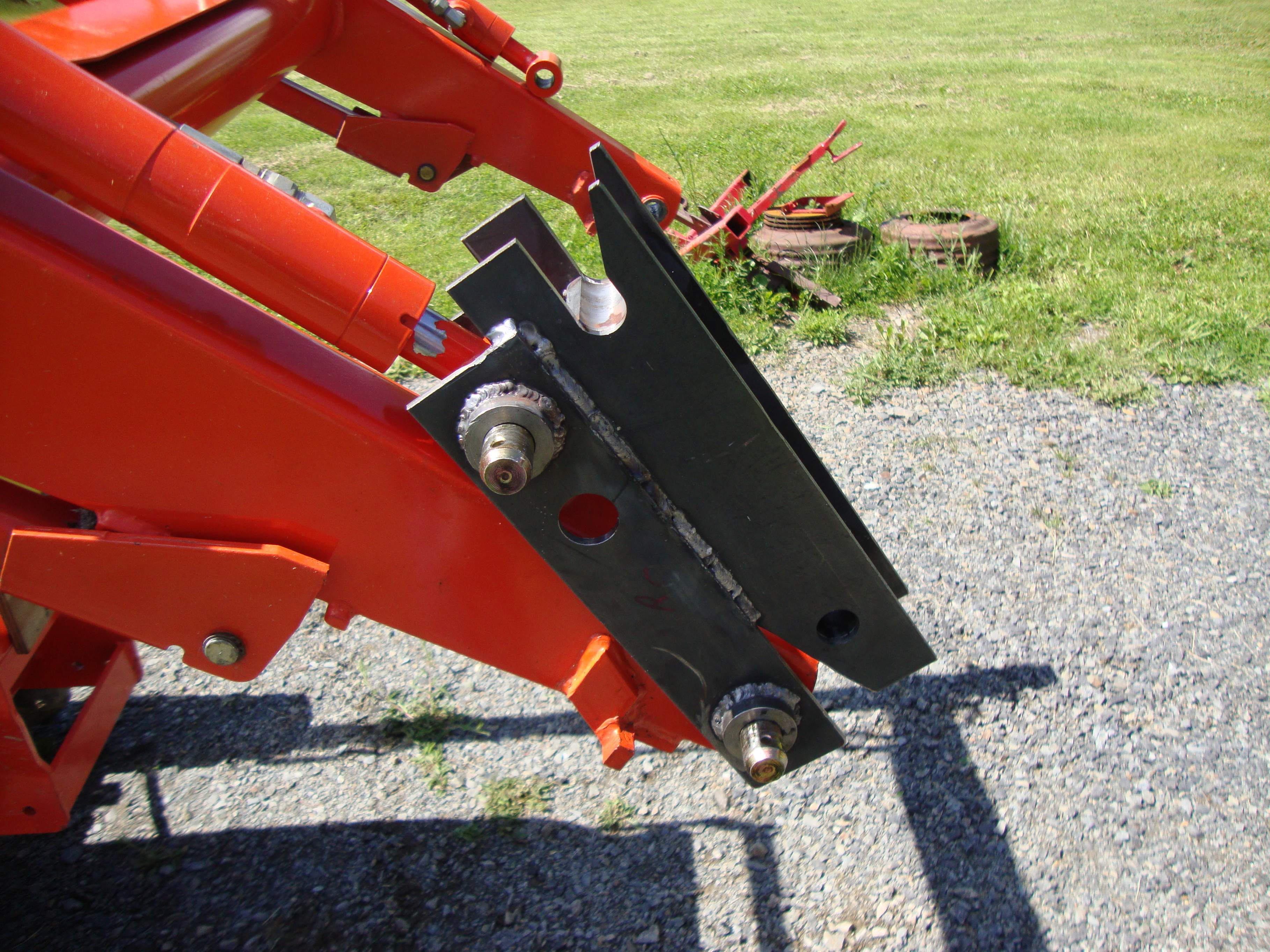

A little more progress in the past week. I have other irons in the fire at the moment, so this is turning into a long term project.
I used a 1/16" shim between the loader side plates and the bucket part of the adapter, to give me enough clearance for everything to move freely. One of the other guys used washers, I think. Either will work, I was worried about distorting the plates and wanted as much surface contact as I could get. The small half-moon cutouts to give clearance for the cross bar weren't entirely necessary after all. I had to move the front half of the adapter further forward to allow room for the weld between the ears of the bucket and the back half of the adapter. If I hadn't, I would have had to either grind the weld back or trim the back of the bucket ears. Neither appealed to me.
I welded alternate sides of the plates in 1 to 2 inch stitches to keep from putting too much heat into the steel. As it was, each time I welded one side the pins would bind hard, only to loosen again once I welded the other side! This continued until the final weld was done.. One pin binds slightly now, but nothing I can't easily fix. The right side is finished except for stiffeners and bracing.

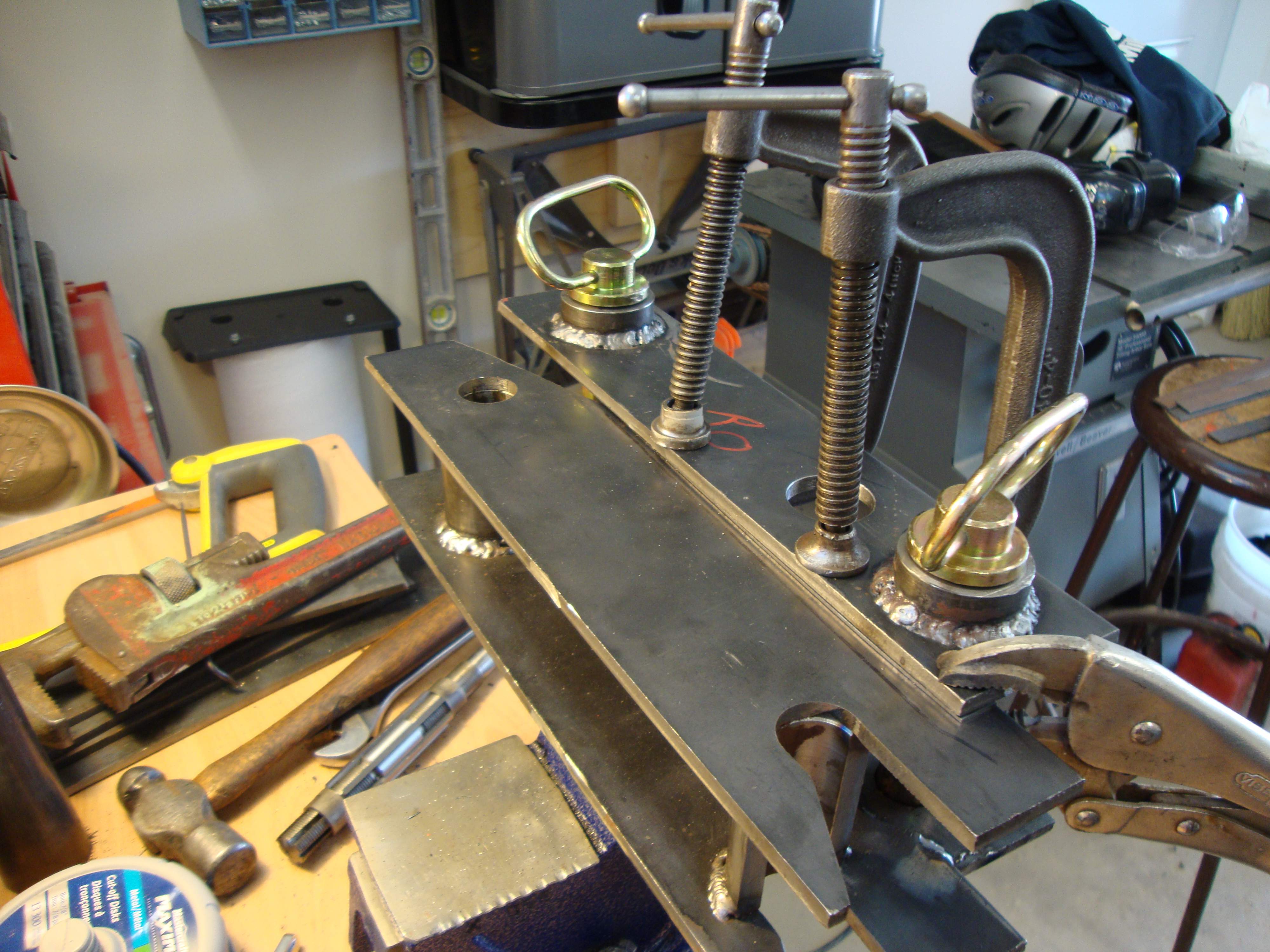

With the first side plate welded in place, I slid the pins in place to locate the second side plate and clamped everything up as tightly as I could for welding. You can see the shim in place in this picture under the side plate. The plates did bow slightly from the heat, but not enough to cause real problems. I hope.

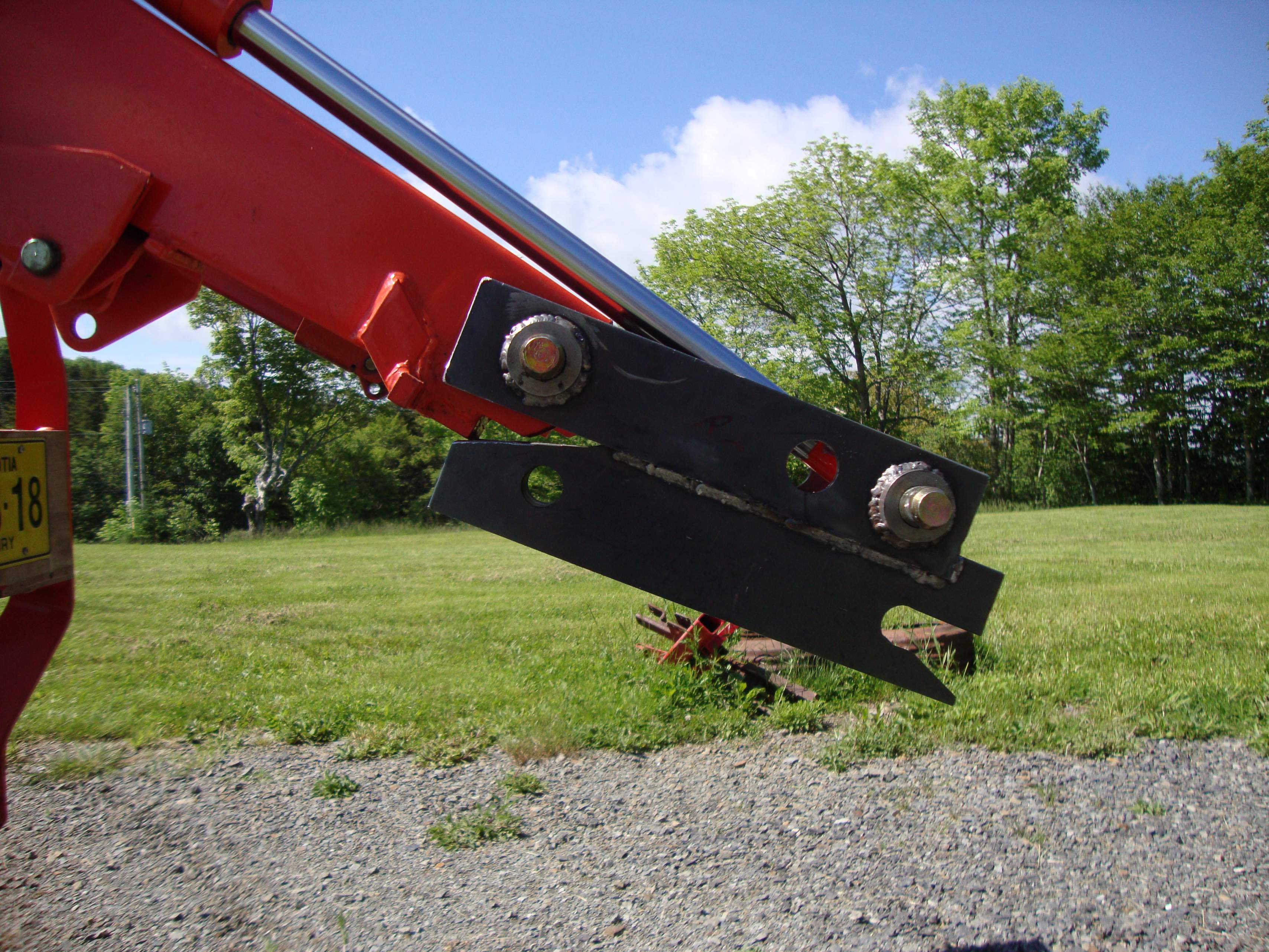

Fully dumped position. I need to weld in some stops to protect the cylinder rod, I may wait until I have the bucket attached to be sure where to put them.
Fully curled position.

Looking good! :thumbsup:
I am not sure where you could put a stop that would take the full extend pressure without bending something.

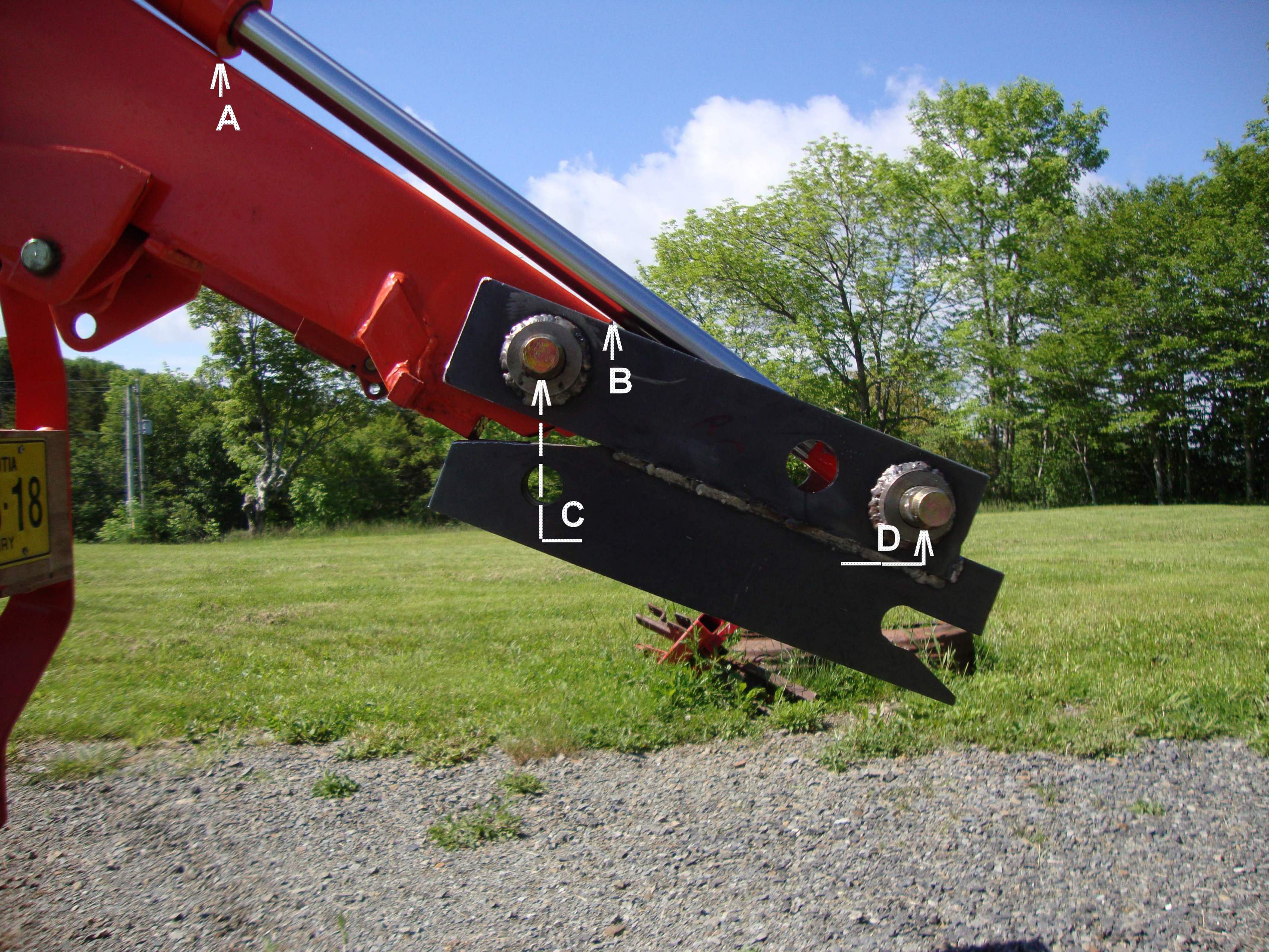

If the cylinder touches the arm at point A, it could bend the rod. Right click this picture to open in new tab.
I would measure the clearance at point B, remove the adapter, put the bucket back on, fully dump, and measure the clearance at point B on each side. Then grind the end of the arm just under the rod to get the same clearance.
That is an area that won't weaken the arm.
I think your center to center distance from C to D is a little shorter than the holes in the bucket.

But most compact tractors are set up so the rod dont actually "fully" extend. Leaving a small bit of hydraulic oil for a cushion. Just incase dumping too fast with a heavy load, or dumping all the way and putting the bucket down to scrape, very easy to damage the cylinder without that cushion.
Look in the pic you edited. Just behind (to the left) of pin C you will see the mechanical stops for the old setup
Okay, that stop may be to keep the cylinder from touching point A and bending the rod.
